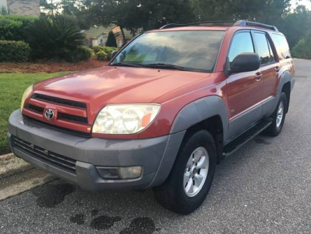

Here is how it sat at time it was bought:
Hey guys! Decided to actually make one of these. I almost got around to it with my old '99, however it was totaled back a couple of weeks ago.
This will mainly be a maintenance thread, with some build aspects.
Today, Saturday September 1st, 2018, I purchased a 2003 Toyota 4runner with right at 200k miles. Seller originally wanted $4,500 but I talked him down to $4000. The vehicle is in really good condition for the price. There are only a few issues known to me at the moment including a messed up rear bumper, roof rail covers are mostly missing or cracked, idler pulley needs replacing, and some carpet discoloration. The vehicle will also need some new tires soon.
Any questions, tips, tricks, or advice are encouraged and appreciated!
Here is how it sits currently:

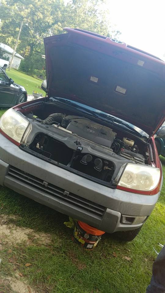

Drained, flushed, and filled the coolant system today.
Decided to go with the Zerex Asian formula 50/50 antifreeze. My nearest Toyota dealer is 45 minutes to an hour away so this was my best option.
I don't know if I'm just not mechanically inclined but the skid plate under the rad was a pain to remove, lol.
Next order of business will be engine oil drain and fill, same goes for ATF fluid. Then planning on seafoaming the truck as well as engine and cabin air filter changes.
