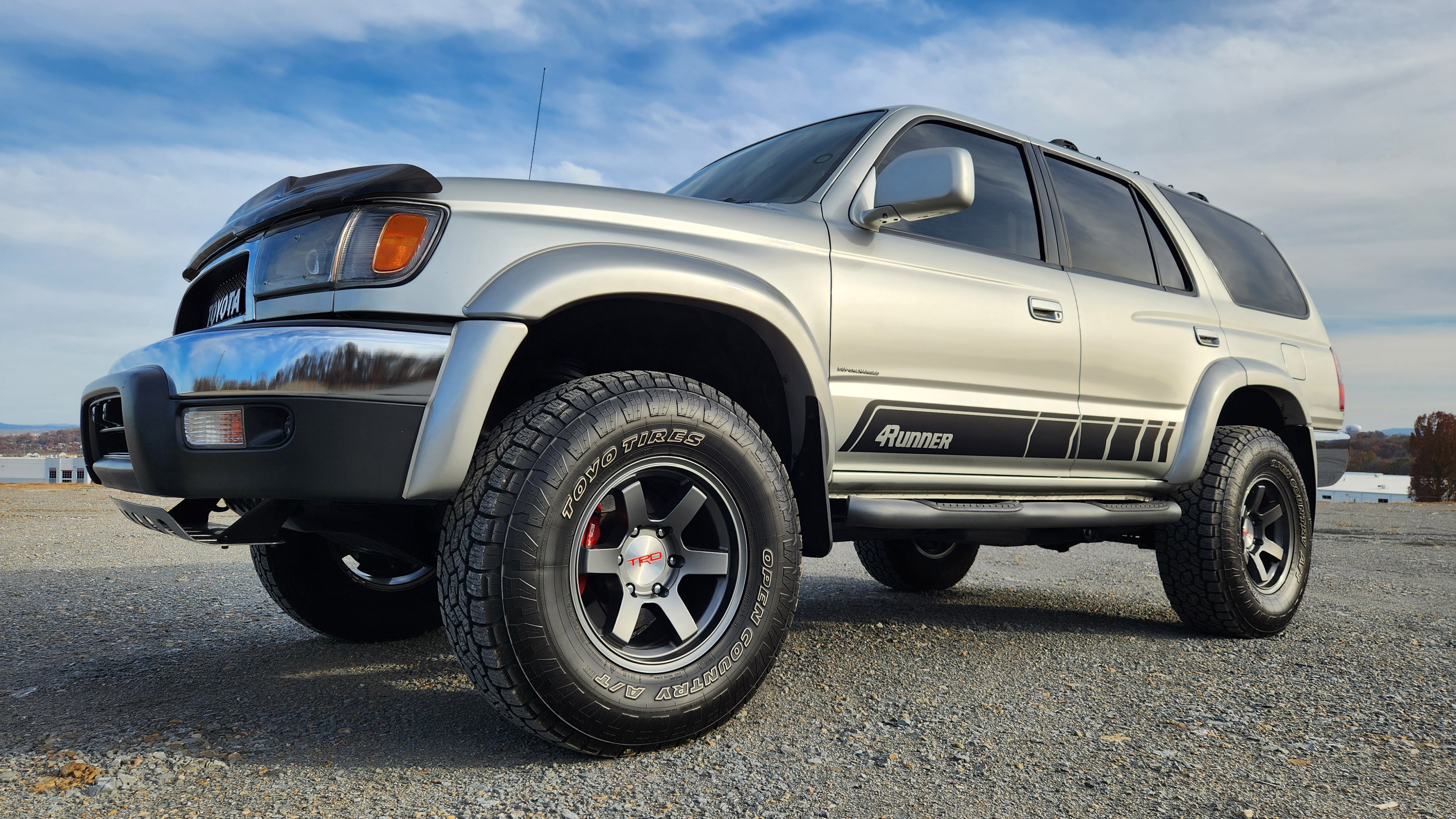

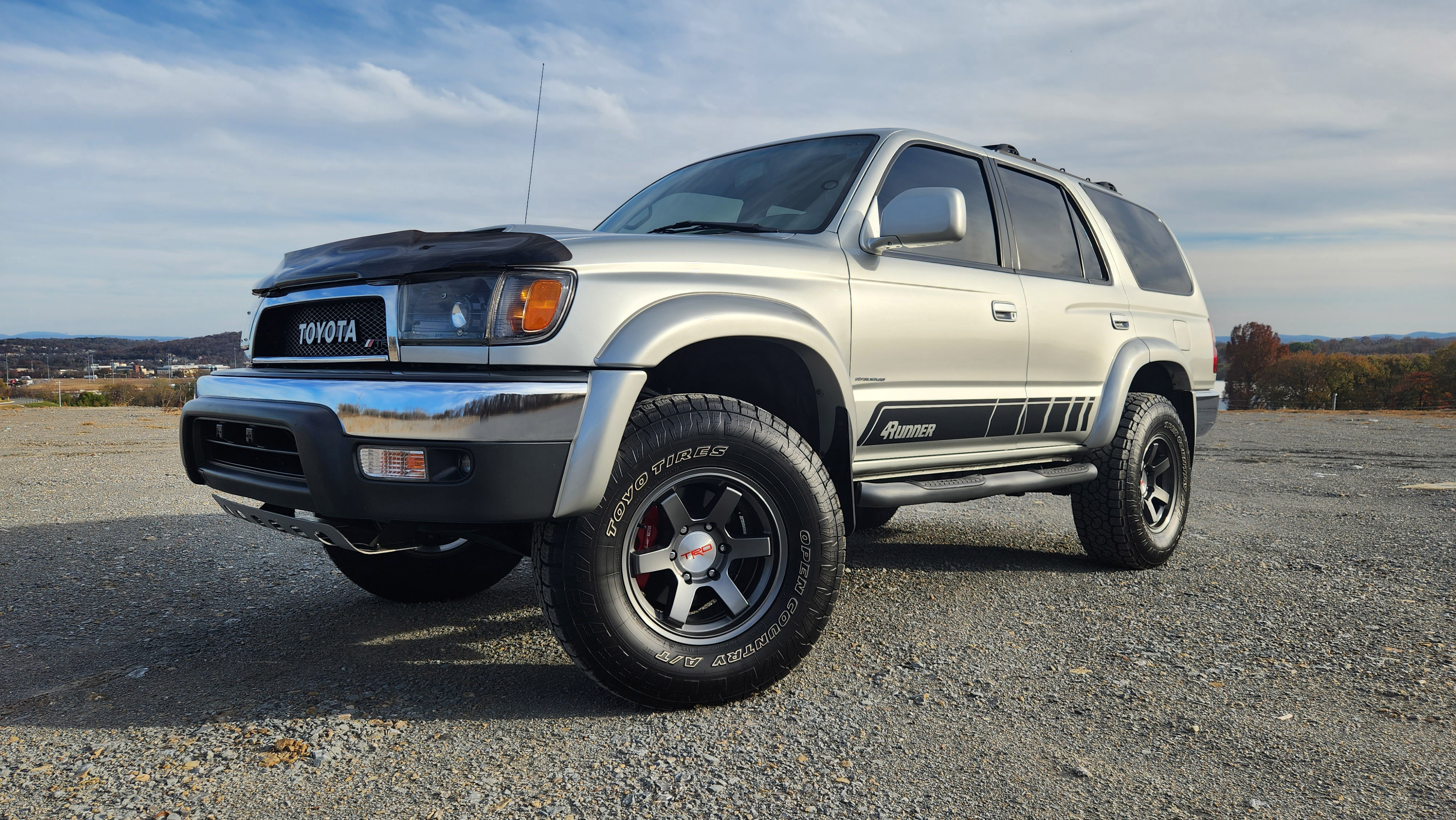

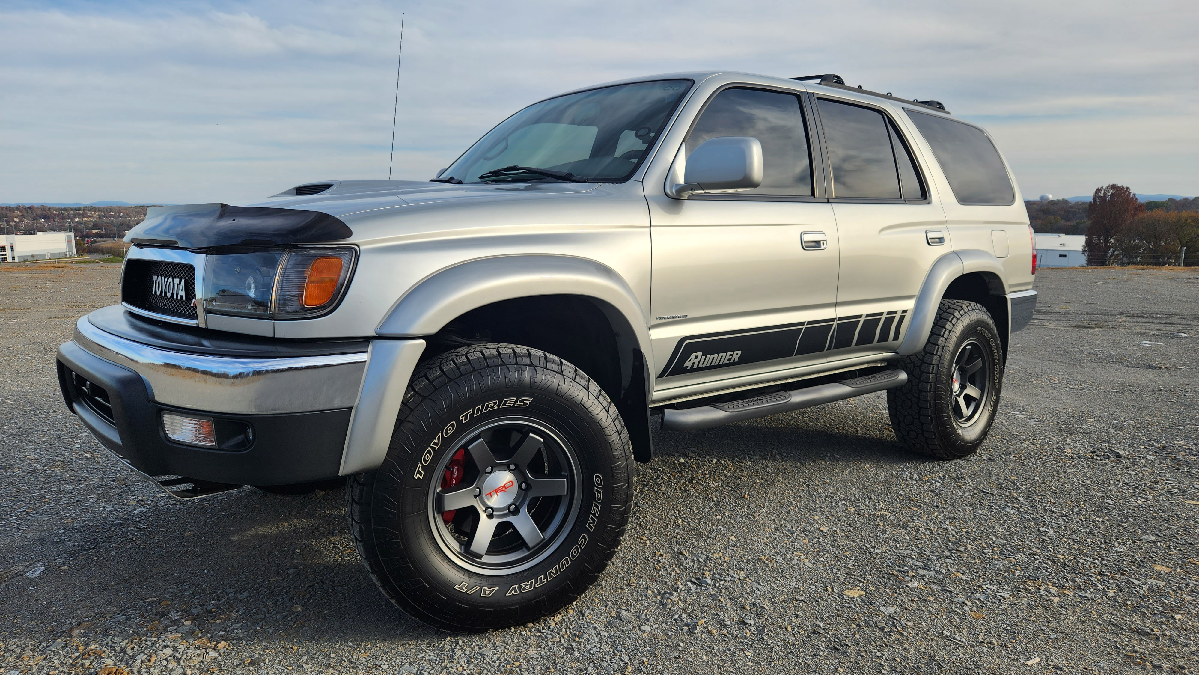

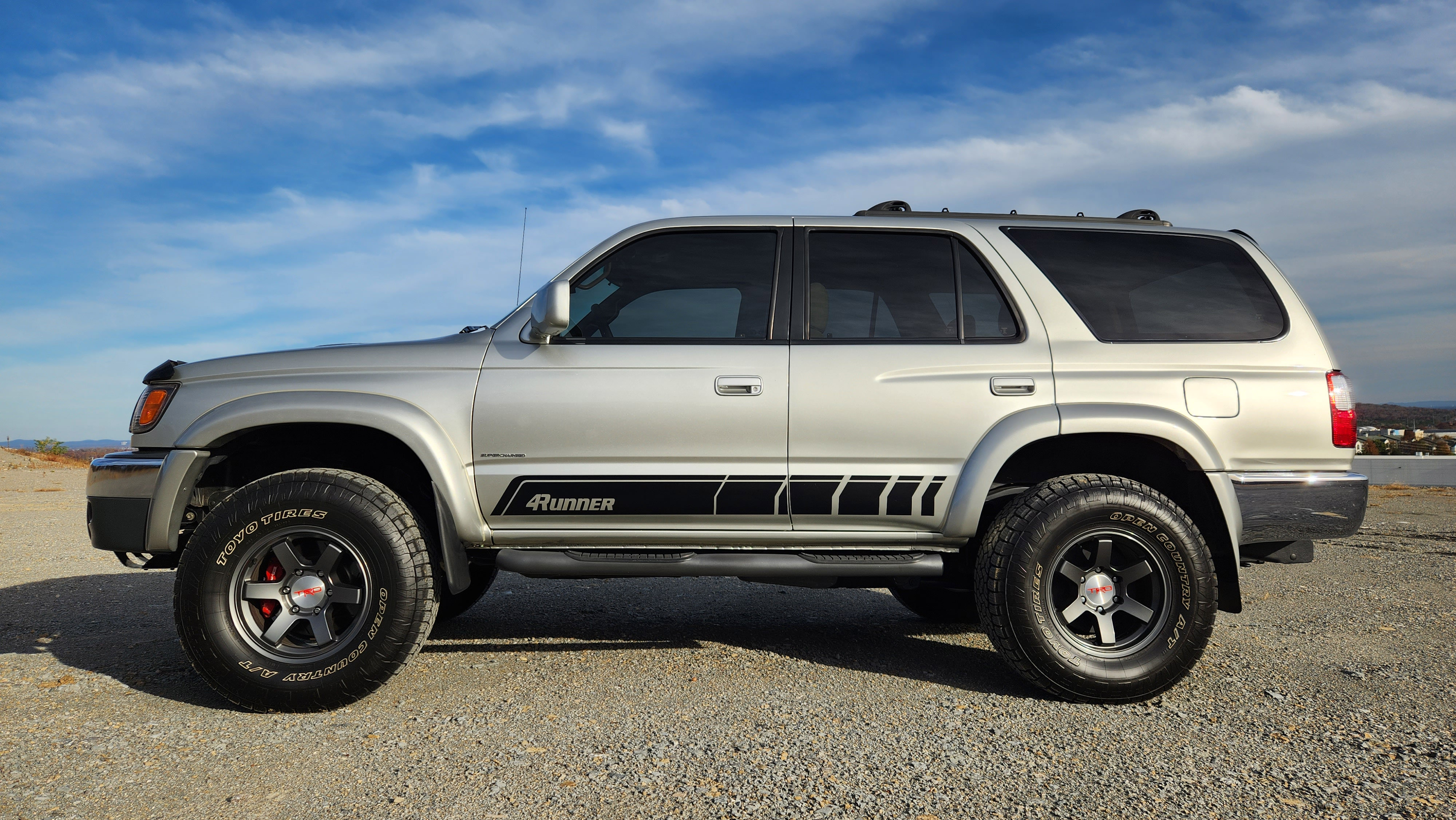

Almost a year to the day since I started this thread and the truck is basically finished. Everything's reassembled and it turned out awesome.

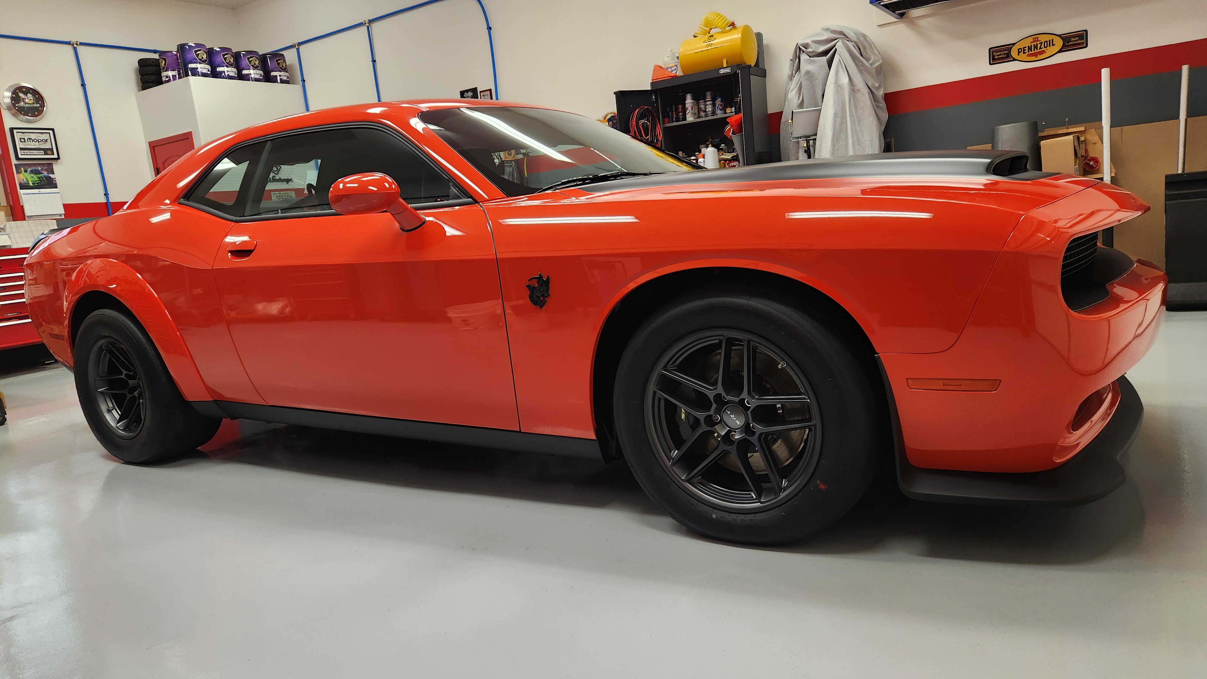

In other news.....here's the replacement for my stolen car. Showed up Tuesday.
Dodge Demon 170. 1025 horsepower right off the showroom floor. After my Hellcat was stolen I got a surprise call that made this happen. I feel humbled and blessed to get it, now I just need to get over the PTSD of mine being stolen and enjoy it.

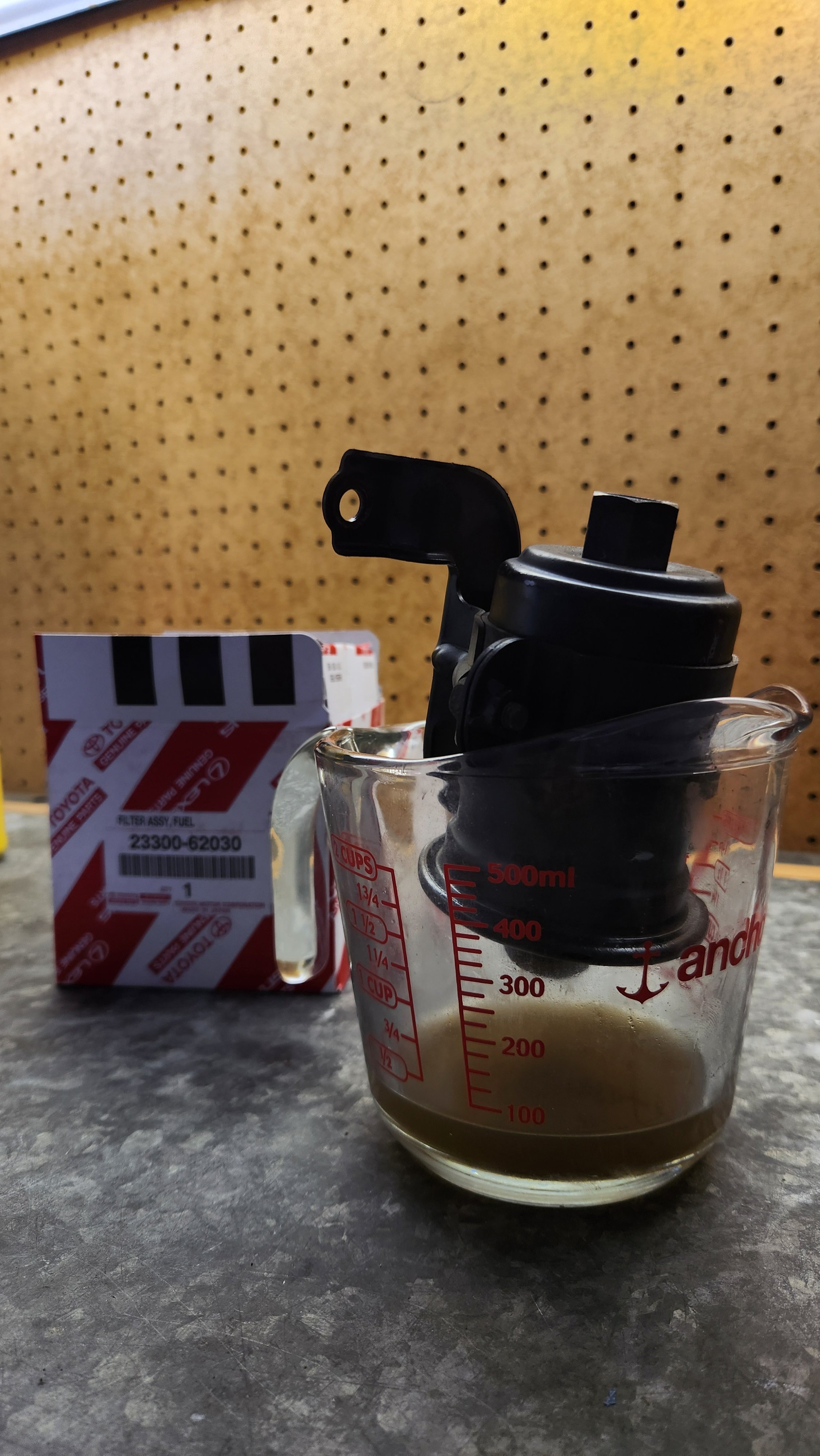

Finally changed that fuel filter. I didn't realize it'd been 20 years! Yuck.
