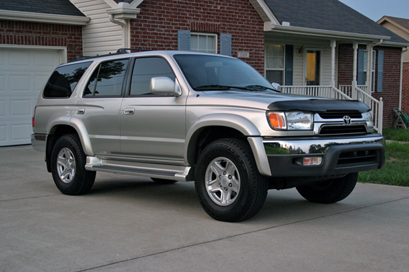

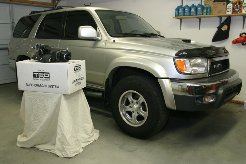

Bought a 2002 Xterra brand new. Nissan is local and through friends and family I got a huge discount. I wanted a 3rd gen 4Runner but couldn't really afford it at the time. I hated the Xterra and looked for a 3rd gen after a year of ownership. Found a low mile (10,000) used 2002 SR5 4WD 4Runner at a local dealer and traded the Xterra in on it. I couldn't believe this SR5 had leather. I loved it from the first drive. It was a Certified Toyota which came with a 100K mile bumper to bumper warranty if I remember correctly. Never had to use it though.
I've had it 20 years, so I'll try to remember all I've done.
How I got it in October 2003 with 10,248 miles
How it sits as of January 2024 with 158,246 miles

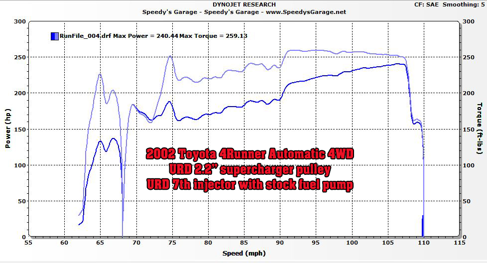

Performance
Detroit Truetrac installed in the rear
TRD Supercharger Stock Pulley, 2.2 Pulley, 2.1 Pulley
URD 7th Injector (only used way up in the boost range due to water/meth)
Kept stock fuel pump
Water/Meth Injection (highly recommended) custom mix using -20 washer fluid and HEET
Tuned by yours truly

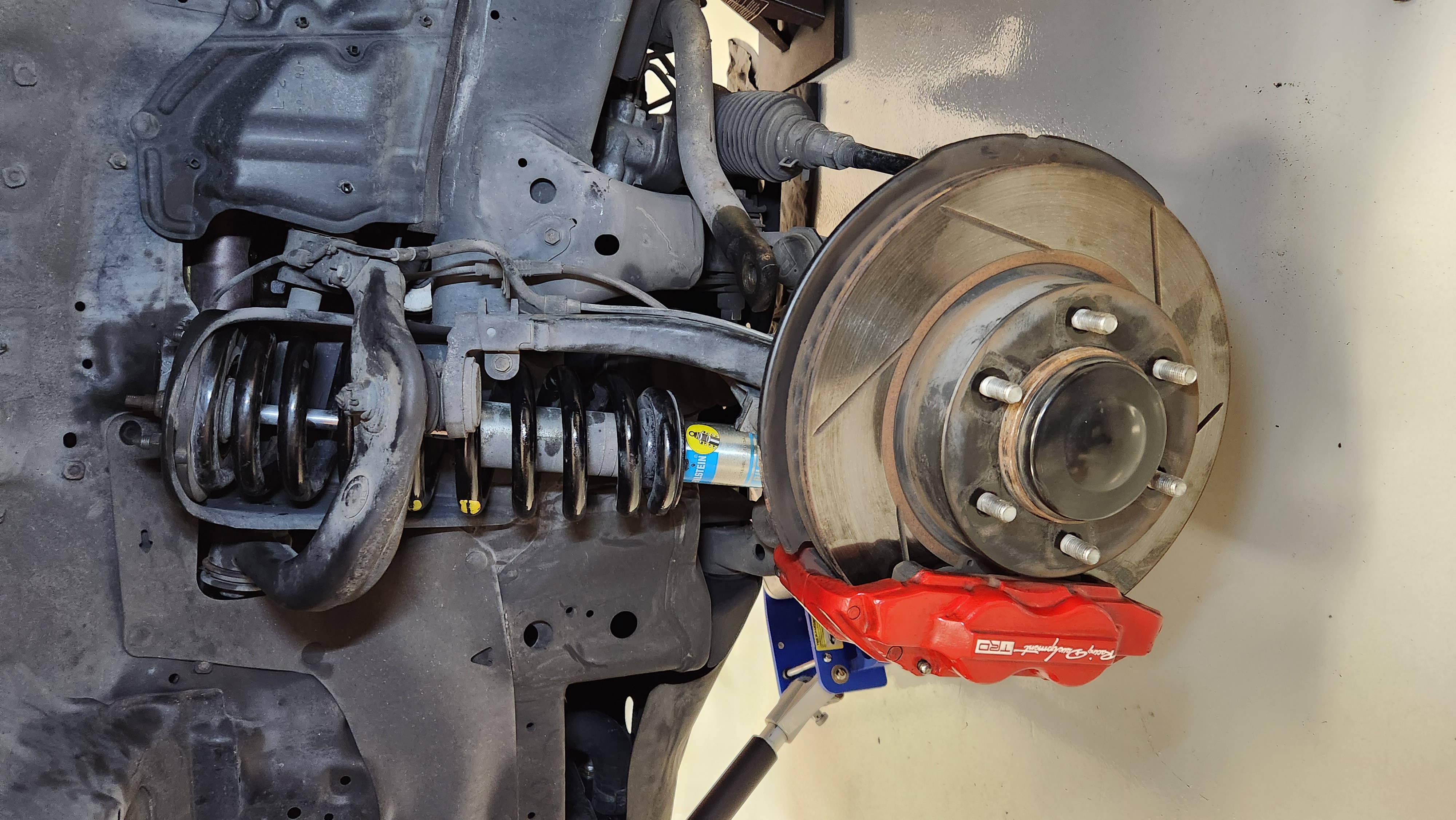

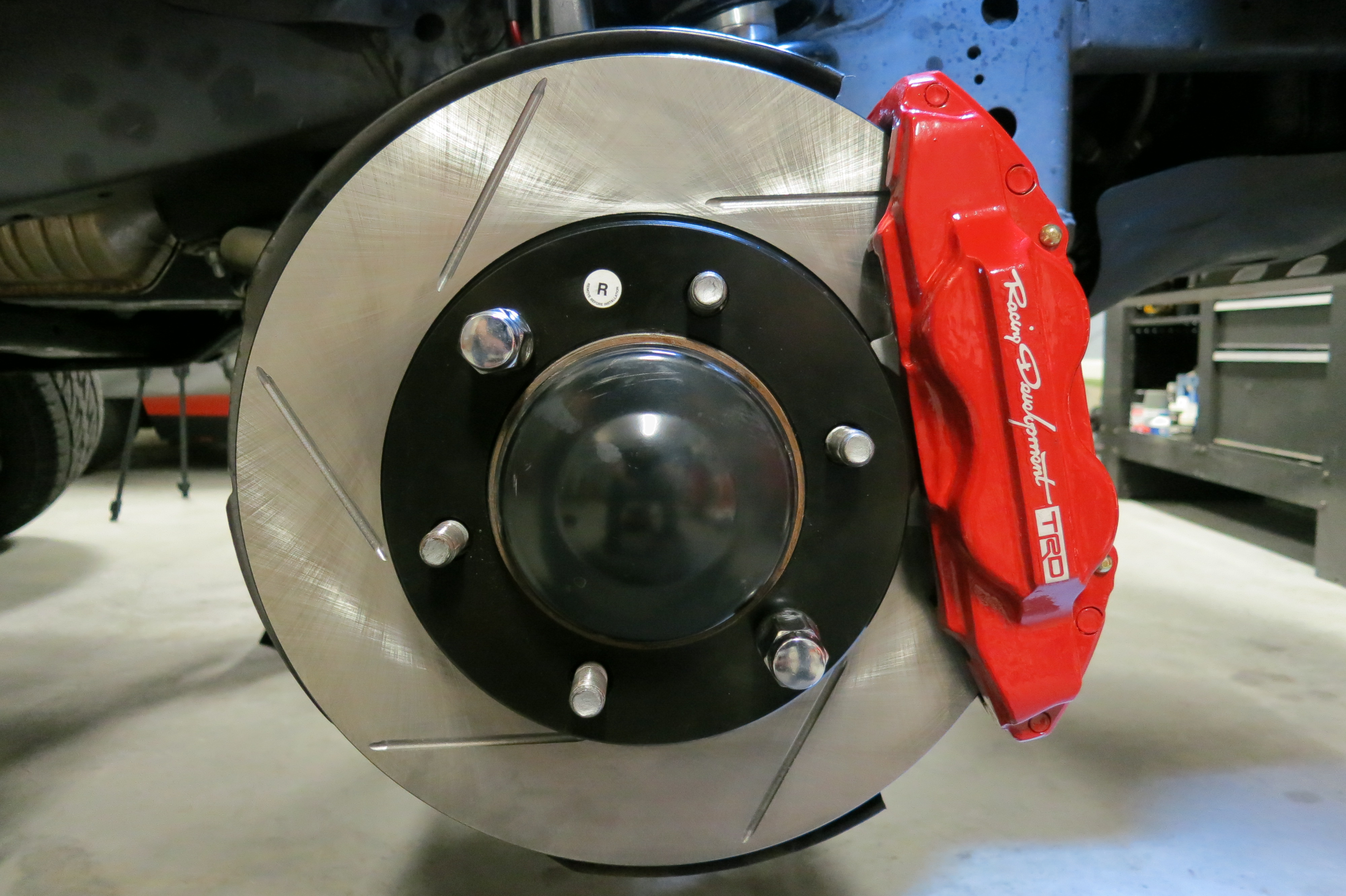

Tundra Brake Upgrade with Power Slot rotors
Stainless brake lines

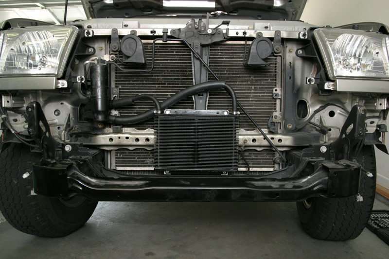

Transmission Cooler
(no valve body changes, no converter changes, stock fuel pump, etc)
Trans has been fine for 15 years and over 100K miles on this setup

Suspension
Bilstein Tundra 5100 shocks front/rear
Tundra TRD Coils up front on the <s>first</s> second shock perch OME 906 Rear
Gave right about <s>2"</s> 2.5" of lift on my 2002 SR5 4WD on the front and 2.5" in the rear
Hub to center front <s>21.5"</s> 22"
Hub to center rear 22.25"
<s>Tires Bridgestone Revo 2 265/75R16 (that are shot with 60K miles on them)</s>
Toyo Open Country AT3 265/75R16
No diff drop, no torn CVs in over 100K miles with this setup

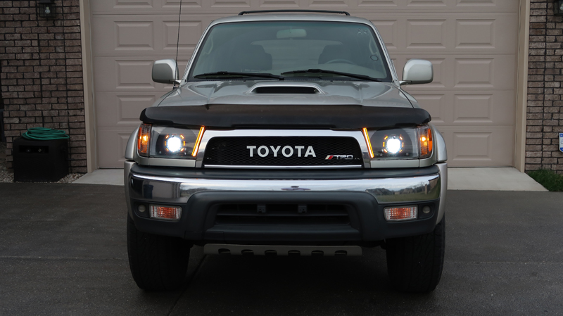

Satoshi Grill
Supercharged badging
Factory fog lights with factory stalk on the column (wiring was already there) rewired to work with parking lamps.
Motorized antennae failed (twice) replaced with Tacoma fixed antennae

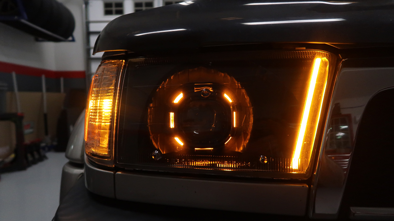

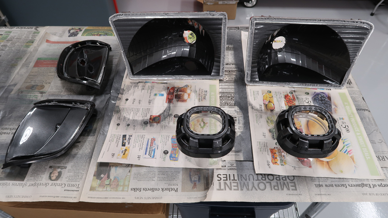

HID retrofit headlamps with amber LED bezel rings and strips, bezel rings and strips wired to parking lights
All bulbs replaced with LED with adjustable relay for turn signal speed

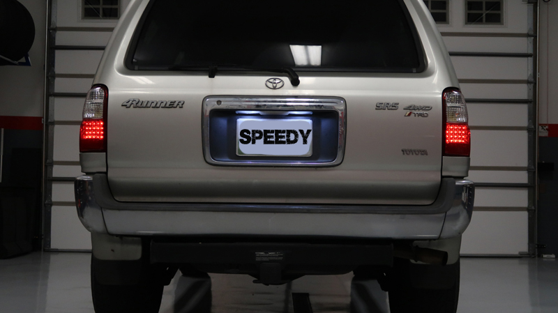

LED Updated tail lights

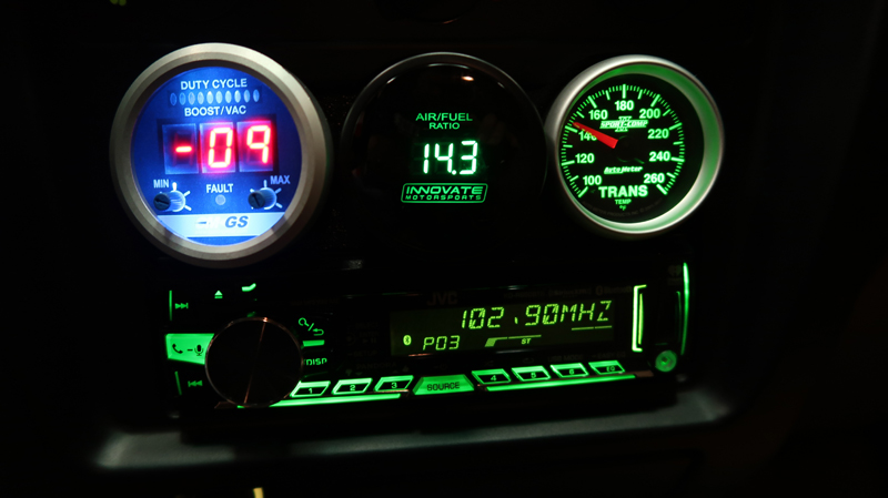

Custom gauge panel and bezels for water/meth control and boost, AFR, trans temp. I had Autometer put green LEDs in the trans temp gauge to match factory dash a long with a dimmer to match illumination.
Gauges have bezels that aim them 10° at the driver

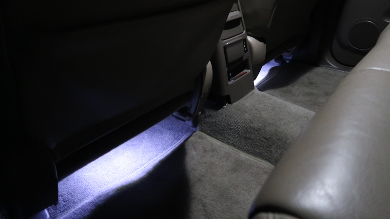

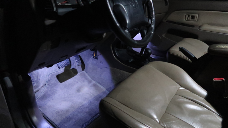

Front/rear foot well lighting when doors open (bright)
Front/rear foot well lighting when parking lights are on (dim)

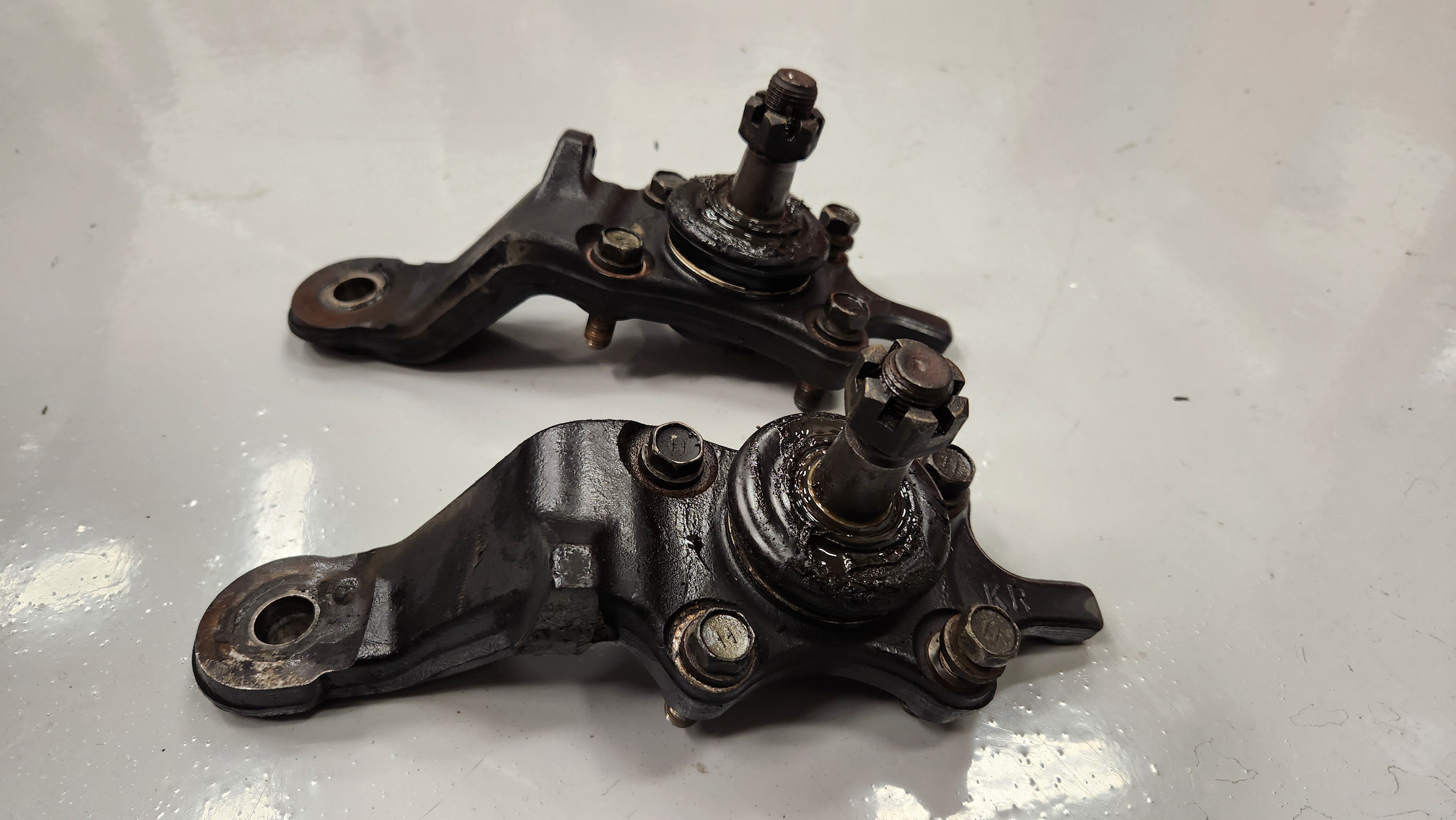

Lower Ball Joints on a scale of 1-10 about a 3.

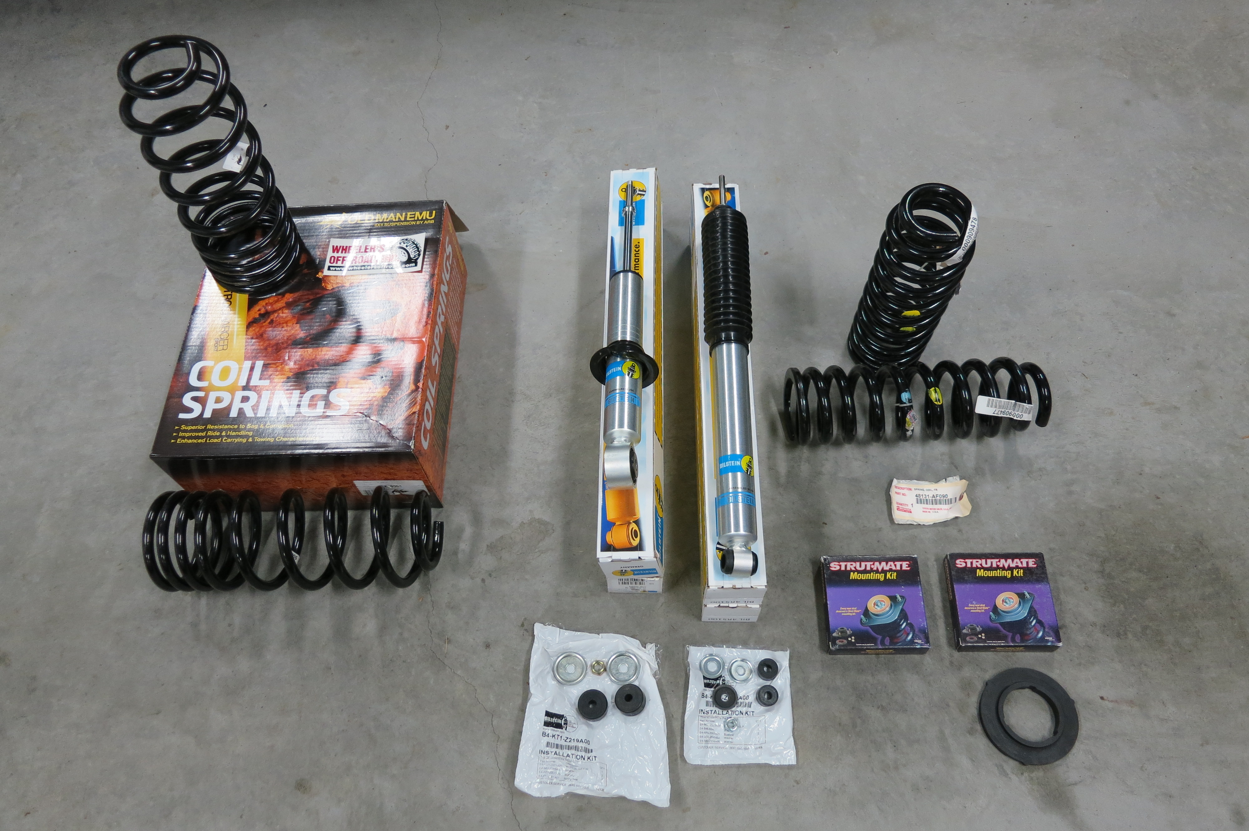

Adjusted the Bilstein suspension This was a difficult job in terms of getting the struts back in. Scale of 1-10 an 8 for me.

Are you running the trans cooler in series or solo? Fan or no fan on the cooler and what model?
Nice to see your build thread! I have watched all your 4Runner videos and appreciate all of your thorough and precise expertise with the work you performed in those videos. VERY helpful.
Trans cooler is in series. No fan. I believe it's a Hayden. Box said Tru-Cool and it was a 4454 model. This looks like it might be the replacement: Amazon.com: Hayden Automotive 678 Universal Rapid-Cool 9.5” x 11” Add-On Transmission Cooler – Not for Direct Replacement of the OE Cooler : Automotive
Mine has a bypass so that fluid doesn't go through it until it hits a certain temp supposedly.

Lower ball joint replacement is done. Video in the second post. Scale of 1-10 about a 3.
My truck has had a 2" lift for years and these ball joints were originally replaced by Toyota under a TSB 16 or so years ago and 100K miles. They were leaking a bit of grease but overall in pretty good shape.
Next up, adjusting that Tundra/Bilstein 5100 suspension.
OEM Toyota. Seems there's warm and cold weather variety. I got cold
How much did you end up spending on these if I may ask? I didn't know that Toyota had two variations of their hatch struts!
I am really speculating that those will outlast the strong arms variety from what this forum feedback is saying. :)
Sent from my SM-A536V using Tapatalk
Jon I sure hope mine last for the foreseeable future, but only time will tell. I installed my Strongarm 6815's in December 2022. I'll let you know if/when they give up the ghost.
