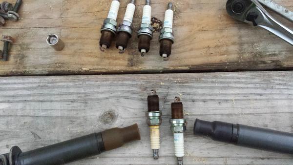

I finally got around to changing the spark plugs on my 03 V8. Took this pic after pulling the passenger side middle plug (both middle plugs actually). The plug came out a little tougher than the others (they all were pretty tough). But these 2 were brownish and the boot was discolored. Maybe there was some leakage from these two?

Those look like they burned nice. The only weird thing about the boot is that its the same color throughout. I would think with a leak you would have more of a discoloration instead of a uniformed brown like that.
