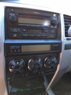

I have an 04 Limited with an fan AC/Fan issue and my next step in troubleshooting is to buy a used AC/Heater control. Can anyone tell by my picture if I have a straight or beveled unit?
I am having the following issue. The fan intermittently works about 70% of the time and the AC only works when the temp is set to LO. If I change the temp to anything above the lowest setting, it changes to heat and hot air. Bottom line, I have 2 settings (extreme hot and cold). I swapped the EC and Fog light relay.
There is a part number on the back of the unit (buttons).
