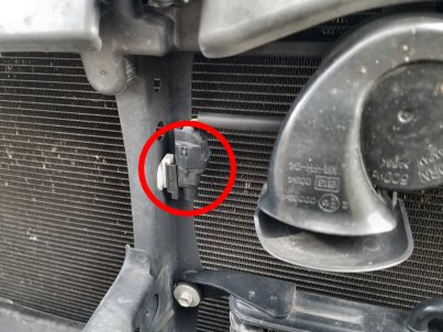

Where in the hood is that outside temp sensor?
The sensor is behind the grille and in front of the radiator, it's clipped to the center brace if I recall correctly, it's very small and has 2 wires going into it.
