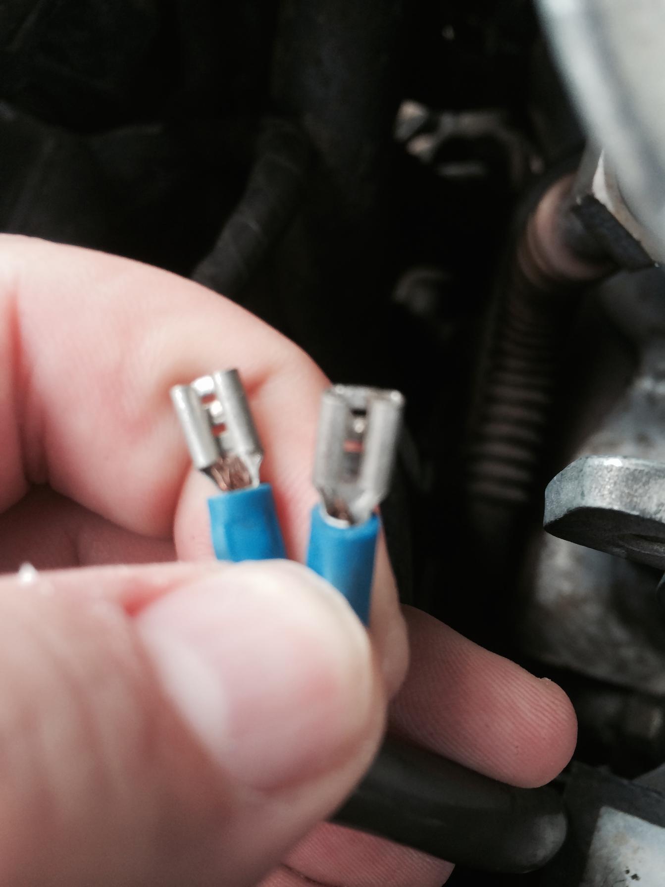

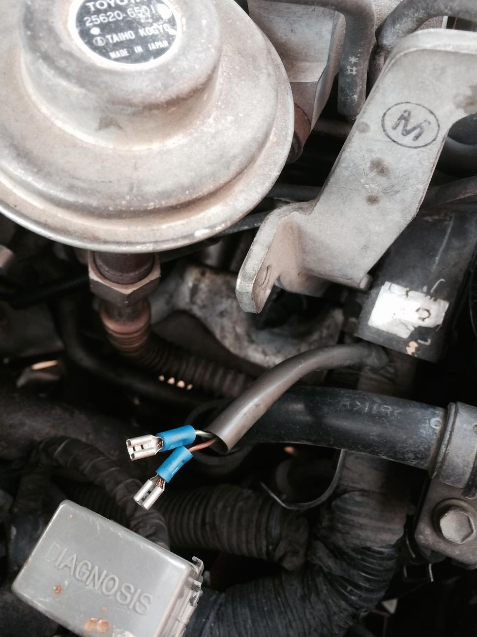

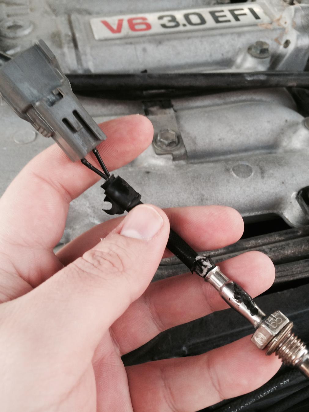

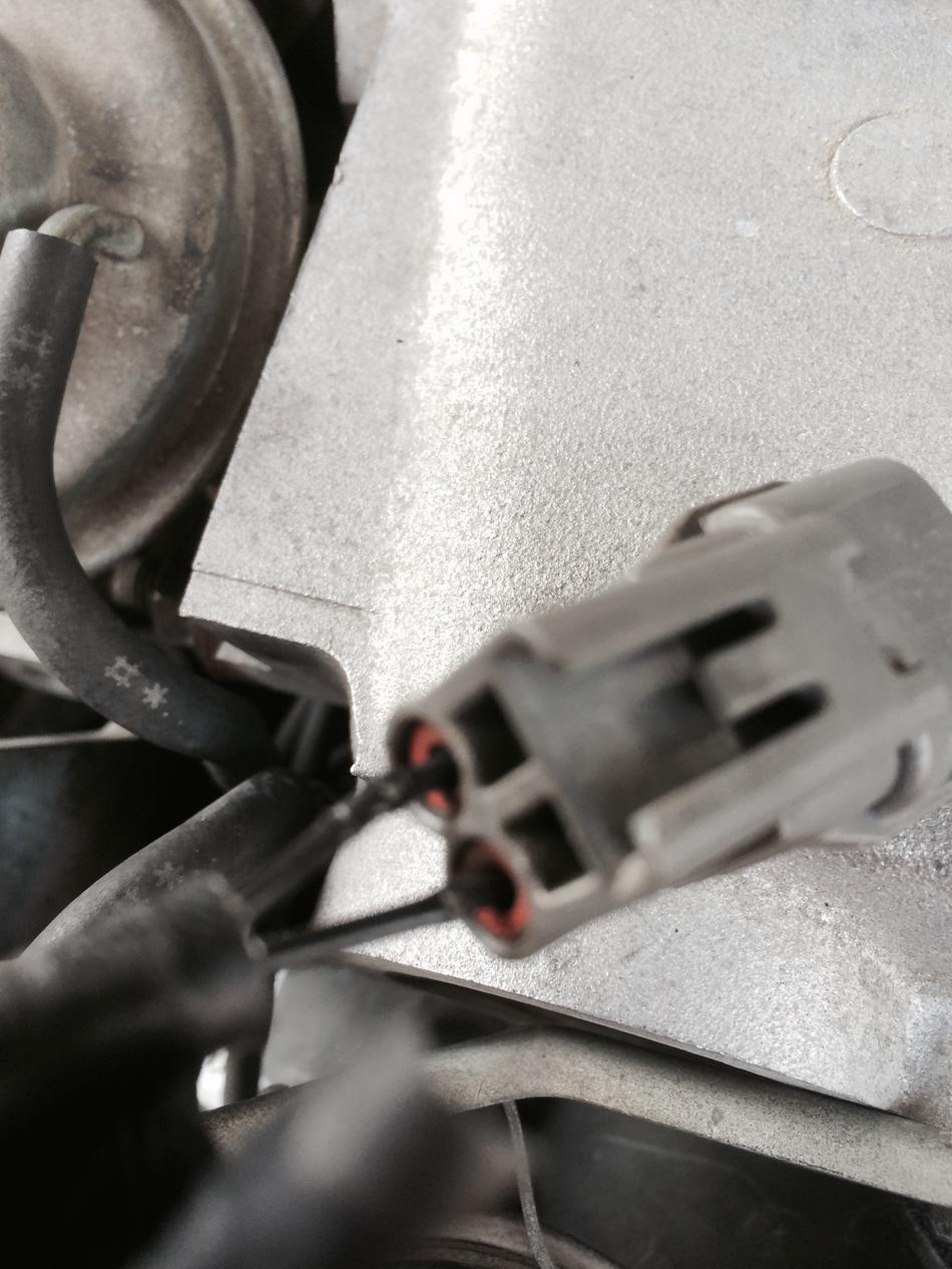

They said my EGR Temperature Sensor was the culprit and quoted me $300 for the new sensor. WHAT?!? I found one online for $140 but I haven't ordered it yet because I am still not convinced that is the source of the problem. Pictures are attached.
My questions...
1) Is there any way to test the temp sensor to verify that is the cause of the problem? I can't find much in the manual.
2) If you look at the picture closely, you can see a little bit of damage to the sensor wires. It is reasonable to think that is whats causing the malfunction?
3) The temp sensor is connected to two wires, one green and one brown/reddish. Does it matter how they are connected to the temp sensor? Meaning should green be on the left plug or vice versa?
4) Are the green and brown/reddish wires grounded correctly? In the picture, you can see that the copper wire is actually not connected very well. Would you suspect that might be causing the temp sensor error?
Thank you for taking the time to share your thoughts. If the solution is to buy a new EGR temp sensor than that's what I'll do but I want to find a way to determine if that is the actual cause of the problem. Any and all suggestions are greatly welcomed!

You might want to try the classic t4r section, your 95 is 2nd gen. You can use a resistor in place of the egr temp sensor and fool the computer. I cant remember the resistance but search and I'm sure you'll find it.
