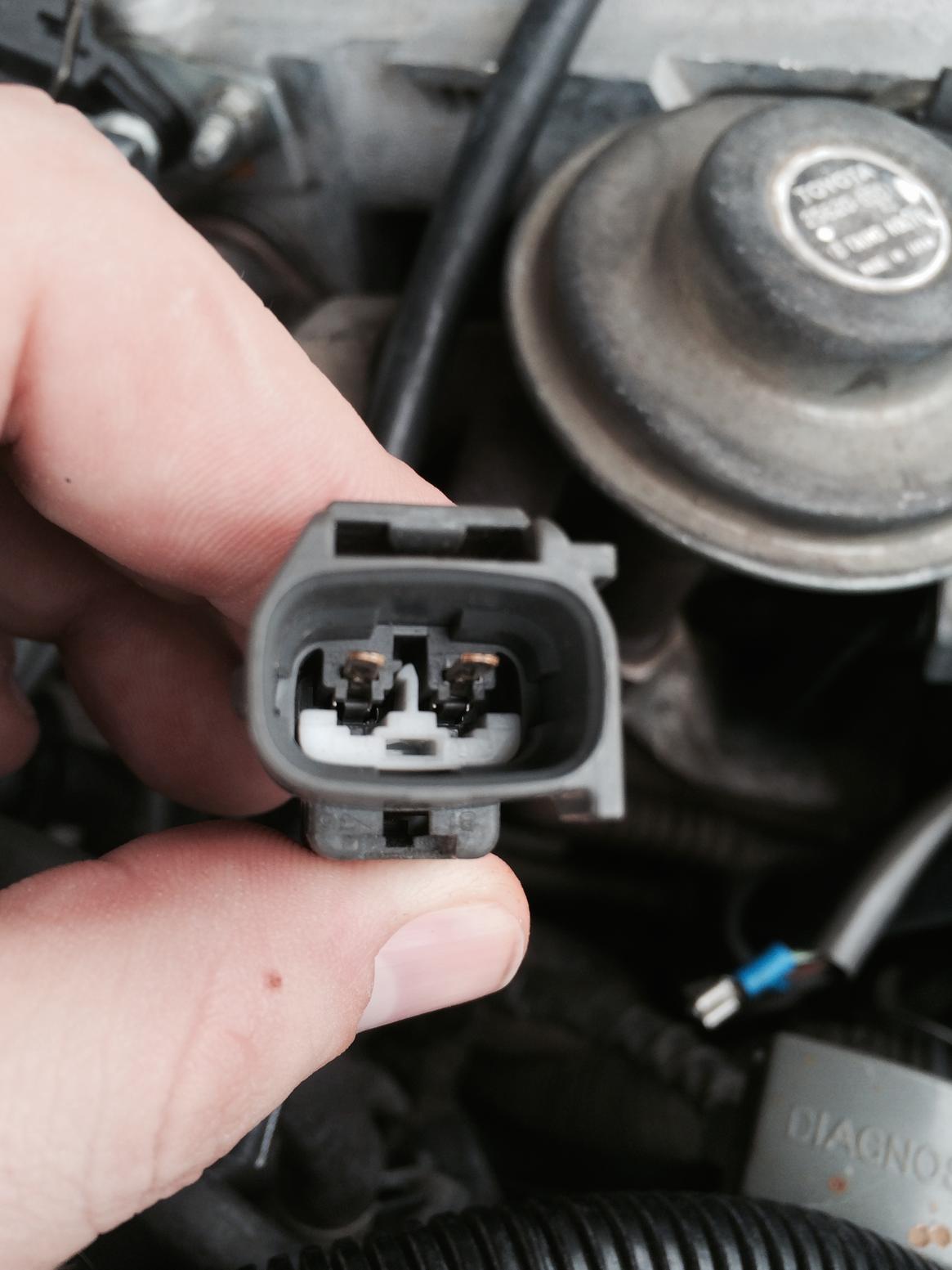

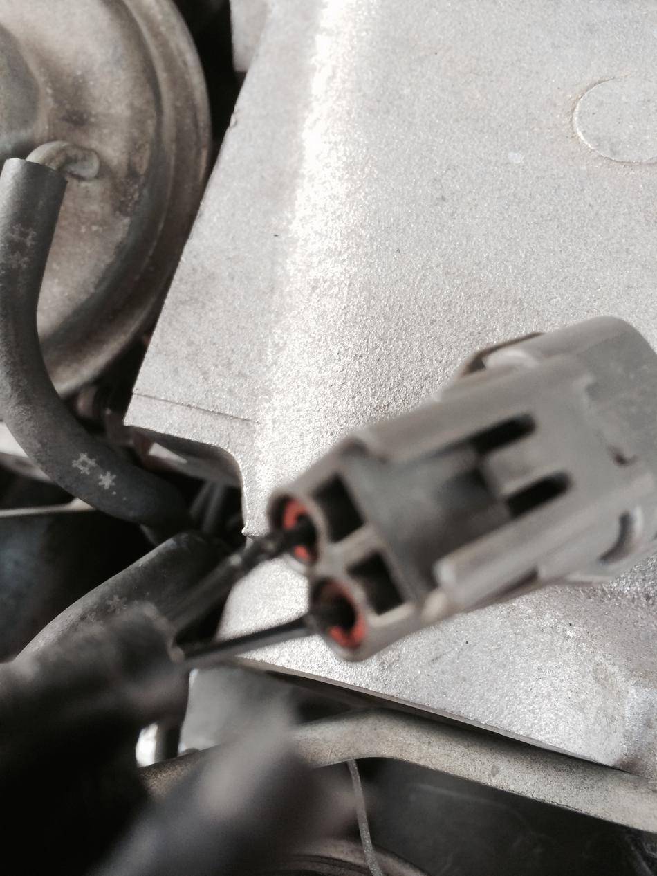

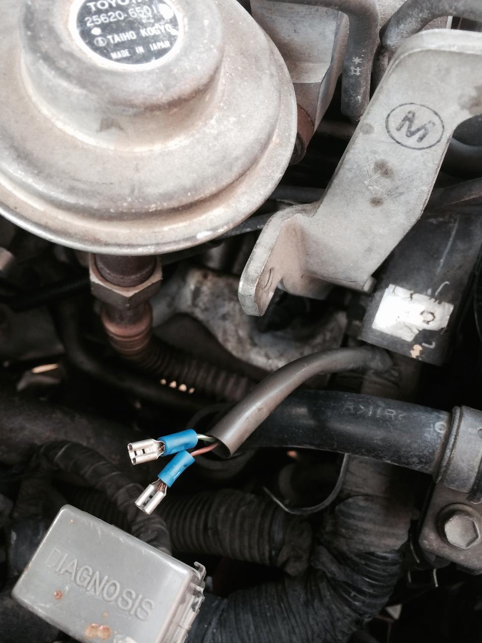

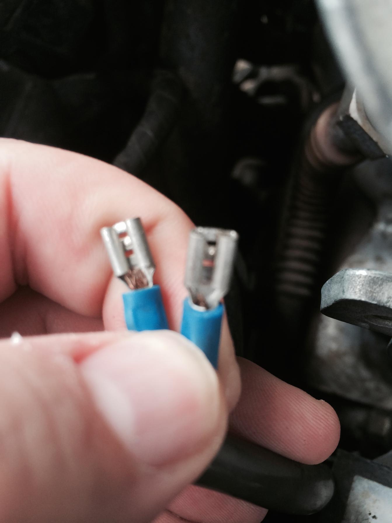

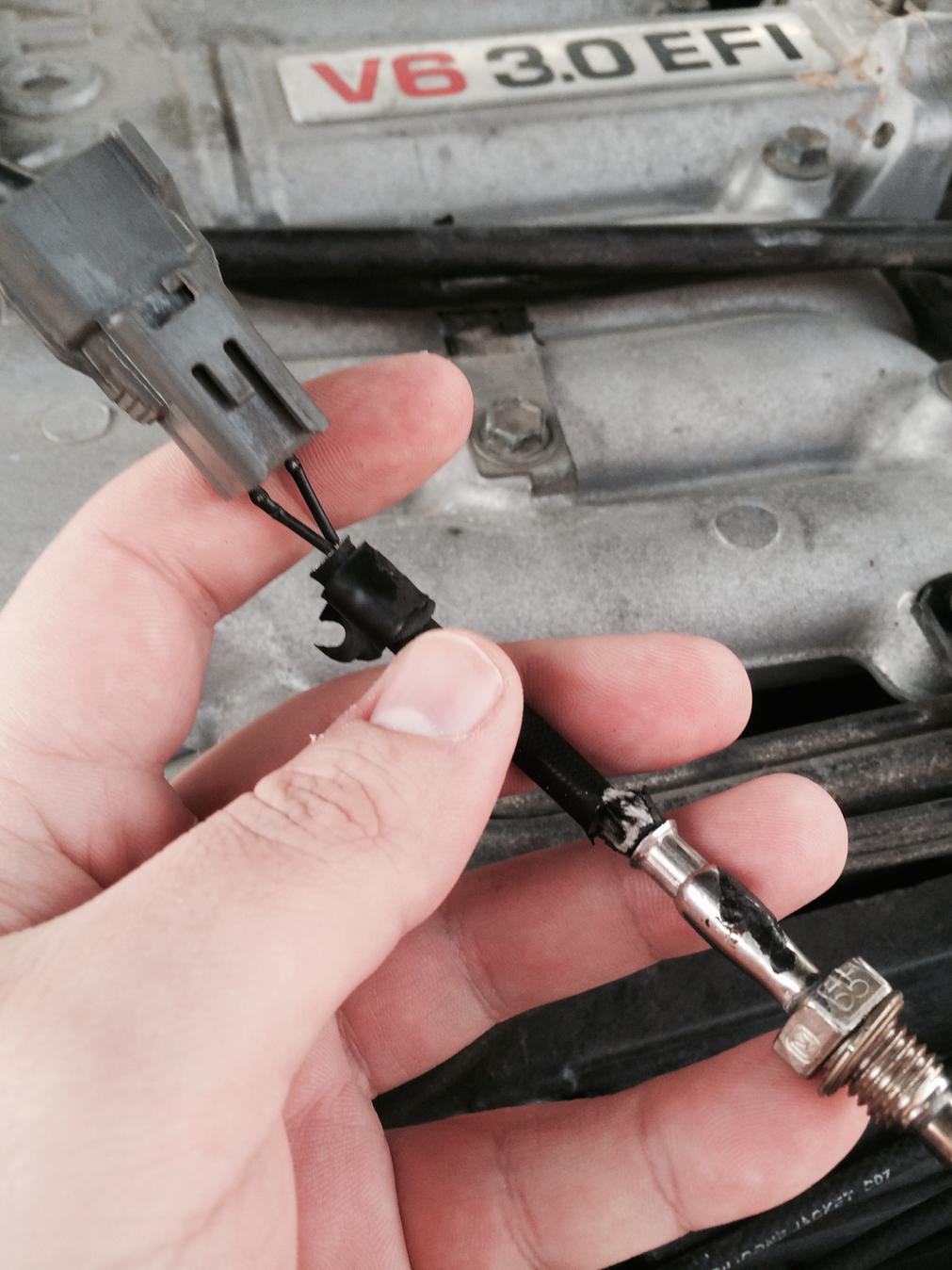

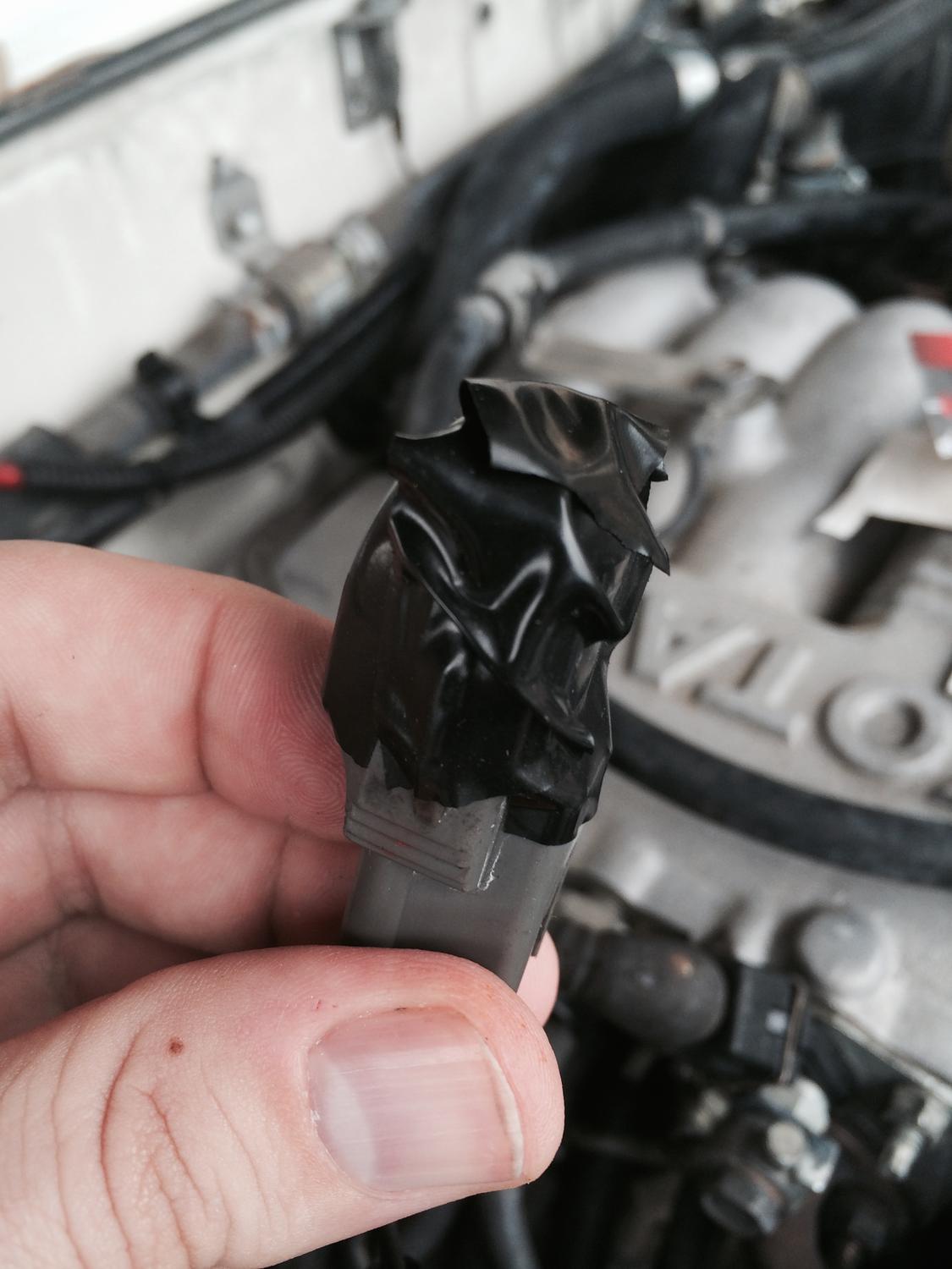

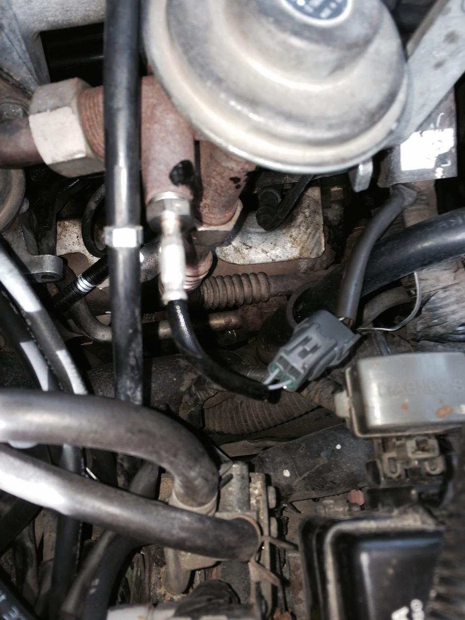

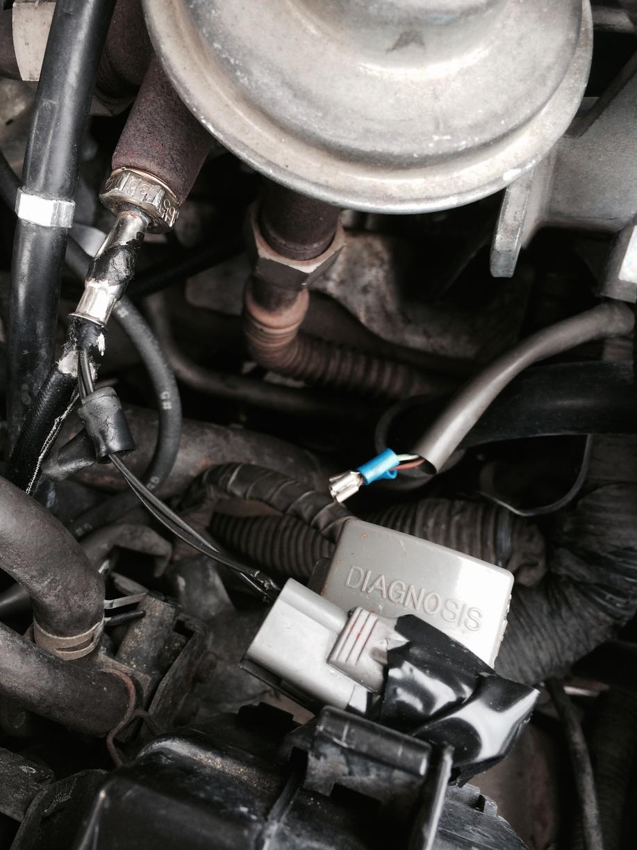

They said my EGR Temperature Sensor was the culprit and quoted me $300 for the new sensor. WHAT?!? I found one online for $140 but I haven't ordered it yet because I am still not convinced that is the source of the problem. Pictures are attached.
My questions...
1) Is there any way to test the temp sensor to verify that is the cause of the problem? I can't find much in the manual.
2) If you look at the picture closely, you can see a little bit of damage to the sensor wires. It is reasonable to think that is whats causing the malfunction?
3) The temp sensor is connected to two wires, one green and one brown/reddish. Does it matter how they are connected to the temp sensor? Meaning should green be on the left plug or vice versa?
4) Are the green and brown/reddish wires grounded correctly? In the picture, you can see that the copper wire is actually not connected very well. Would you suspect that might be causing the temp sensor error?
Thank you for taking the time to share your thoughts. If the solution is to buy a new EGR temp sensor than that's what I'll do but I want to find a way to determine if that is the actual cause of the problem. Any and all suggestions are greatly welcomed!

10k resistor
place a 10 k resistor across the connection and your problem will go away. Cost is $1.08 from radio shack. A search for 10k resistor will provide a wealth of information.

I may have the same problem. Buck my plastic connector broke and I to put wire terms on like you but the wires on mine or not color coded so I am unsure if I even have it connected correctly. If I do not would this cause the engine check light to come on.

Thanks for the tip Willy. I've done a bit of reading on the 10k resistor but I do have a couple of questions. It seems this only a way to bypass the sensor and so it won't "fix" the problem. I understand that the CEL should go away but is this an actual solution to the horrible MPG and sluggishness that the truck has?

Thats a good question Blue... I was wondering the same thing myself. I plugged it in and drove around for a few miles then I switched the plugs to see if there was any difference and I didn't notice any improvement.
I would love a picture of someone's temp sensor w/ resistor or even the factory installed to see if my wire connections are right. I can't find this info in the manual.
Buck, Ya need to seal those terminals so moisture doesn't get to the crimp.
I reckomend solder and marine heat shrink terminals. Under hood gets alot of moisture, and the electricals produce four times the corrosion when electrically active. Marine type had a glue that seals when the shrink tube is heated.

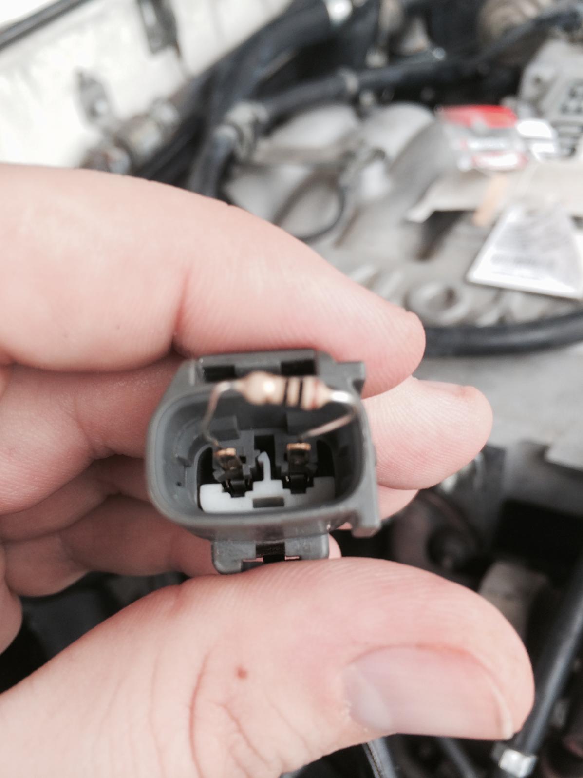

I've already ordered a new EGR Temp Sensor and it should arrive in a couple of days. I went on and bought the 10k (1/4 Watt) resistor at Radio Shack to plug into the old sensor. My thinking is that if the old Temp Sensor is still functional and I still have CEL after a few days, I will know that the Temp Sensor isn't the problem however when I checked for resistance, I got nothing... It just stayed at "1" while in the 20k setting. It seemed putting in a resistor would be a better test of the Temp Sensor than doing a hot oil test. Does anyone think my logic is incorrect?
I added pictures below in case anyone wants to see the 10k resistor plugged into the Temp Sensor. I didn't solder as this is just a test and it will only be used to determine if the sensor is working at all. Will this do the trick... I wonder

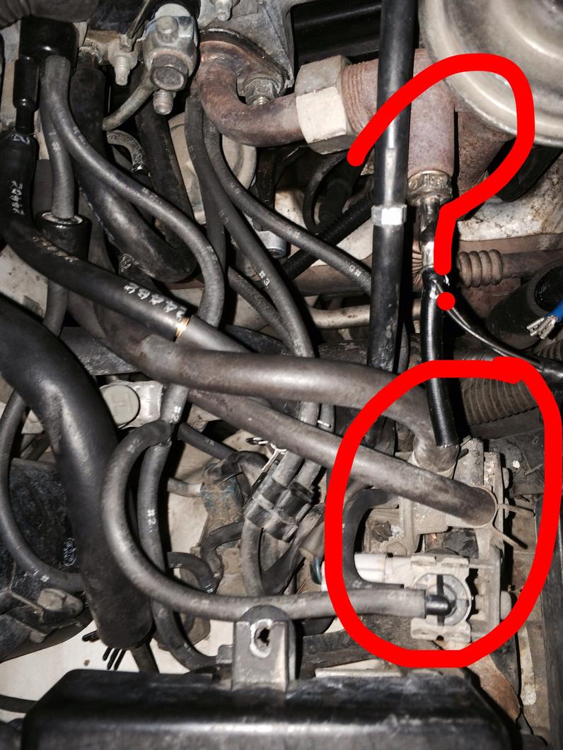

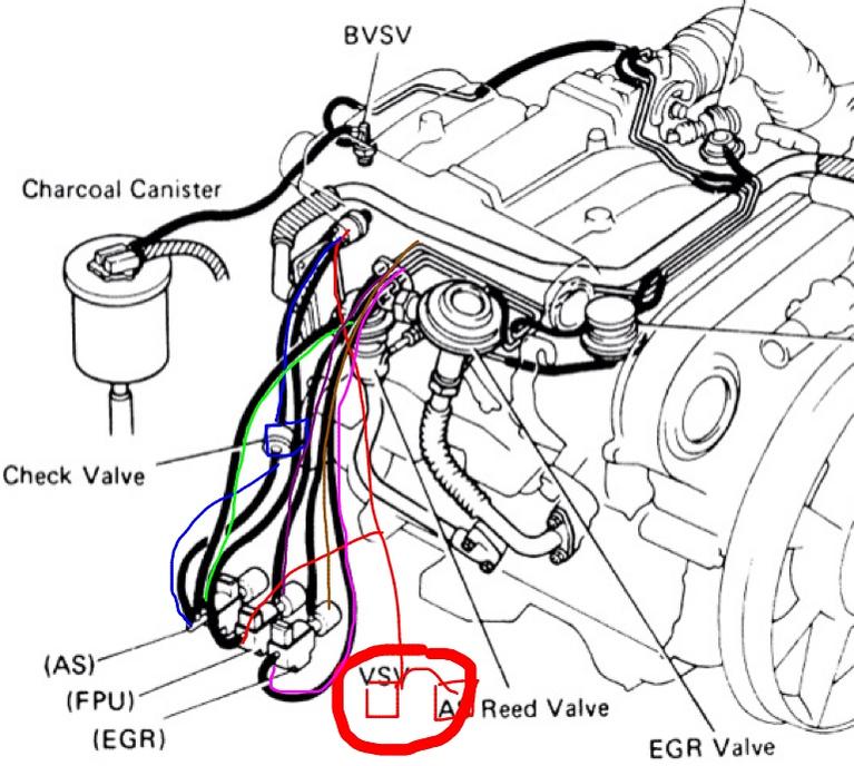

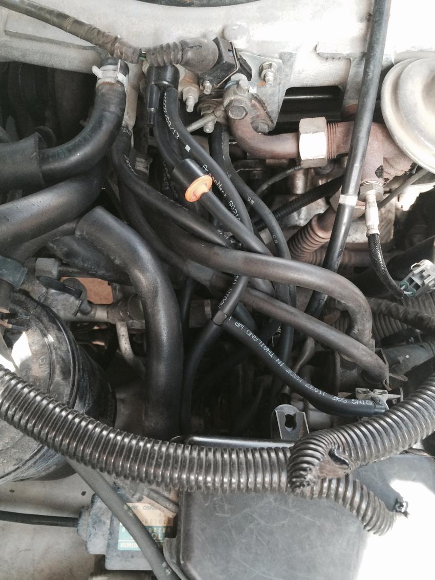

Still going through my vacuum hoses and I'm having a tough time finding a diagram that shows ALL the hoses. Hope someone can help me out. Excuse the crude drawings but its the only way I can show the lines I have.
First of all, can anyone please tell me what that part is that I have circled in red? As you can see from the diagram I've attached, this part isn't included however, I have vacuum lines running to and from this part. Assuming its a (grey) VSV but what is it next to? Are those fuel lines
You can also see in the top left of the picture that has the 3 prong plastic piece with one cap and two vacuum hoses. Quick question, is that check valve supposed to pass air through it by blowing or sucking, (thats what she said) as I wasn't able to get any air through it. Also, I've seen some pictures of the 3 prong plastic piece have 2 hoses coming from it. Any known reason why I have one plugged?
Another question... (I'm sure there is a name for it but I'm gonna keep calling it the 3 pronger) The 3 pronger has one hose going to the (AS) with the check valve and if you look at the other hose, it is split into a "T" one hose going to the mysterious red circled part and the other going to the (FPU.) The diagram doesn't show that.
Lastly, I have included the diagram with a crude line drawing of my vacuum routing. Here is a quick rundown,
Blue Line - With check valve from 3 pronger to back port of (AS)
Green Line - AS Reed Valve to inside port of (AS)
Red Line - 3 Pronger to VSV and it "T's" to the back of (FPU)
Purple Line - Far left of the 3 metal tubes at base of EGR Valve to front of (FPU)
Brown Line - Far right of the 3 metal tubes at base of EGR Valve to front of (EGR)
Pink Line - Middle of the 3 metal tubes at base of EGR Valve to back of (EGR)
Sorry for the long winded post but if this is correct, I wanted to include pictures and specific routing for others with this same problem. I've spent the past week scouring over every EGR post on all the forums and there isn't much more than the same old diagram. Thank you for your help!! Hope this helps someone else too :)

You do realize that the 10k resistor needs to be connected across (between) the wires back to the ECM right?
Also... it doesn't matter which way those 2 wires are hooked up to the EGR temp sensor. It's just a temperature resistor in the circuit.

All those years in High School taking French when I should have been taking an electronic class. Well, goes to show that a dummy with a pack of resistors isn't getting very far :trophy:
I was trying to diagnose my EGR system. The shop told me the temp sensor needed to be replaced and I got the tip about the resistors. Thought I'd give it a try to see if that removed the CEL. Even if it did and I hadn't screwed up the simple task of connecting the resistors, I was/am still planning on finding the problem and fixing it.
Got the new temp sensor today and I've noticed a serious difference in the performance. Its still a bit sluggish but I'm waiting to see if the light comes back on. Fingers crossed

Replaced the EGR Temp Sensor and CEL has not returned. Replaced all the vacuum lines just because it was easy and only cost 6 bucks for all the lines. Thank you all for the suggestions. Hope this helps someone down the road :)
