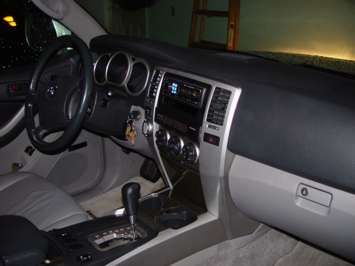

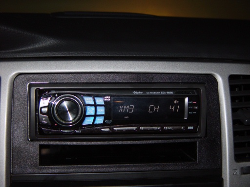

Any Pictures?
Not the best...it's hard to get enough 'space' in the vehicle to do them justice....but here's a few:

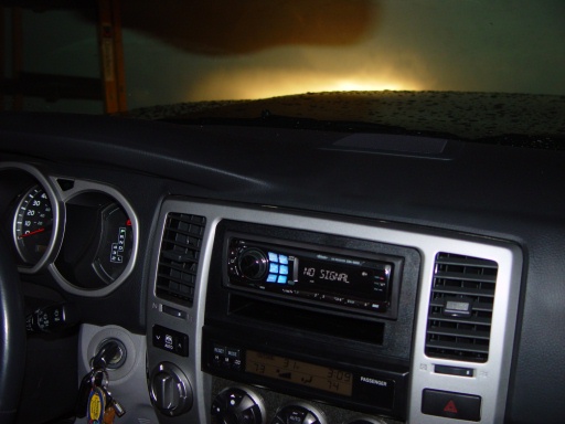

Last picture.....
The antenna is on the roof at the corner over the drivers side, they ran the antenna wire down the side of the windshield. I had an IPod cable installed too (which allows IPod control from the alpine h/u and the cable and IPod are in the glove box:
