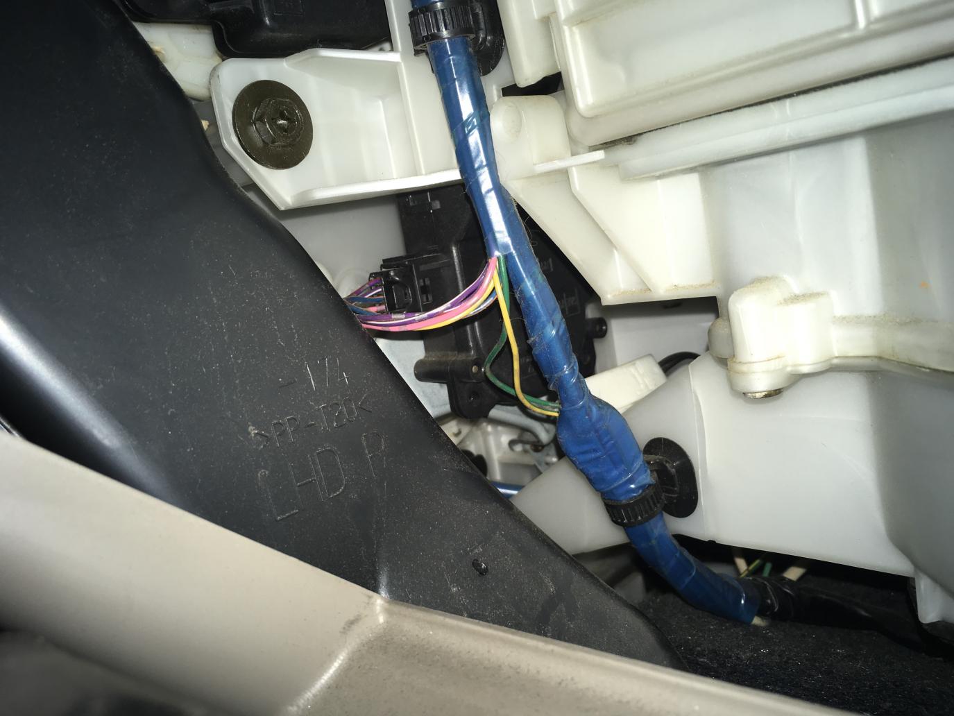

CAF was replaced last summer so it's about time for that. I took a look for any blockages and while in there did some more investigating. It appears to be coming from a black servo just to the left of the fan body, which I'm guessing is the air mix motor. Attached is a photo of the expected culprit. When I unplugged it and turned the key, no noise....plug it back in and turn the key, I hear the noise again. Most of the vibration appears to be coming from here too. Sounds like I'm off to search for a new servo and how to replace....
Blend doors motor.
Had mine replaced recently, it's a PITA trying to align the doors with the motor apparatus when trying to fit it back in.
I didn't have the dealer do it, afraid of what they'd charge for this and went to SD truck shop instead.
