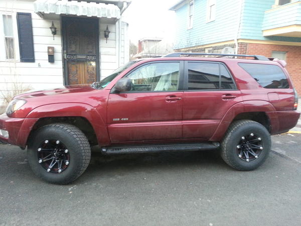

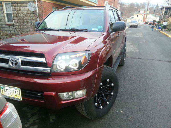

Hey guys I am new to T4R.org and have recently decided that I want to upgrade my runner! Id like to take it off road some more, havent done much of it so far though, probably nothing extreme but wanna challenge the 4runner a bit! I put a 3" front and 2" rear leveling kit on it as well as some new tires, rims, headlights and tail lights, tires are nitto terra grapplers 285/75/17, rims are ballistic jester rims with the inserts hand painted the color of my 4runner, then black headlights and smoked tail lights. Anyways I have plans to black out/satoshi the grill, eventually... but I was wondering what suggestions you guys had for me to make it more trail ready. and of course look more BA!!! http://im.toyota-4runner.org/images/icons/icon6.gif
Thanks for the help and I look forward to hearing what you guys think!

Welcome. First thing, lose the running boards and get a good set of sliders. You'll destroy those boards and possibly your rocker panels real quick on a moderate trail. Also, you're probably rubbing big time with those tires and wheels. You'll need to address that (cut or move fender liners/mud guards and chop the body mount) if you already haven't.

Nice looking runner! I would agree with the above post. Sliders are very important . I am still waiting on mine to get here. I would also get some skids.
I like your rims, they look really good with the color.

I like your truck! I also have an 05, but mine's a limited. Your headlights look super cool too, I want to get those when I need to replace mine.

First off Sick runner looks like what I hope mine will look like someday! your suspension looks really nice also the Icons look great and from what I hear are top notch quality! I agree with both you and dawg4runner the running boards need to go! never really payed much attention to them but after looking at others it the Rock sliders are a necessity plus taking the running boards off make it appear to sit higher! I would like to get a front bumper sometime but I feel like it isnt the first thing I need. Definitely on the wish list though!
