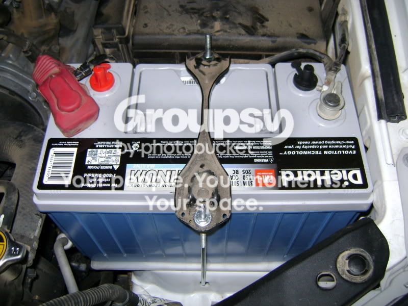

now this just fits ,without any cable modifying, but if you got alot of accessories, it works.
Shrockworks001.jpg~original
yes its a 31m, if u turn the pic upside down , u can just make out the specs.i got mine on sale last year for 230, yea, i know thats alot of $, & way more than i need, but u cant beat the specs. its like the odyssey 2150? ,but cheaper, ha, ha,maybe good for u , ur in canada , right?

Group 31M in a 2005 T4R SE V8?

I know this is a relatively old post, but I'm trying to be prepared for when my OEM battery fails. Did the Platinum 31M fit without any mods to the tray or clamps? If you had to do it again would you choose this battery or another?
Thanks,
Bill
