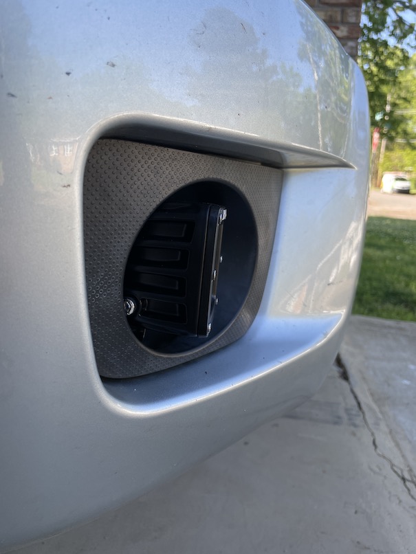

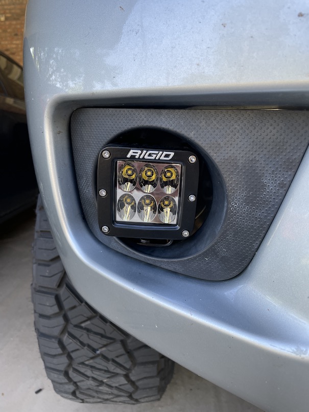

Installation Procedure
1. Remove as many fasteners as necessary to pull your fender liner out of the way so you're comfortable and have plenty of work area access. My rig is running Dobinsons MRA and 305s, so I had already Dremeled enough liner away that I only had to remove one bolt.
2. Remove the black plastic moulding surrounding the stock fog light housing. It's held in by four sturdy clips and pulls out towards the front of the vehicle. Get behind it with your hands, a prybar, a flathead screwdriver, a tweaker, whatever you want... don't be afraid to use a lil' muscle!
3. Remove the stock fog light housing. It is held in by two plastic locating pins on each side. I found it easiest to use a screwdriver and push the inside pin facing the motor out of its housing and towards the front of the vehicle. Then, pry the other pin out. There is no perfect way to do this. The housing comes out of the front of the bumper... again, use some muscle!
4. Cut the two wires leading to the 9006 bulb connector as close as possible to the connector.
5. Use the provided Rigid hardware to mount the bracket to the light. Tighten the inside bolt all the way; it's hard to get to once the light is installed. Leave the outside bolt loose.
6. Mock up the light fitment. Focus on getting the bottom bracket level with the bumper. This is a good time to check how the moulding surround piece will fit back in.
7. Holding the light in place, use the Sharpie to mark the bumper where you will drill a hole to mount the bracket.
8. Drill the hole.
9. Mount the light into the hole you just drilled. Carriage bolt head faces the pod, nut and washers thread on from the underside. I used some Loctite for fun.
10. Cut the Rigid wiring harness that plugs into the lead from the light pod. Leave about 6 inches of wire on AFTER the quick-connect.
11. Using your pliers, grab two Scotchlok connectors and hook up the factory wires from the plug you cut in step 4 to the Rigid harness. My tweaker came in handy here to make sure each wire was in the correct channel (I put Toyota wires in the inside channel closest to the hinged cap). Green Toyota wire to Red Rigid wire, White w/Black Stripe wire to Black Rigid wire.
12. Test for operation. Your lights should come on when the fog light and headlight switches are both on.
13. Use some zipties to tidy up your loose cables and tape off any exposed parts of the Scotchlocks that could let moisture or debris in.
14. Reinstall the black plastic moulding surround piece. Depending on your mounting location, this may take some muscle.
15. Bolt up your fender liner.

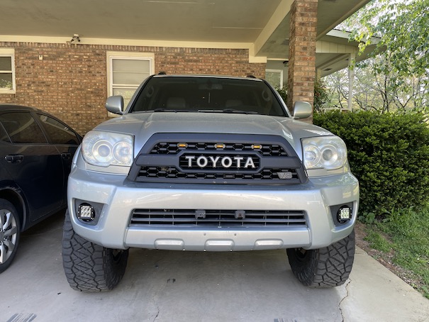

16. Repeat steps 1-15 for the other side of your 4Runner.
17. Admire your work!
