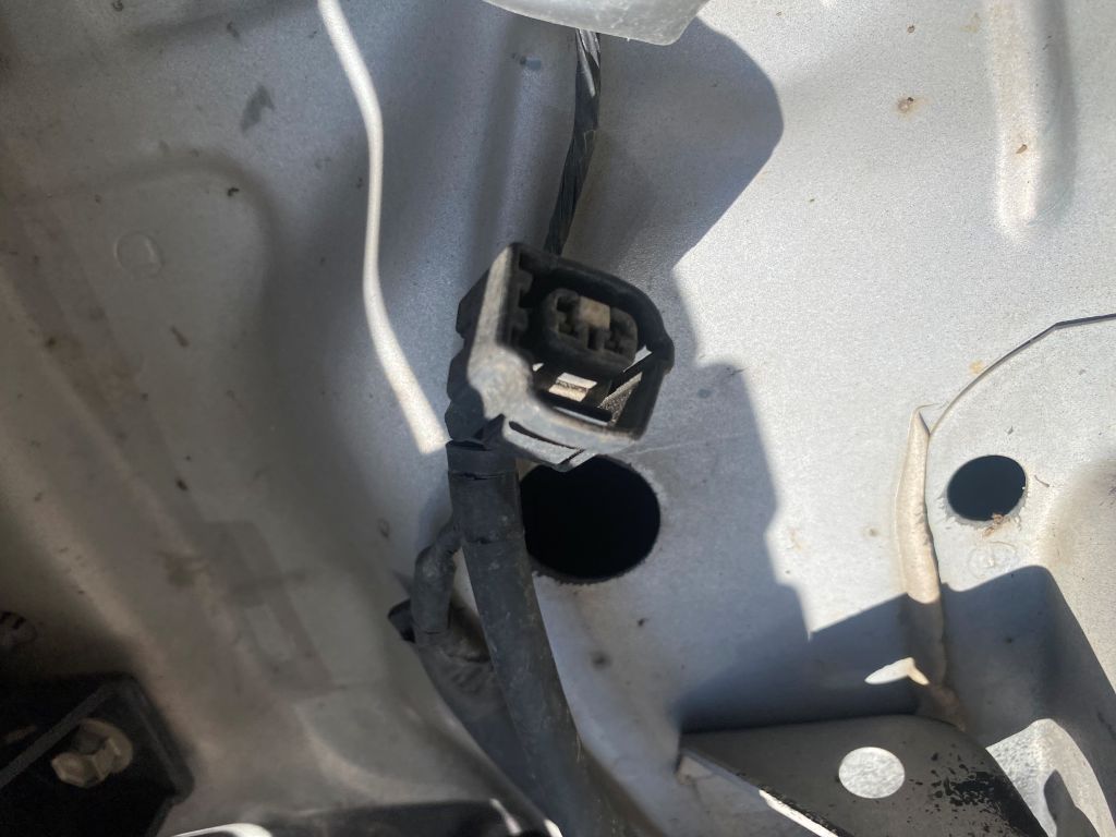

The drivers side behind the bumper has this single connector and wiring (see attached)

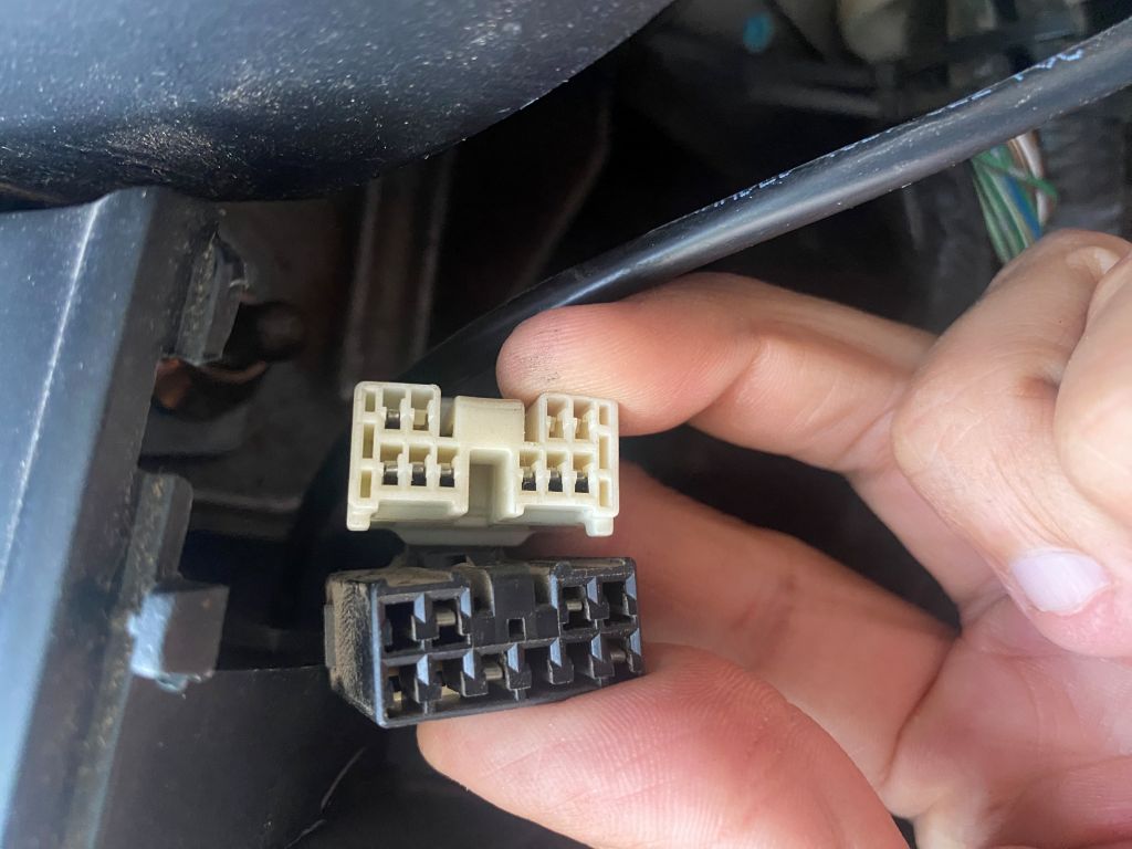

Behind the dash at the knockouts for switches are these two connectors and wiring as well (see attached)
When I bought this 4runner years ago, there werent fog lights installed at the time.
Does anyone know if these are the fog light connectors and wiring?

Control for the '99-'02 fog lights is through the headlight stalk, no extra plugs in the dash are used.
The plug you show under the bumper is likely for the outside temp sensor used on the Limited (yeah, that plug is there for the SR5...). You will have plugs for the fog lights taped up there in that area though.

I don't have the PNs right now - just make sure that the headlight stalk is the correct one for a '99 - there are at least two versions...
