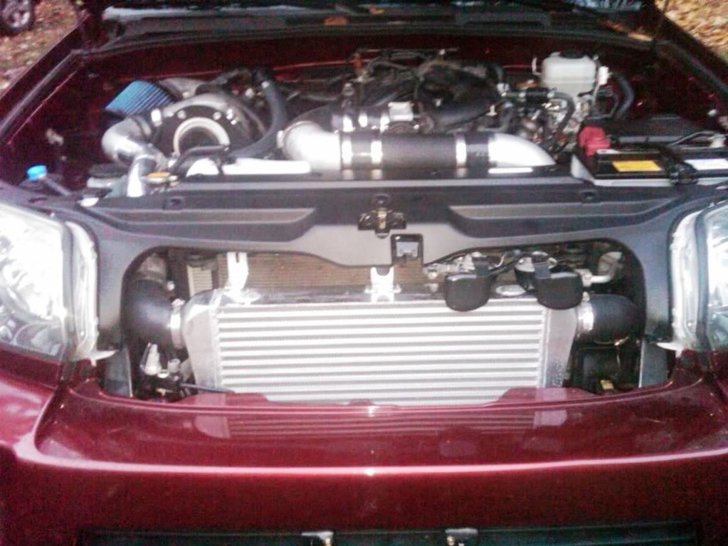

THe system has been up and running for about 18 months now. Drives great and almost totally silent in operation.
The final production kit was dynoed yesterday. Stage 1 kit dynoed at 360 RWHP up from 205 stock.
Just need to write the install manual and get it up on the URD site.

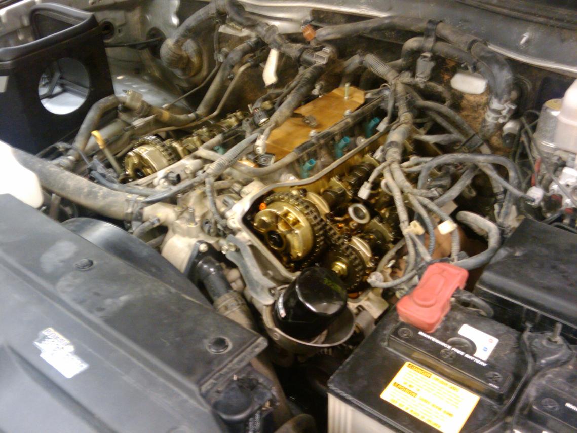

yes but only on the exhaust side of the cams.
You must be Gadget's publicist. Just having to change the exhaust cam sprockets doesn't gloss over the fact that the kit requires tearing into the engine. How long did it take you to swap out your exhaust cam sprockets? You did it in your garage at home? It went smoothly? What would you do different if you had to do it again?

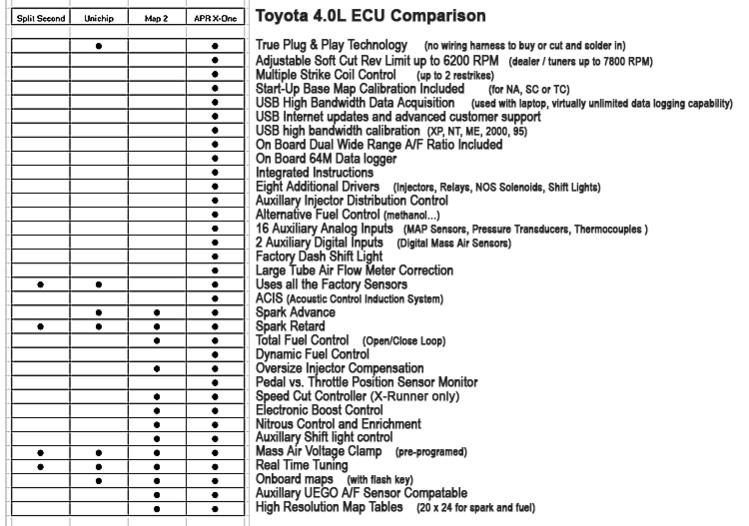

pssh, I wish. Anyway it not that bad honestly I went to the APR shop as its IN san antonio which is superbadass and so I can get cutsom tuning. The X1is what the URD kits use for tuning so the cam gears and thermostat are gonna need to be changed out for the X1 components.
