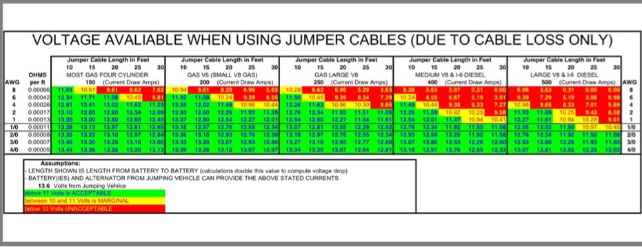

It might not. There could easily be a few volts drop in the jumper cables, and if the bad battery is high resistance rather than internally shorted, the extra couple volts from having the donor engine running might make a difference. The donor car's battery should in theory soak up any voltage or current spikes.
It might not. There could easily be a few volts drop in the jumper cables, .
If you use a decent set of jumper cables with the proper gauge wire you should see minimal voltage drop.
also this. in either case, mine will be off.
