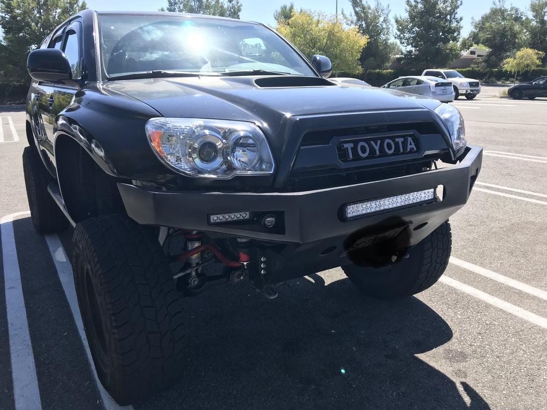

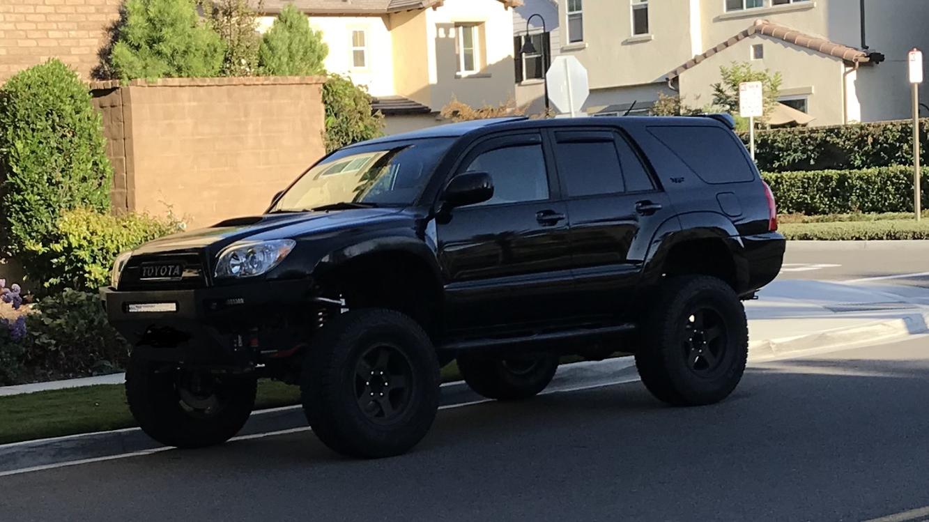

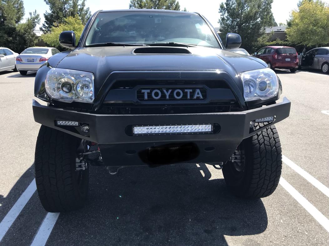

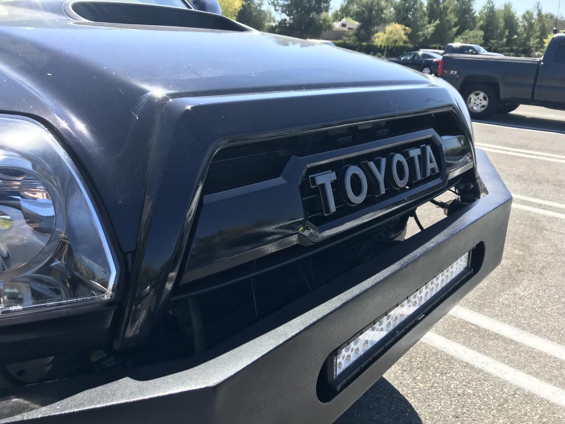

I grafted a Tacoma trd pro grill onto my 06 4runner grill. I picked up a 3rd gen Tacoma grill on eBay for cheap as the donor. This is much harder then the satoshi mod and more tools tools are needed. A lot of patients is needed beacause glues and Hondo need to dry. The Tacoma grill is much flatter then the 4runner grill so it’s a judgement call on the way you want it. It took me about 4-5 days mostly drying. I was gonna do a write up but wasn’t sure if it would look good and I’m still checking for stress cracks. But, hope this helps somebody build theirs or gets some ideas.

Any updates on how the grille has held up? Looking to do this and wasn’t sure if you’d ever made the “how to” post yet.
its holding up great so far... i used a couple screws, expanding gorilla glue and some jb weld. it was one of the imitations ones from ebay so the double sided tape for the letters was poor quality and a letter was loose. so i don't have to buy another letter i re-taped it with real 3m and glue gunned the alignment tab in the rear.
You also could have just scraped off the old tape and just used clear silicone caulk. I’ve done this many times for loose emblems and badges and they never fall off again, plus it’s easier to cut loose if you actually need/want to remove them later. I only use the 3m tape for stuff like side body moldings and heavier things. Silicone would work for those as well, but would need to be taped in place to hold it in position while drying, and I usually don’t have the patience for that, so I just use the tape for a quicker repair.
