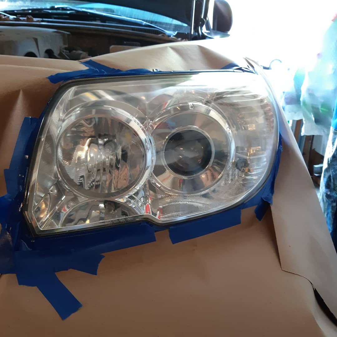

I sanded my headlights down with 600 grit and hit it with a few coats of Duplicolor clear coat. It came out pretty good.
I expected it to yellow with how hot it gets and no shade/garage but surpringly it hasnt yellowed.
pro tip. avoid the machine car washes at all costs. theyll destroy the clear coat on the headlights, hood, roof and spoilers
heres an after pic, 4 coats of clear after 600 grit, nothing else
