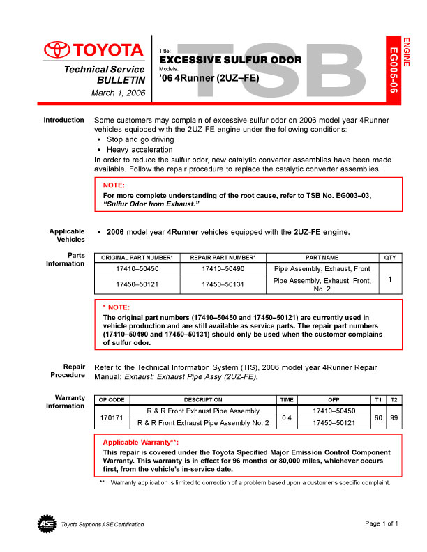

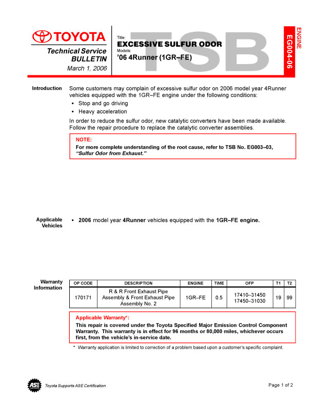

Here's your TSB for the sulfur smell. Take it to the dealership and have service repair it.
jb
2006 2UZ-FE Sulfer Smell TSB
