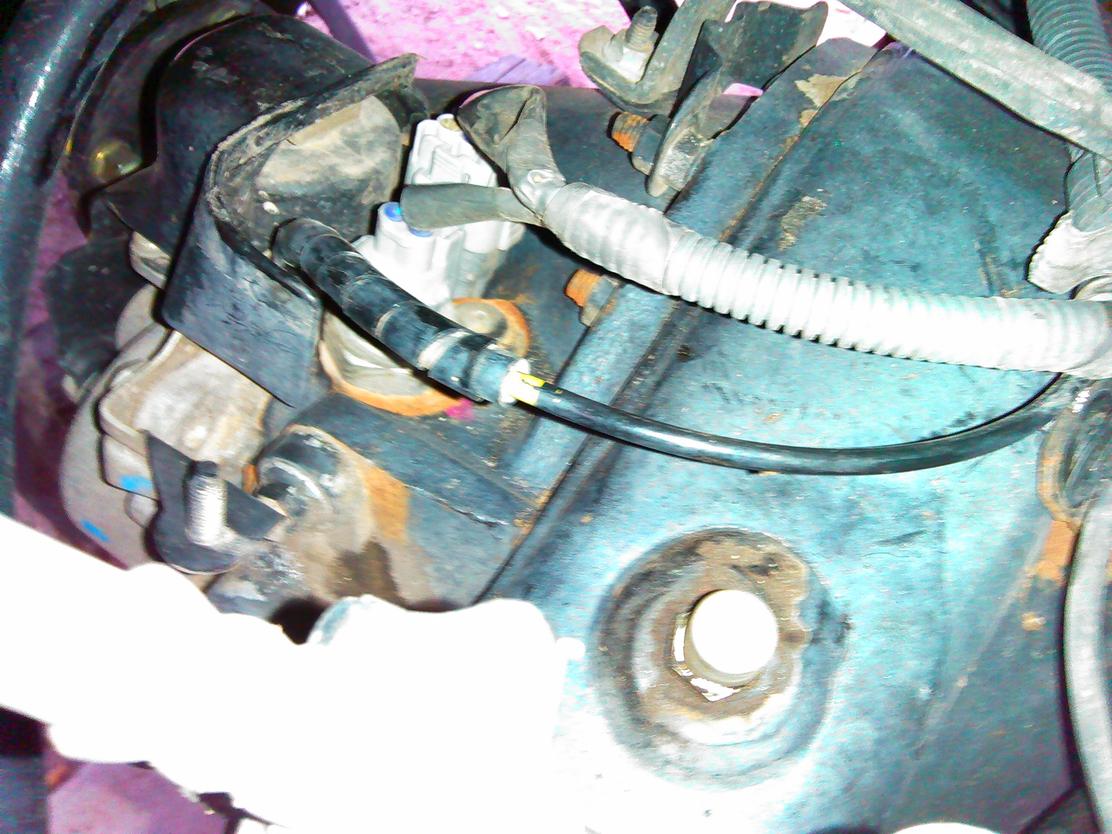

Hey t4r lovers. Has anybody used the low range offroad elocker harness to hook up their fj to 4runner swap? If so how did it go for you? The hardest part for me was feading the switch through the firewall boot. I attempted to remove the face of the switch not realising I'd have a couple inners fall out. Everything was reassembled and plugged in and then tested. Right now I'm experiencing no activation in the diff. The switch has two lights but only the bottom one illuminates. The top light that indicates the the locker is being locked does nothing, no blink no flicker. The harness from low range came with no instructions to tell me what to expect. Does anybody have a set up like this and if so how do the switch lights signal you when your enguaged or disengaged. Thanx guys.

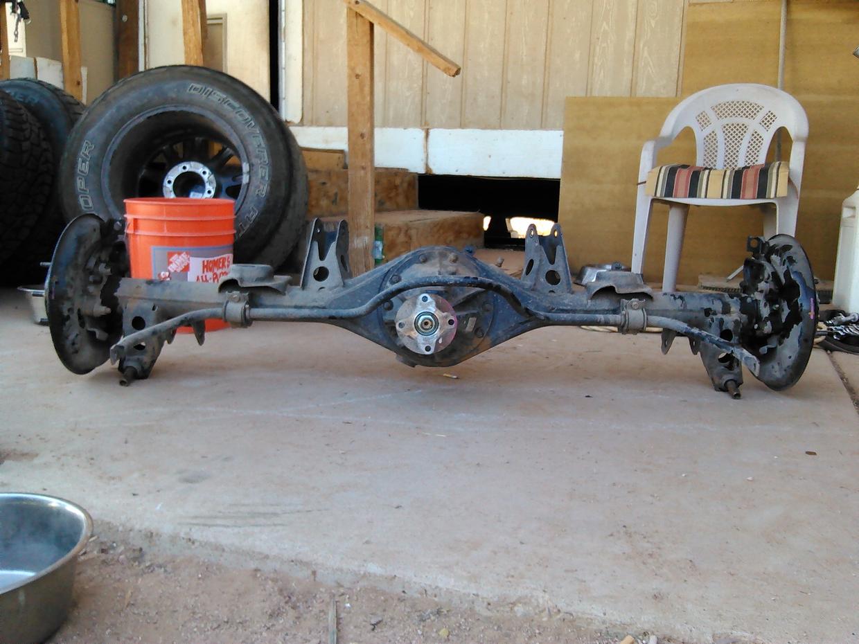

I bent my original axle housing and I have the 4 spd auto, so I'm rocking the 390 gears. The only one I could find with the 390s instead of 373s was out of an 07 fj which happened to have a factory elocker. Lowrange advertises a plug and play harness for this application so we can bypass the computer and use the rear locker in 2H 4H or 4L.

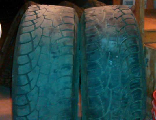

Sorry I tryed to do this in one reply. These are just pics of the bent axle out, the loss on two brand-new Cooper ATPs and the fj rear installed.

How did you manage to bend the axle bad enough for those tires to wear out like that? Also how old are those tires?

I bent the axle landing slideways in the sand. Only a couple weeks after buying the tires (new). The wear is about 5ish months of 50+ miles a day to work.
