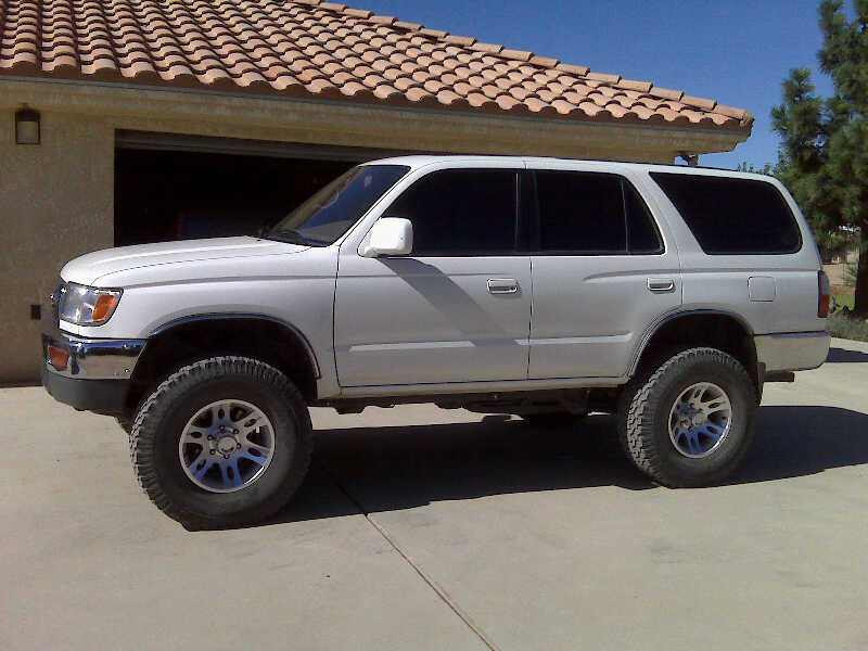

i installed a 1" body lift last night to eliminate the rubbing issues i have had with my 285/75's it was fairly straight foreward, and the kit i bought did not have instructions. i used the original bumper bracket, but i modified it to raise the bumper up an inch. I also had to move the sift boot plate down a inch because the shift lever for the tranny was hitting it. it looks good to me. and the best part.... no more tire rubbing while wheeling

thanks.
those rims were pretty cheap when i got them. i think they were 100$ each. they have i high offset that ended up being perfect once i upsized tires
the body lift took me about 3 to 4 hours, and that includes modifing the front bumper to raise it an inch. its just takes that long because its quite a few bolts. its really easy.
and as for the suspension lift i did 6 months ago. that also took about 3 hours. the back was easier than the front.
