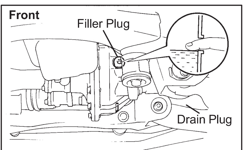

I was under the impression that the diff drop actually improved the working angle of the cv's. I figured any sort of reduction in cv angle should help the that stress and wear when lifted. It appears looking thought the assembly of a diff, the angle in which the inboard shaft goes into the diff would not change whether it is stock height as compared to lifted. So reduction of oil getting splashed or bearings running dry seem to be a bit misleading.
This is the notation in the FSM to check the fluid level in the diff:
Based on your second note I am not sure how you could fill the differential lower that what is spec'd as you should fill it up to the filler plug. Right?
I know there are many opinions on this, and have read back though some of the pro/cons stated. But to base diff failure on the drop seems a little excessive when so many factors can be a contributing factor: Age and miles on vehicle, driving style, weather, lack of maintenance.

You notice that the fill hole is in the front of the diff.
Imagine it lower by one inch.
How can you fill the oil back up to the one inch mark to make it at the right level?
