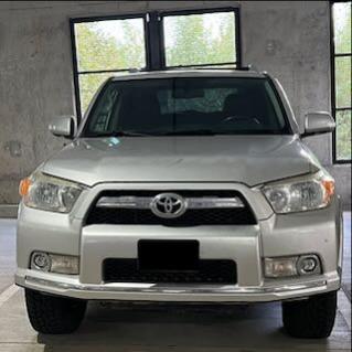

I trimmed my front bumper on my 2011. I didn't do an angled cut like the sso cuts on the newer front end, but i cut along the bottom of the bumper and took off a good 2+ inches of bumper i believe. Not sure if its obvious, but if you compare it to a stock sr5/limited front end you can tell
Do you have more info on how you did this ? I have a 2011 that I am trying to do the same thing

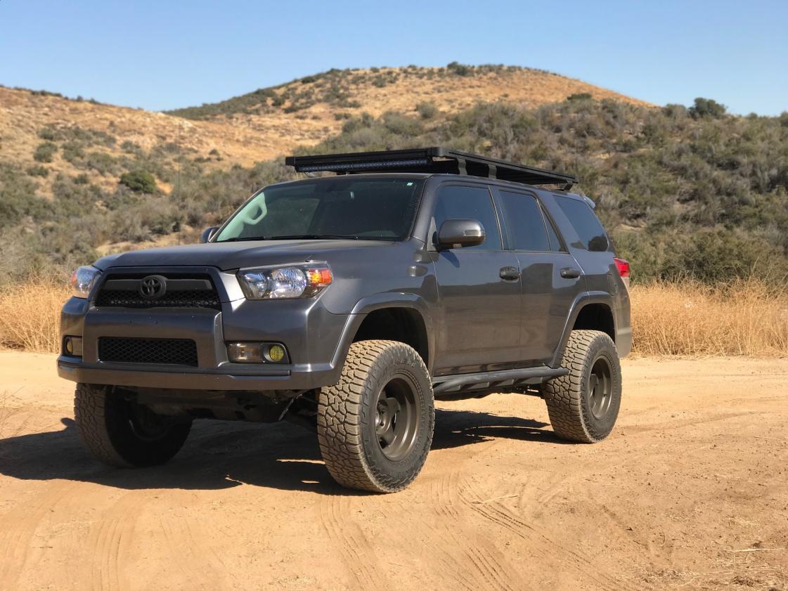

I recently chopped off the bottom few inches of my limited bumper as well. I masked off the line I was going to cut with masking tape, then used a dremel with a reinforced cutting wheel + a pocket knife to cut through it. I finished it off with "Universal Car Door Guards Rubber U Shape Edge Trim Protection Strip" from Amazon.
You will need to cut the inner fender liners as well since they now extend below past the bumper. I found it easiest to cut with a sharp blade. To prevent the inner fender liners from flapping around, I also made sure to leave the part that sticks out towards the bumper and zip tied it to the (now) unused bumper brackets that are attached to the bottom of the bumper crash bar.
