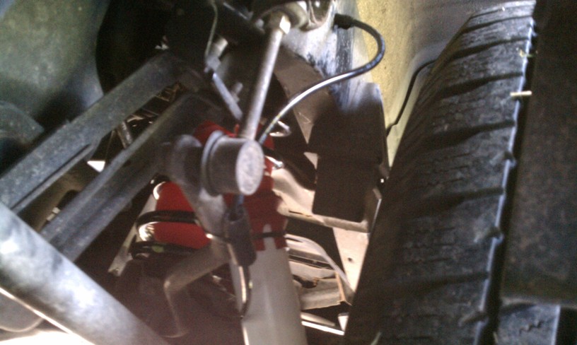

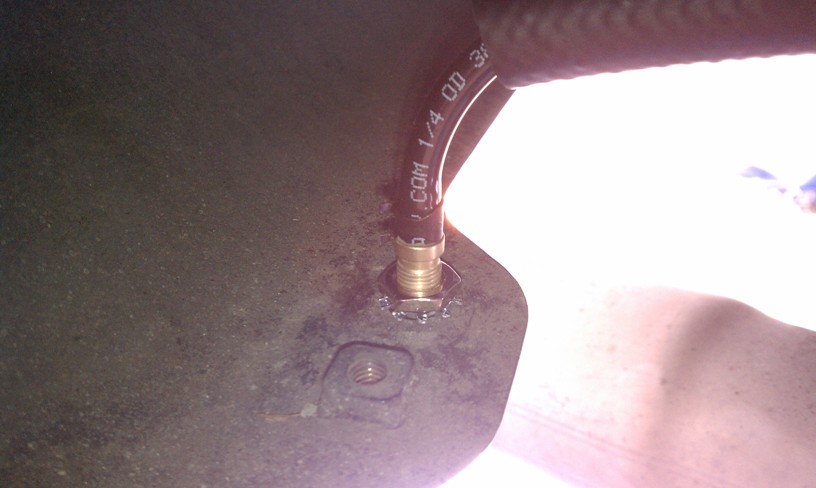

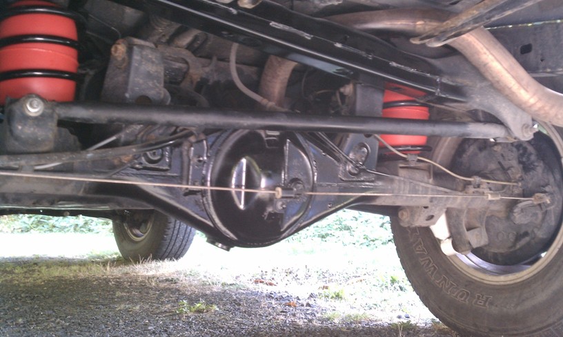

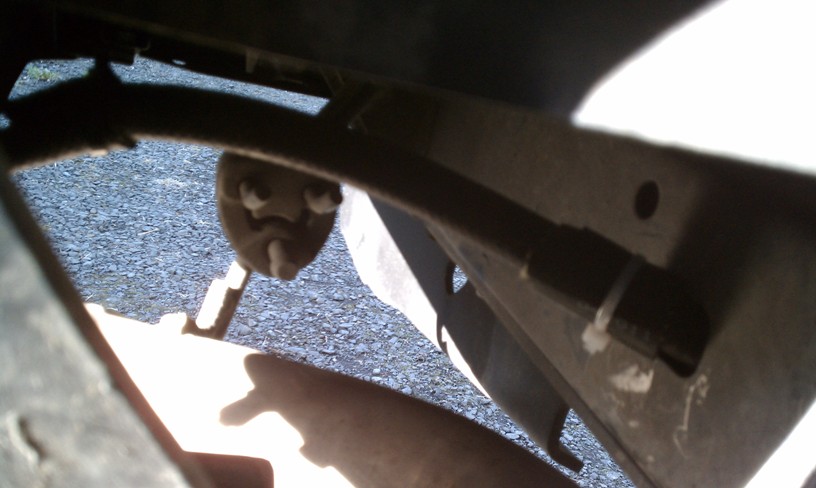

I then put in the Airlift 1000 airbags.

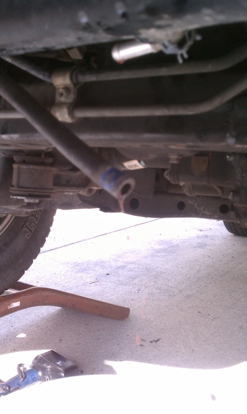

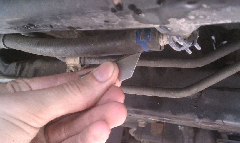

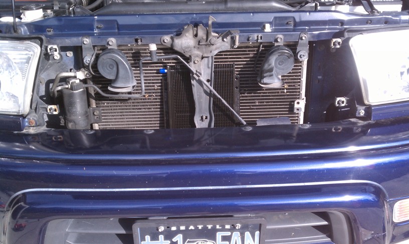

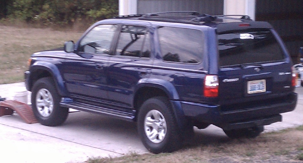

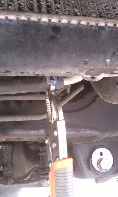

Here are some pics from the 70268 install and reaching 100k (on the highway)
I hope to have her for 100k more.:trophy:

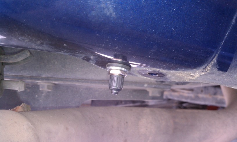

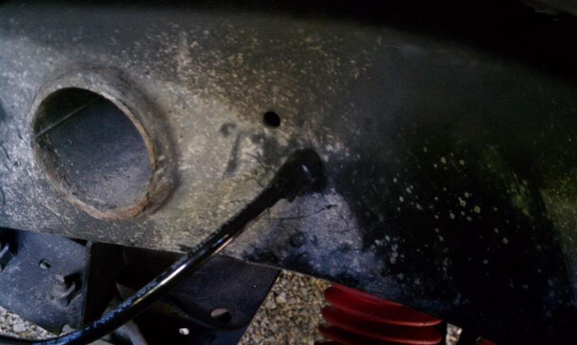

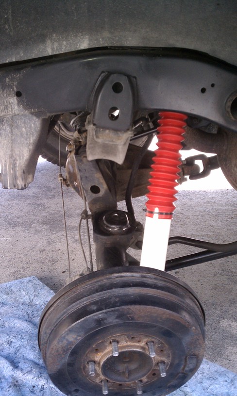

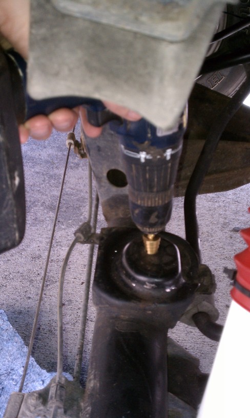

The airbags took about 2 hours to install. The above pic is with 20 psi in each. I test ran them and found 8 psi to be a good no-load pressure to maintain a comfortable ride.

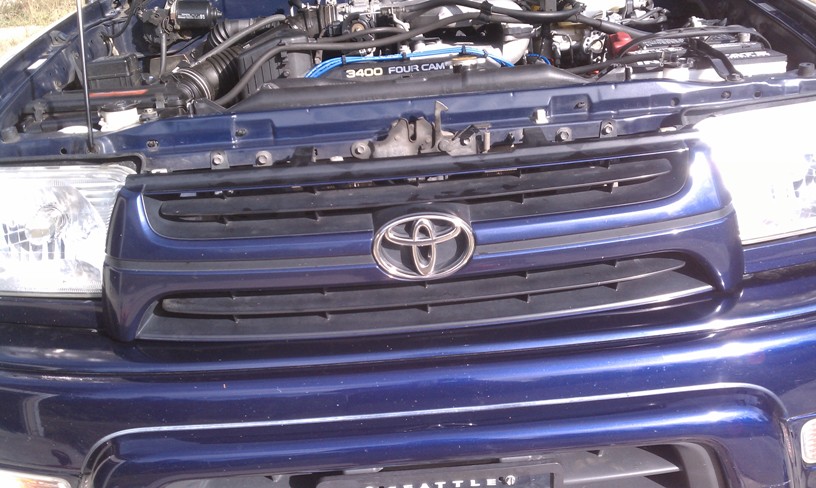

The B&M 70268 transmission cooler install took me 4 hours but most was due to finding a good location for the cooler and double wrapping all hose in any rub spots. I put it near the middle of the radiator between the A/C compressor hose and the radiator. The hose clamps were a pain to get tightened. I'm 6' 8" and have large hands. The tight work area let me cursing and nicked up. But no milkshake for me.:cheers: Overall, it wasn't too bad and well worth the time and $110 it cost me for the cooler and airbags.

I always have loved that color blue. I also praise ya for the ingenious use of the unibit (well worth their weight in gold) for installing the air bags. Overall, very nice.
Being 6'8", do ya need the running boards? I am 5'7", and need mine to get into my 4runner or I would have to have a rocket up the wazoo to get in.

wow that color is really nice i never seen one like that so clean

Off subject, but noticed the NGK plug wires... Those have to be the best dirrect replacement plug wires ever, was real surprised when I opened the box and installed them on my rig. Good job on the cooler, looks great.

You can barely see the top of the white deckplate on the pics of the grill/cooler mount.
