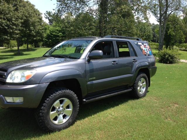

11.2 mpg avg after lift. ride height question
lmoody003
Just recently lifted and done a few little major mods to my mini tank. I added a fj coil springs on all 4s and blisten 5100s (set @ 2.5 setting) and in the rear. also picked up some new bfg MT 255s.
So my front sits at 23.8'' high and the rear is 22.4" high. So basically the front sits up about an inch higher than the rear.
So before all this i was avg 16-19 mpg consistently. Now i havent even hit 12 yet. All calculations are done by myself, not the in dash calculator.
My question is, 1) am i getting bad mpg because the front is so much higher, causeing a air aerodynamics. if so....
2) raise the rear an inch with a .5 spacer and keep front the same at 23.8...
3) set the front down to the 1.5 notch and loose a little lift.
Would either choice give me (basically) the exact same results? Im trying to sit the higher the better :usa:

Are you sure your front spring perches aren't on upside down? Looks like way too much lift with the 5100's on the 2.5" setting since you're almost 1.5" higher up front. Or I could just be imagining things...
I think he just has fj coils in the rear without a spacer; that could be why the front is that much higher. :shrug:
I thought the 2.5" setting would just get rid of the rake, while his truck is ~1.5" higher up front.
My 5100's on the 0.85" setting still have quite a bit of rake (stock springs), and I thought the FJ's had about the same amount of rake, just taller.
I believe the stock rake is around 1-1.5". The middle setting, 1.75" would be the best way to alleviate the rake with a V8, possibly being slightly nose high. With his 2.5" setting and the fj coils, he's getting about 2.75" of lift in the front with his V8. It sounds like the rear just has fj coils, netting him .5-.75". If he added a 1.5" spacer to the rear he would have a slight rake in the front but look level.
My stock springs gave/give over 2" rake, if not a bit more. It still has quite a bit of rake with the fronts on the 0.85" setting.
Someone recently posted their 4Runner after a shop installed the 5100 spring perches upside down and it had almost the same stance with heavy reverse rake. And the OP's car has roughly 3.5-4" of height added to the front to get 1.5" of reverse rake.
Anyway, it doesn't take but 5 seconds to glance at the perch and see if it's installed correctly.
I have the 5100's + fj springs in my V8 and at the .85 setting there is still some rake, but not too much and not even close to stock. I personally feel you need some rake if you do any hauling. The 1.75 setting makes it and even stance and the 2.5 will be nose high. Only time 2.5 should ever be used is if a spacer is put in the rear
