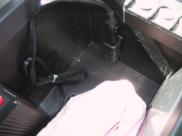

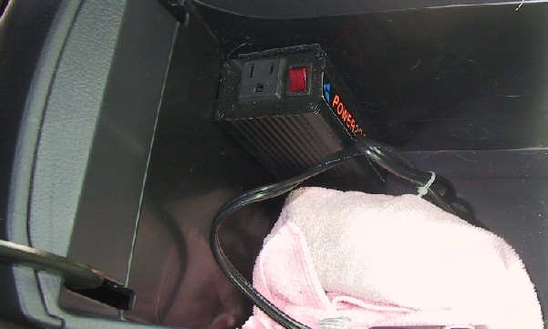

I added an inverter in the arm rest with a live wire to the batt. works great, and doesn't really take any room. Actually i wired a cig socket facing upwards in the arm rest. I velcro'd the inverter in that compartment as well. when i need the inverter, i plug it into the socket. Else, it serves to power my other 12v needs. Love it.
Now i can charge what ever i want, it is hidden in the arm rest while i'm away from the 4R, and out of site.

I'm confused about how your cig socket setup!
My arm rest's compartment doesn't have the cig socket. Does it come with the AC converter? and then how do you wire the cig socket? to where?:confused:
Thanks!

hehe...he added it. here's what he said a few posts ago:

Sorry kglueck, I still don't get it. I am real slow about this.
Tell me if I am corrected or not:
AC Converter will be plug into cig socket, then the cig socket will be connected to the 12V outlet right?
If yes, since there is no hole from arm rest's compartment to 12V outlet compartment, Rensho have to connect the wire over the top of the arm rest's compartment, then connect it to the 12V outlet.

He added the extra cig socket inside his box. You're correct, there isn't a factory hole there. Based on the picture, I don't see a wire draped over the top of the box so I think we can safely infer that he drilled/cut a hole inside the box to wire up his extra socket. Since the hole is not visible, it's probably also reasonable to assume that it's behind the socket. In all, it looks like he did this quite cleanly.
Also, he said he wired the new socket directly to the battery. It IS NOT attached to the factory socket or circuit. The factory sockets are powered only when the ACC circuit is on (i.e. key is in the ACC or ON position). His is ALWAYS on, regardless of the key position.
Given that he now has an always on socket inside his console box, he can now enable/disable his 115V inverter by simply plugging/unplugging it.
