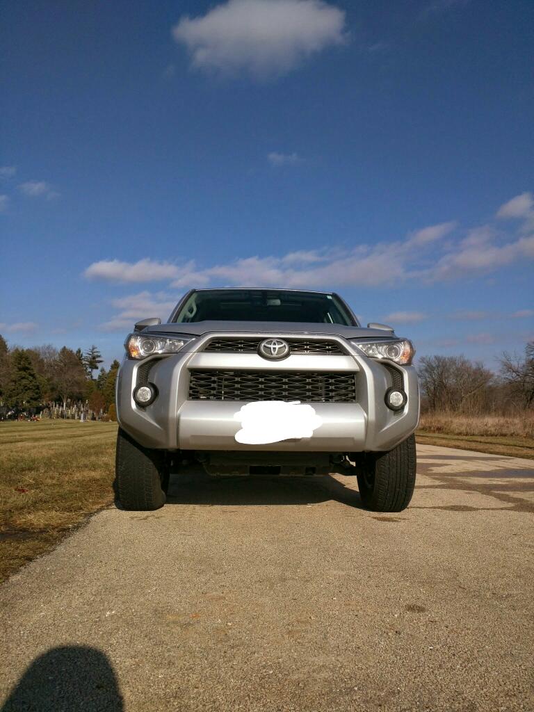

'14 SR5 lift question
govnajedi
Yes, that should get you where you want to be. From what I've gathered on here, the second notch up (~.85") should be around the same height as the TRDP.

My Toyota dealer is telling me that these Bilsteins will not give me the TRD look that I am after. They told me these are just a replacement to the stock part and provide no lift. He had to be looking at something else because it says these are adjustable.
Those should give you the height and then some if you wanted. Your parts guy must be confused with something else. The TRDP is only .5"-1" taller in the front anyway.

Do I use Bilstein part # 24-196499 for the front and set it at 1.75"?
What about the rear, can I leave the rear the way it came stock or should I use part # 33-187174?

That is entirely up to you and your wallet. You can upgrade the front without touching the rear. To me, it would be worth it to upgrade the rear shock as well though.
