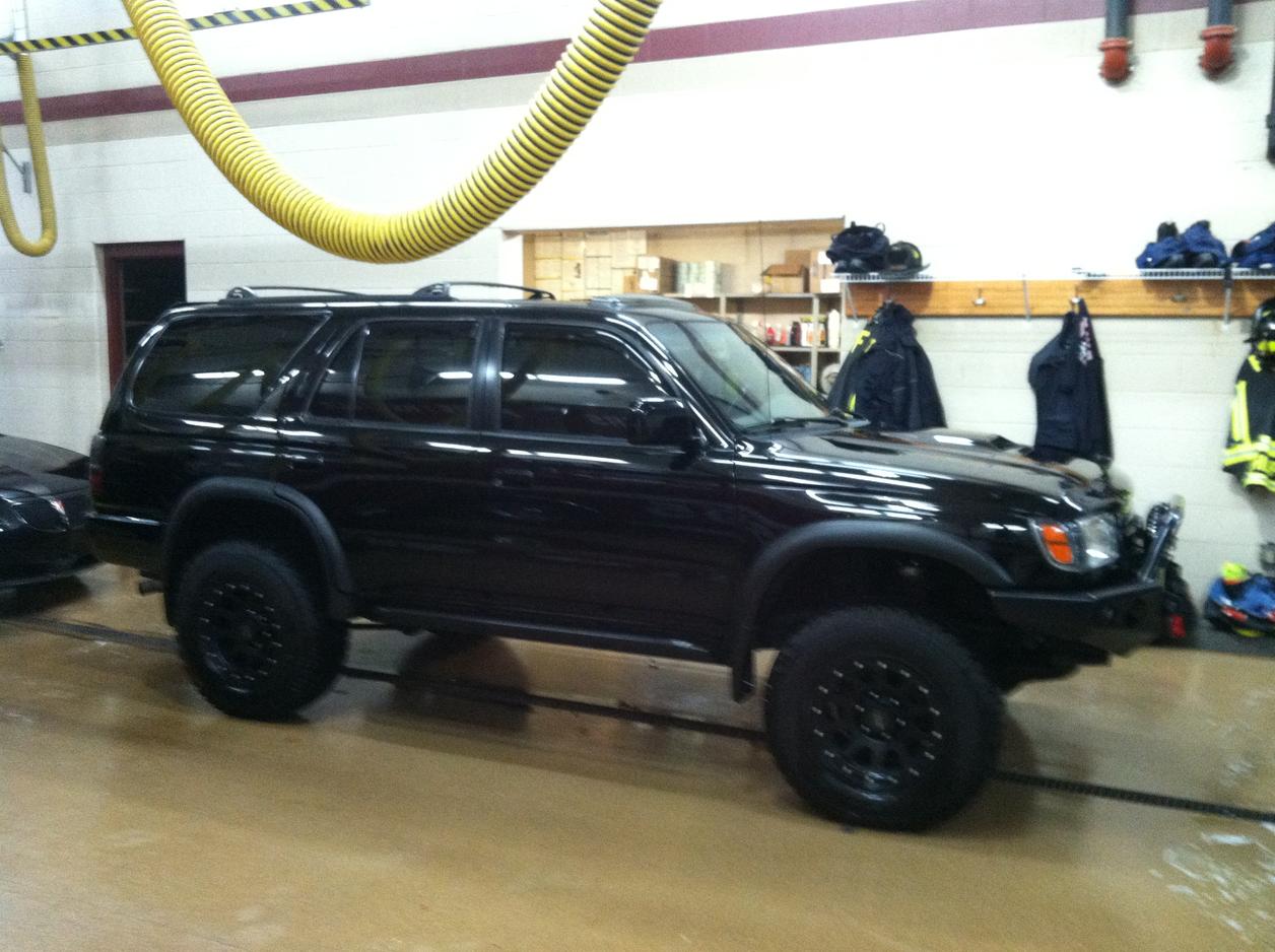

Ok back ground story,
99 well taken care of 4-runner 3.4L auto.
I just got within the last two months.
I have done all the regular maint., but Im curious if anyone can let me know if im missing something or if there is something that is prone to failure I need to keep a close eye on around this age/mileage.
Here is what has been done.
3 year old radiator,
timing belt water pump just done
transfercase and both diffs drained filled
tranny fluid
brake fluid
power steering fluid
plugs/wires.
cleaned MAF after it threw a code
Am i good or are there certain bushings etc. prone to failure?
