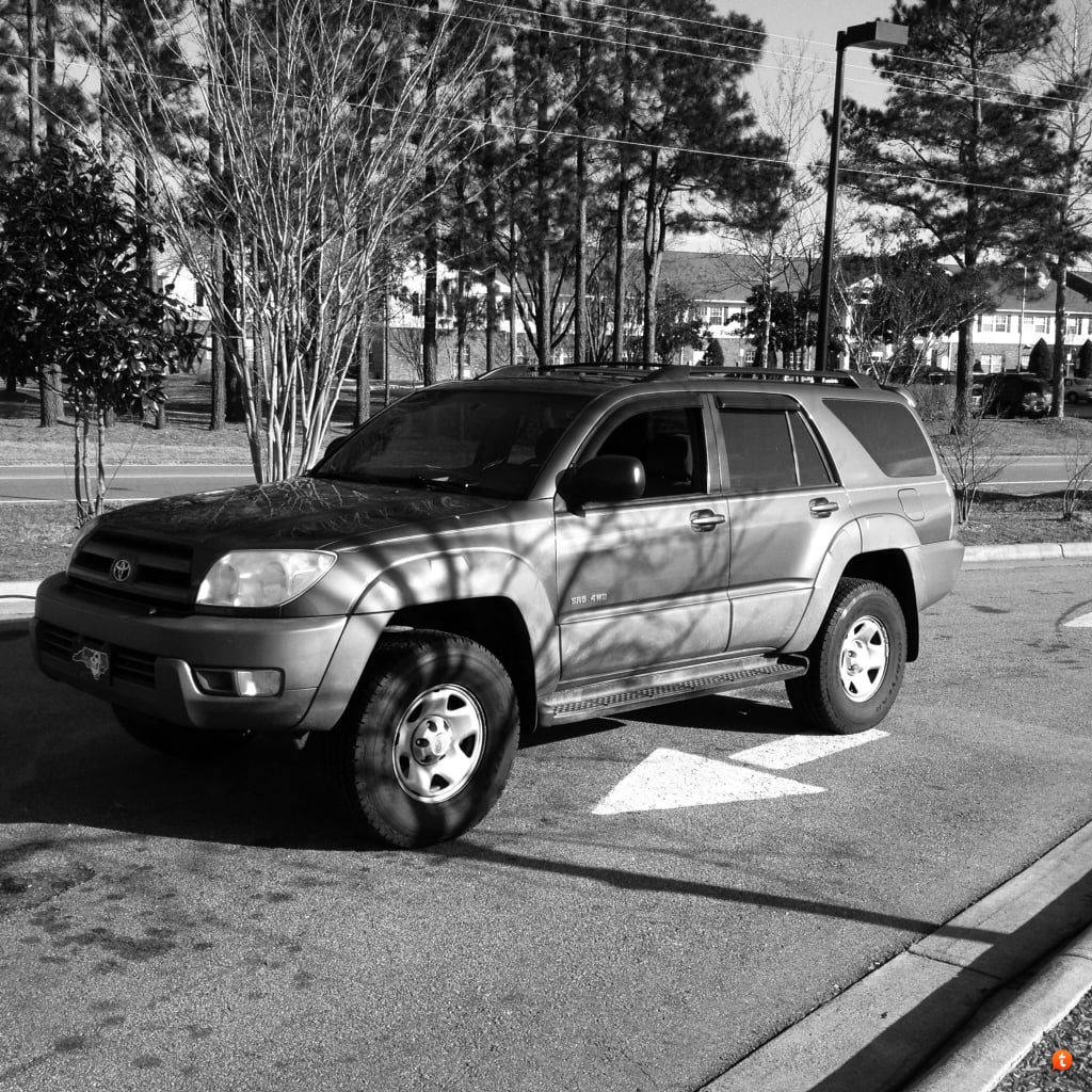

I personally am running 16" steel wheels from a 2nd gen Tacoma, that look decent, but they made me nervous when I put them on, as they barely clear the calipers on my 2003 SR5.
