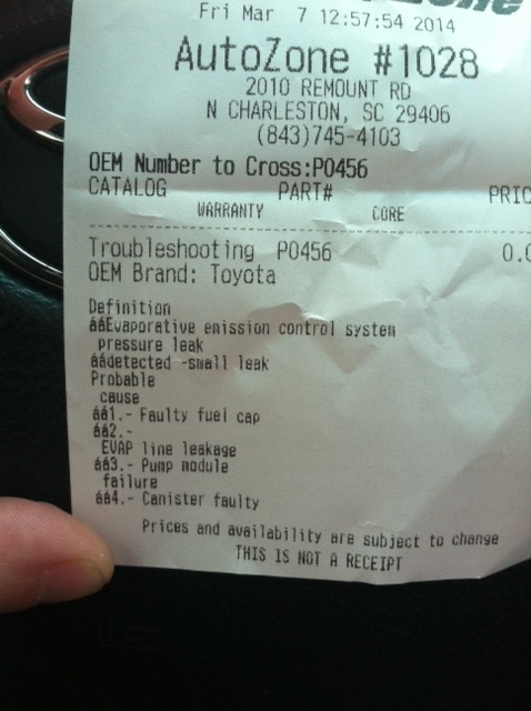

I agree with CXS, I had my traction lights and check engine light on. Just went in to Auto Zone to have the codes read and it's the suspected gas cap. I have the sulfur smell when my rear window is down, especially when accelerating or uphill, but no codes were thrown for the cats. Funk smell could be due the HP changes in the engines from '04 to '05 w/o changing the cats. Granted, can make them wear more quickly but a lot of people have experienced the smell in 05's with only 5K on em.
