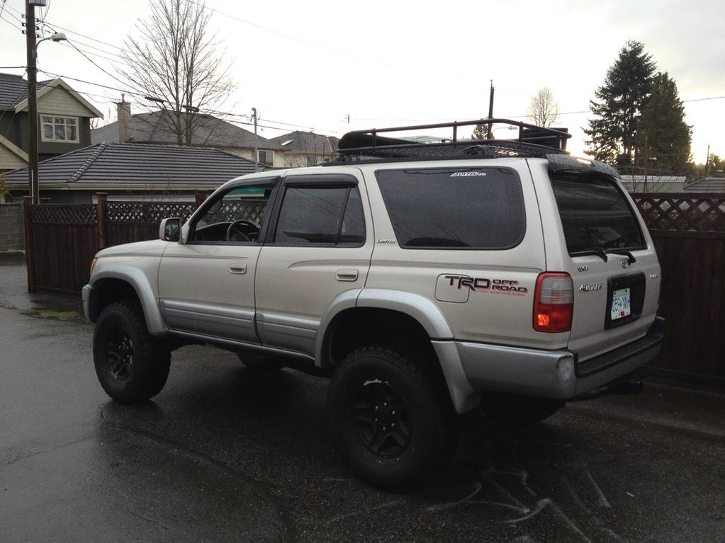

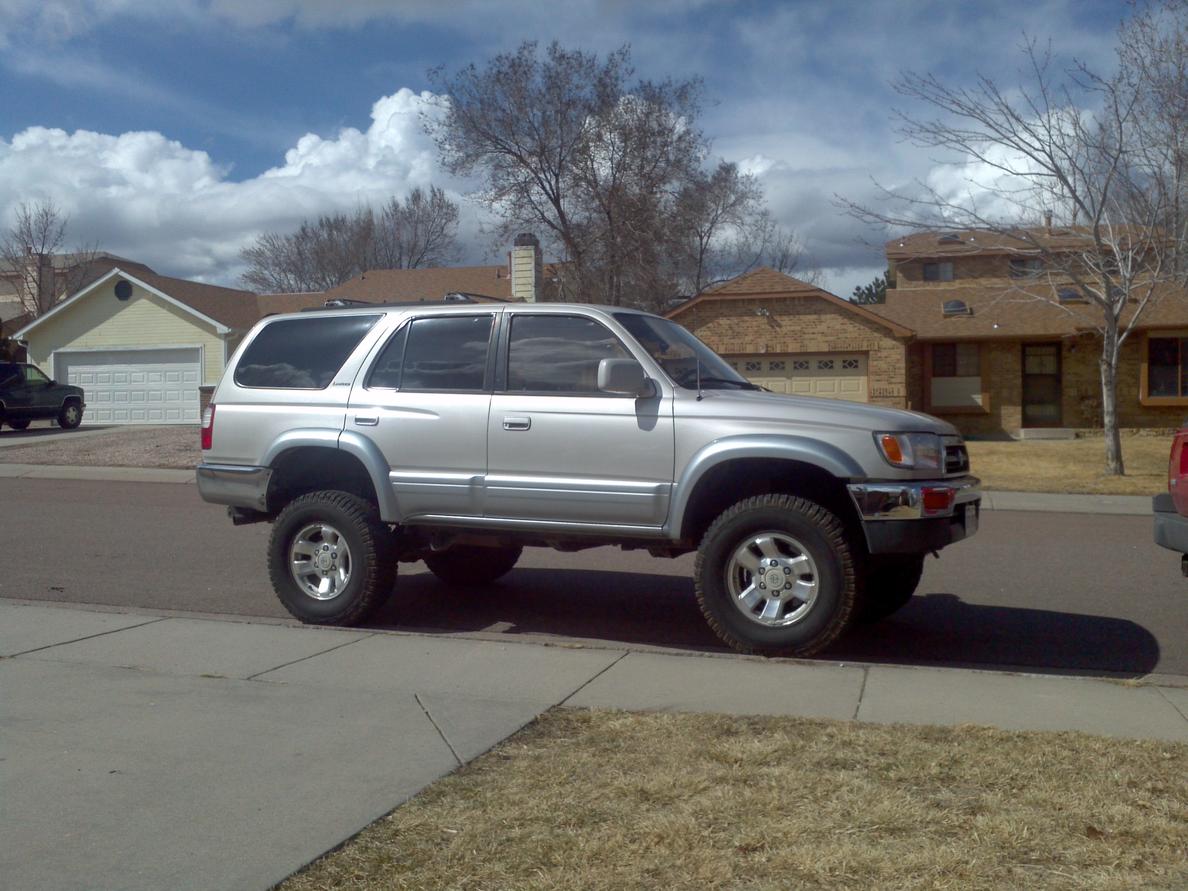

Almost all 3rd gens have 16" wheels. Search for the LC coil pic thread. Here is mine on 7 wraps and 265's. I would go with 285's, but they will require a little modification to stop rubbing at when suspension is fully worked.

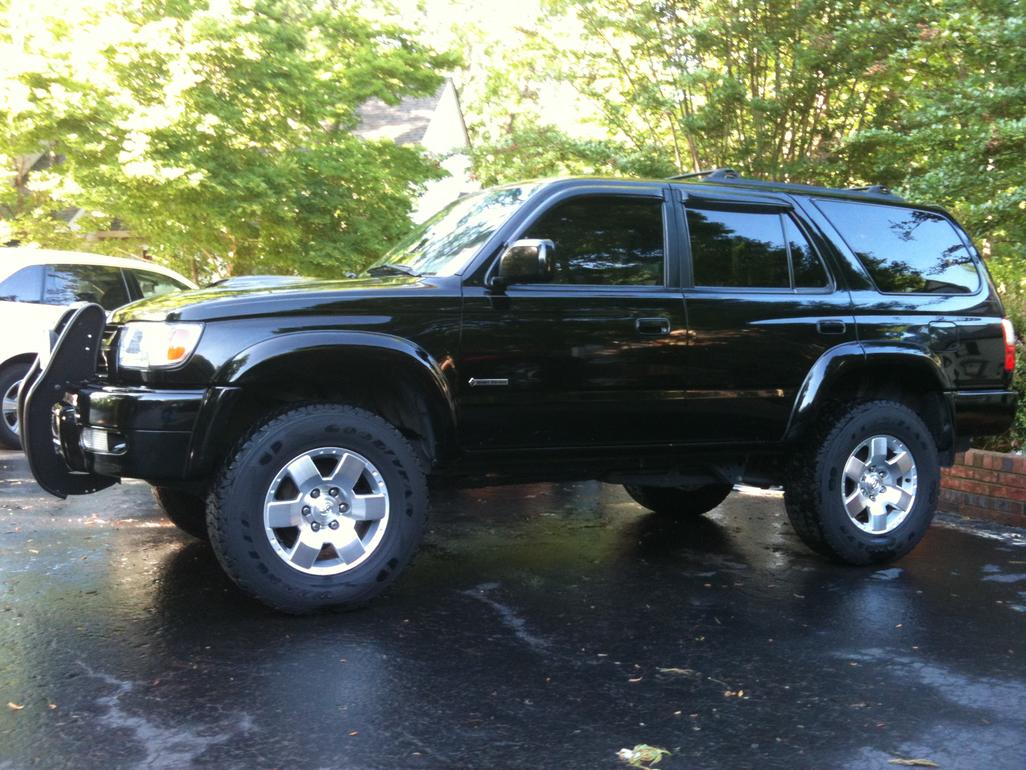

I am running 17" wheels and 255-75R17 GY Silent Armour.
3" lift OME

here is stock 16's with 285 and LC 7.5 wraps

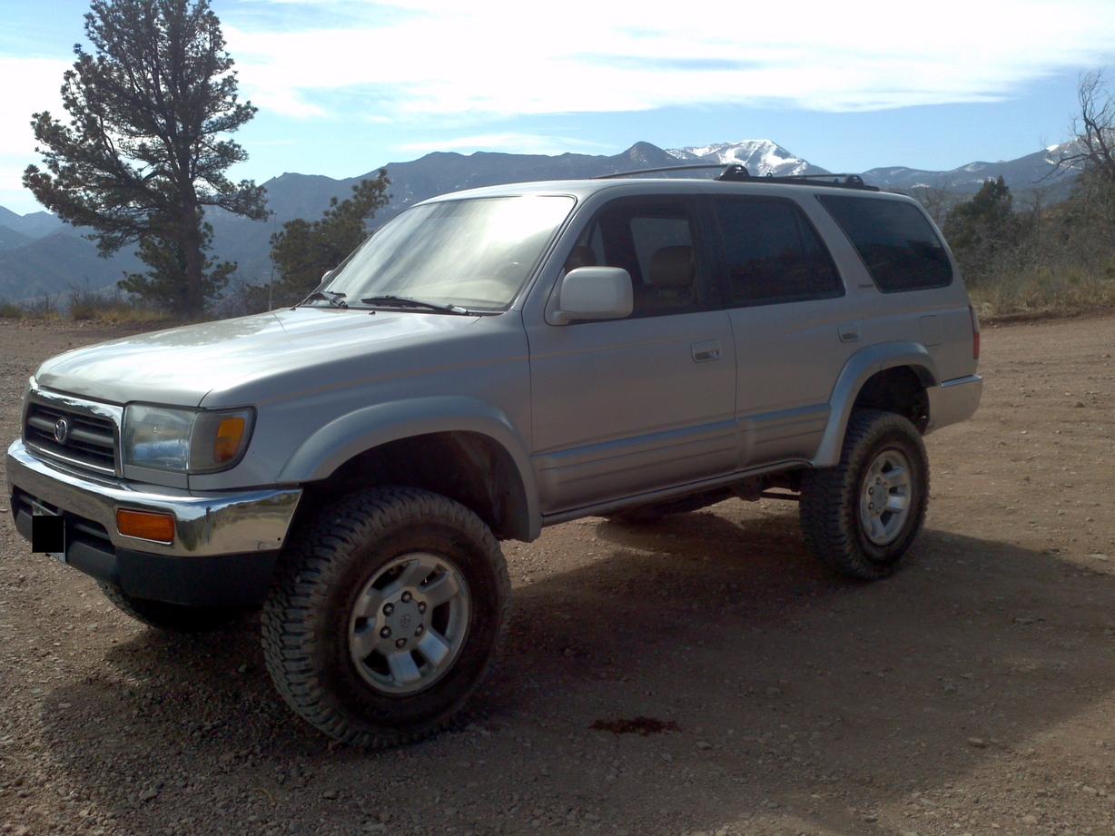

Here is mine 4" front and 5 1/4" rear (9 wraps) with 265/75r16 on 16x8

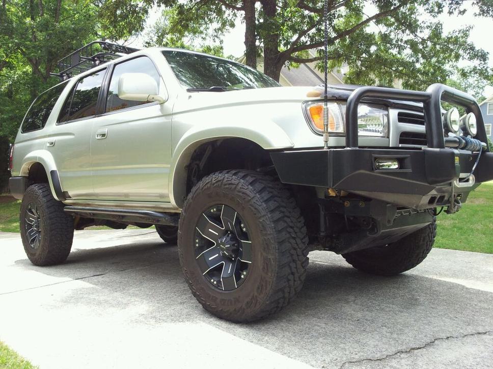

16 x 9s on 33 x 12.50s. I love them. I hate when people get 18 or 20 in rims on their runners with mud tires. I guess their bi-curious :)
