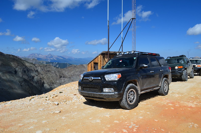

I have the SR5 wheels on my limited, a P metric tire would be softer but probably add some body roll in the corners. I have a C load LT which makes the ride almost identical and I have all the tire choices I want. Before it gets asked, no difference in gas mileage for me.
