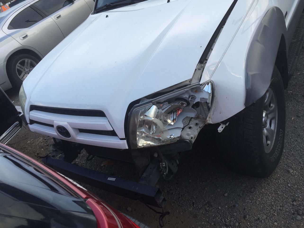

I forgot how good my 4Runner looked. This is the last time I saw it in August. :crybaby:
