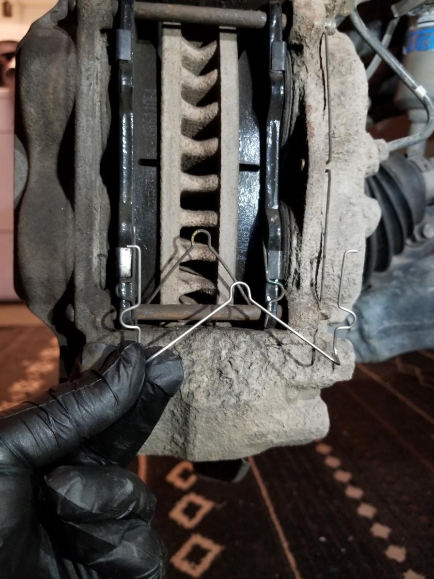

I swear it's gotta be those floating disc brakes in the front adjusting to the vehicle now moving from park (or drive) to reverse - happens EVERY time (about 4 or 5 full tire rotations into the drive). This sound KILLS me!! It sounds like a loud'ish metal on metal clank & my beautiful rig is falling apart. I read on a forum that installing another disc brake clip on the top portion of the brake pads will help "tighten" up the brakes and keep the sound to a lesser clank....but I must have ordered the wrong clip size from John Elway Toyota (evidently John Elway owns Toyota dealerships?) & the ones that came are way too big to fit in the housing.
I highly doubt that clip would have done anything anyways, but in my desparation to get rid of that nasty sound I would try anything. Anyone else experience this? If so, is it normal?? I don't know how this could pass for normal...

That is the correct clip. The clips put a lot of tension on the pads, so just remove the pin, squeeze it into place and slide the pin back through. I just completed the same process for my front pads about a month ago. I installed 4 new oem springs (top and bottom) and lubed up the pin holes on the pads with an OEM caliper grease that I found recommended on a Tacoma forum for this issue. Brakes were completely silent for the first month. Just this week I noticed a faint clank coming back. The grease is really thick but I assume it's starting to break down a little and not deadening the clank as much anymore.

For the time being, yes. The extra spring and caliper grease eliminated it initially and now just starting to barely hear it only because I'm listening closely for it. It's so quiet now, it's not an issue. It's been a month so I'm hoping it doesn't get any worse. If it keeps getting worse I will pull off the wheels and put on more grease. I attached the Tacoma TSB with the caliper grease part number. I found it on eBay for around $35.
