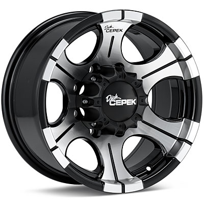

The stock rims on my 2010 4Runner TE are 17 x 7.5 with an offset of 4.5". I really like these **** Cepek wheels but, they are 17" x 9" with an offset of 4.5". What are the ramifications of running a wider wheel? Do they stick out farther?
P.S. I am running BFG AT 275-70-17s. I have no rubbing on the stock rims. Would going with wider rims cause rubbing to occur?

Yes, with the same backspacing of 4.5 inches ,they will stick out 1.5 inches from where you are now and they will be past the wheel flares about an inch. My rims are 17x8 with 4.5 inch backspacing. The fit is perfect and the tires are exactly even with the wheel well flares.
Imagine if they were 9 inches wide. They would stick out an extra inch on each side.

17x8 with 4.5" backspacing and a hub diameter of at least 106mm is the perfect fit for the 5ths.

From TireRack.com here are the specs on the **** Cepek rim.
Offset: -12mm
Backspacing: 4.56"
Bolt Pattern: 6-139
Rec. Tire Size:265/70-17
Here are the specs for your rim.
Offset: 00mm
Backspacing: 4.44"
Bolt Pattern: 6-139
Rec. Tire Size: 265/70-17

The offset of a wheel is the measurement from the center line of the wheel to the wheels mounting pad measured in millimeters. Backspacing is the measurment from the wheels mounting surface to the back edge of the wheel.

Offset - the amount of space the hub (center of the wheel) is from the midpoint of the wheel's width; example: if a wheel is 10" wide and the hub is 3" from the streetside edge of the wheel, then the offset is considered to be 2" and if you calculate it, it goes like this - the midpoint of the wheel is 10" and the hub is 3" from the streetside edge of the wheel so 5 minus 3 equals 2" and in this case the offset is a positive 2" since the hub is closer to the streetside wheel edge. if it was closer to the vehicle edge of the wheel it would be a negative offset
Backspace - this is the distance from the hub to the vehicle edge of the wheel and you get this value by taking the wheel width, dividing it in half and adding the offset if positive and subtracting the offset if negative.
