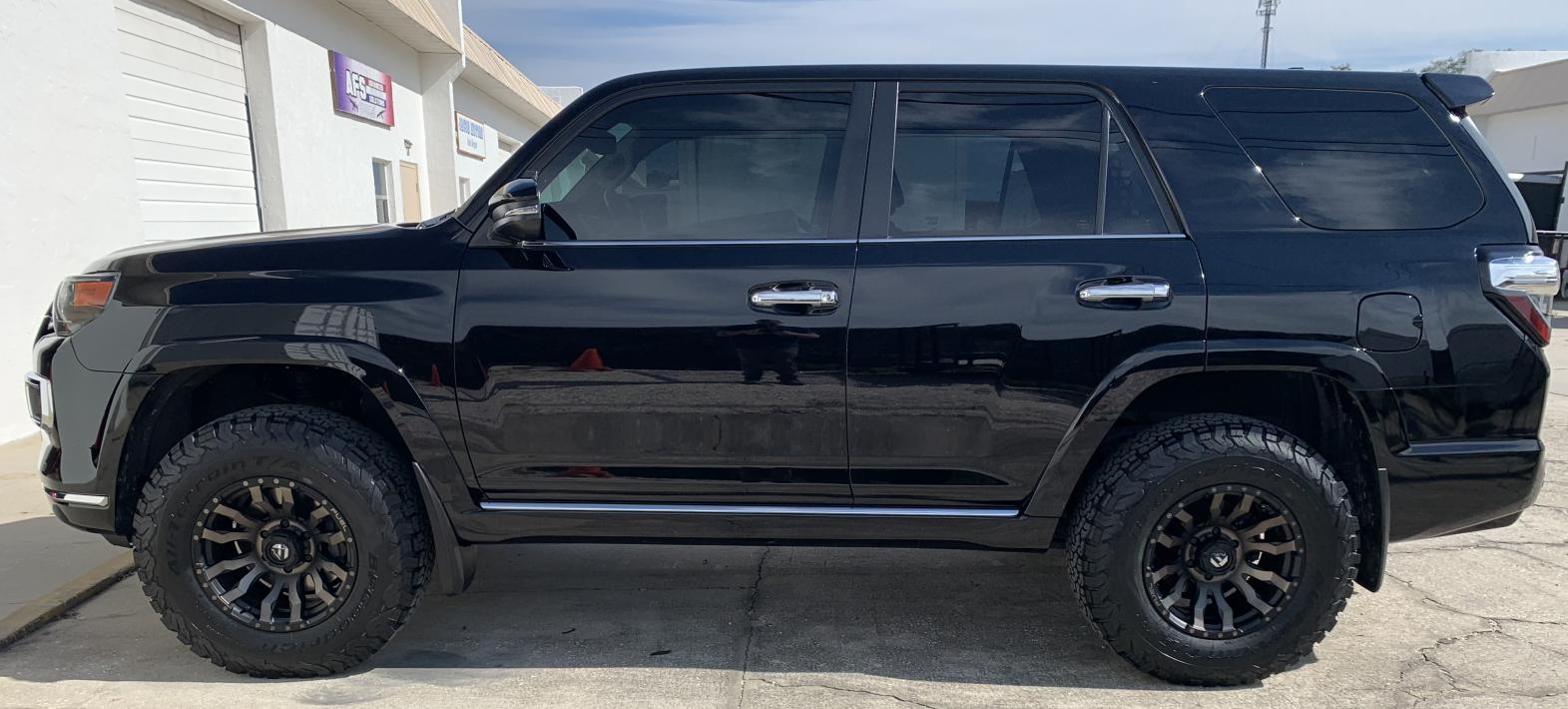

I Just put those exact wheels on this weekend in dark tint. I have a 2/1 spacer lift and went with the -12 with 285/70r17 KO2’s. After pushing the fender liner forward and slight trimming on the inside of the husky mud flaps there is no rubbing
