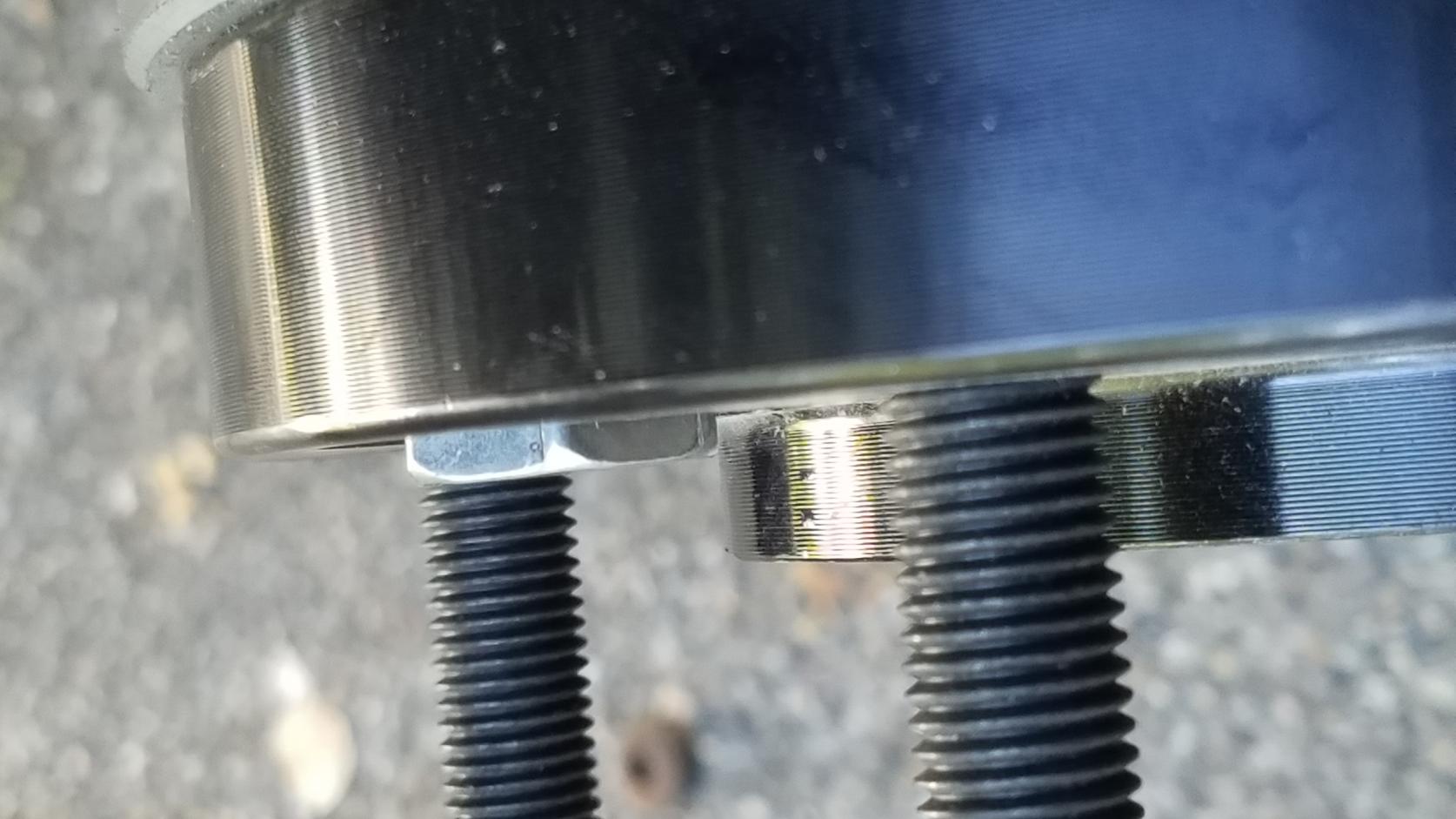

It should be stated there's a reason why Spidertrax are as big as they are
Here's what happens when they're only 1 inch thick - nut protrudes from the spacer. Actually the stud itself is too high too; doesn't stick out as far as the nut but definitely wasn't below the surface.
Yes, the wheels have to have 'pockets' between the studs (most do) to run less than probably 1.25" spacers.
