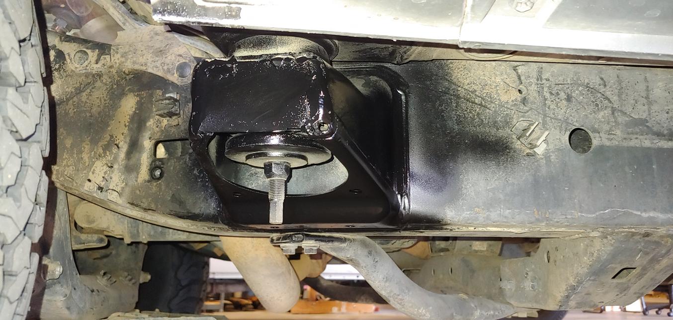

I run 17x9 -12 XD 301, first set of tires was 285-70-17, required mudflap removal for a hard stuff on stock bump stops, second set are 295's but with a custom 2" bump stop drop for 10" travel shocks, the tire still stuffs into the fender nicely with additional trimming on the rear bumper cover plastic might need a little bit more as seen here, no rubbing on the front side of the rear tire.
Pics with 295 below

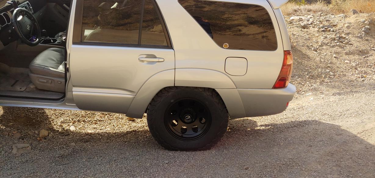

Thanks for the responses. Had the rims and tire for a couple weeks now. No complaints.
Ended up removing mudflaps in the rear. Tires stuff to factory bump stops. The front took a little work , but they fit there as well
