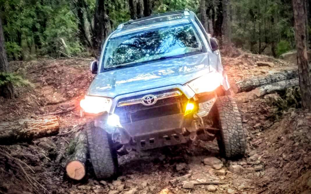

SR5 with OEM rims offset with 2" spacer= -38.8mm
Backspace of rim= 4.5" minus 2"
So with spacers you'll be about 5mm wider on each side than me with inch and a half wider rims. I obviously had to body mount chop also so you should still be good even with the spacers! Trust me it will look sick as f_ck!!
Maybe I should add a 1" spacer to get the my current look. I don't mind a little more aggressive stance like yours as long as I don't rub.
Both above comments are correct.
I went from 0 offset wheels with 1.25" spacers to -25 offset wheels without spacers.
The look is very similar in my situation. For you, you'll probably want to keep the spacers.
She's a beauty . I agree he should run spacers with new rims. You'll handle like a sports car if you ever leave the trail that is!!
