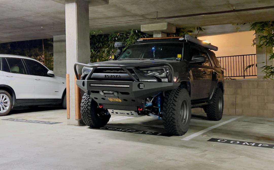

i rather go taller than fatter.
Have you considered a skinny 34, such as 285/75r17?
That is the size i currently run and am loving this size.
Here is mine w/ -38 offset wheels.
Taller is definitely better than wider. If you go with a 0 offset, I have seen some folks fit a 295 with just some minor trimming. With a -38 (or -28 with Pro Wheels +1.25" spacer), you'll need a BMC and significant trimming.
