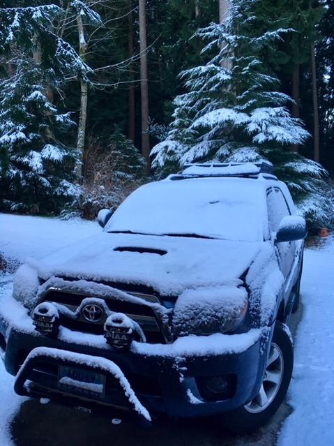

I have 150 on my'07 now and repairs have been confined to XREAS replacement, window seals, tailgate auto handle and 3rd brake light. It can depend quite a bit on your location, your driving and the vehicle itself. I think that our 07's were the last model made entirely in Japan so that's a blessing. Your repairs now can be done by a qualified mechanic so I would seek out a reputable one and have them do the repairs for probably half the cost. Many of our vehicles last >300k so I plan to hang on to mine for some time. My choice will most likely be to pick uo a smaller commute car and keep the Runner for fun in the snow and transport of the stuff of life.
