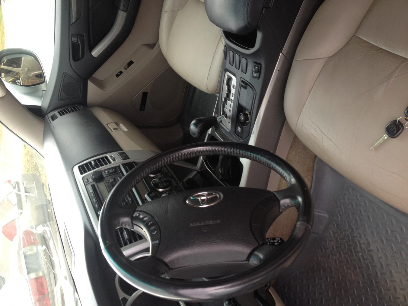

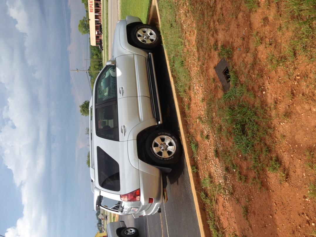

I am buying a 2003 T4R Limited it has 197k miles on it, drives great and looks better its the car of my dreams.. What do I need to be looking for before I buy it and then what maint needs to be done when I do get it?

Other than that, same as any car I guess. Make sure you test drive it (high speed and low speed). Looks like it comes with some sweet all-weather mats too. Enjoy!
