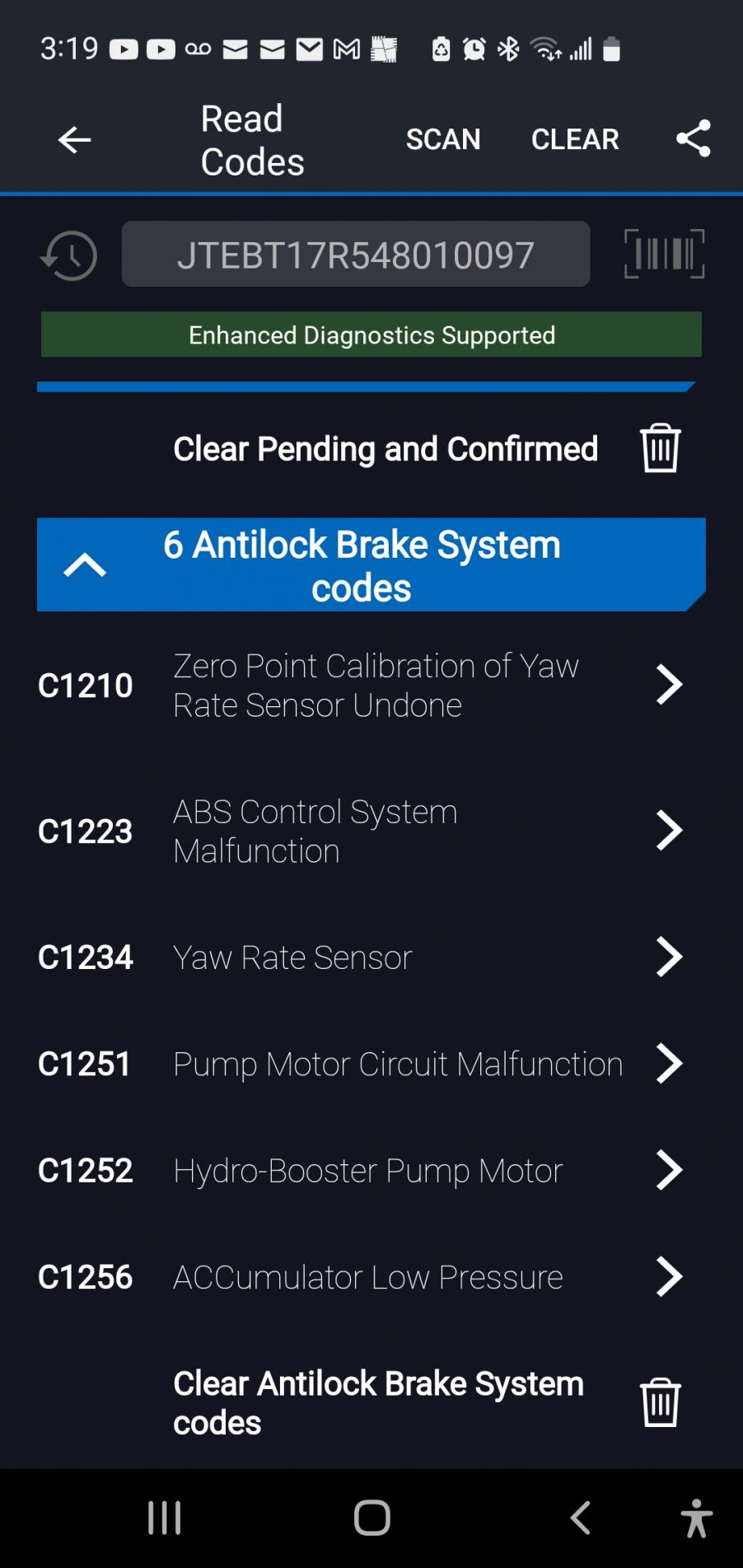

My '04 is doing something similar but worse. This morning I started it and the ABS, VSC TRAC, TRAC OFF lights all on as well as a high pitched constant alarm that never stops.
Brakes are almost unresponsive and pedal goes to the floor. Scanned the ABS codes and got all this... in pic. Any ideas on where to start? Came outta nowhere was driving fine...
I had the same thing happen, the cure for me was to replace the ABS/master cylinder assembly, very expensive just for the assembly, but I installed it myself so saved on the labor.
It's most likely only the little electric motor that drives the pump that has gone bad and now there's no pressure to power the ABS and power brakes assist, it could also be the pump itself and or the accumulator, you can buy refurbished motor for around $300 to $500, or you can buy a new OEM motor/pump/accumulator assembly for around $700 to $800, but you could also have an issue with the master cylinder and or the ABS module, there's no way that I know of to test any of these, you can only throw parts at it until it works correctly.
I choose to replace the entire assembly which cost me after shipping $1500, I only have this one vehicle and needed it fixed FAST I didn't have time to throw parts at it, also you have to remove the entire assembly to replace any of the aforementioned parts and I didn't want to have to remove it more than once, so I choose to go all in and get the entire assembly to get it fixed in one day, luckily mine was acting up sporadically, one day it was fine the next day maybe not, but it would sometimes start working and building up pressure within a few minute of running, so I was able to order the part, the day I got the part delivered it stopped working all together, luckily it was on a Friday, I drove the last few miles home from work with no brakes and had to use downshifting and the parking brake to slow down and stop, I installed the new assembly the next day, worked like new, the install wasn't all that bad if you can do basic to moderate mechanical work and will save you the cost of labor which could be as high as maybe $500 to $800.

I got mine from Toyota Parts Deal, the only thing is you will need a helper to maybe hold the assembly in place while you get the nuts started under the dash, and for sure to work the pedal to bleed the master cylinder after the install, I didn't need to bleed any of the calipers, just at the lines going into the master cylinder, it's possible that if any air gets into the ABS portion of the assembly you may need a scanner to open the ABS valves to get that air out but I didn't experience any problems on my install, I did/do have a scanner that can do that if I needed it, but if you have any issues after your install just take to a local mechanic or dealer to have them bleed the brakes, but I don't foresee you having that issue since that part of the system shouldn't get any air into it as long as you don't press the brake pedal before filling the new master cylinder with fluid.

What AU said. AU likes complete assembly replacement which is the right choice. However, some diagnosing can save major coin. Pedal going to the floor is likely master cylinder problem which caused hydro-pump to run excessively. You could have a major leak in the lines from the accident repair so inspect the lines and eliminate air in the lines first. Fix if needed. Crack the lines going to the module and pump the brake pedal. If the pedal hardens, MC might be OK. If MC is bad, assembly replacement is best option. I don't know what the fail safe modes are for completely dry valve block but there is a slight chance the computer has shut off pump from no fluid detected. If this is the case, pump might be OK. If pump motor is bad, pump and accumulator can be replaced separately.
When my brakes failed, I replaced pump and accumulator from a 2004 Lexus GS for about $60. I tested the pump motor at the junkyard with 12V and it sounded good. No special tools needed to remove hydro-boost assembly. Don't laugh, the hardest part for me was reinstalling the cotter pin for the brake pedal. I was able to bleed the valve block without special diagnostic computer. With assembly re-installed and lines in place, press brake pedal and crack lines. (I used a tool bag to hold the pedal down.) If you have a place to safely trigger ABS and TCS events, that will get the air bubbles moving in the valve block. Repeat bleed.
