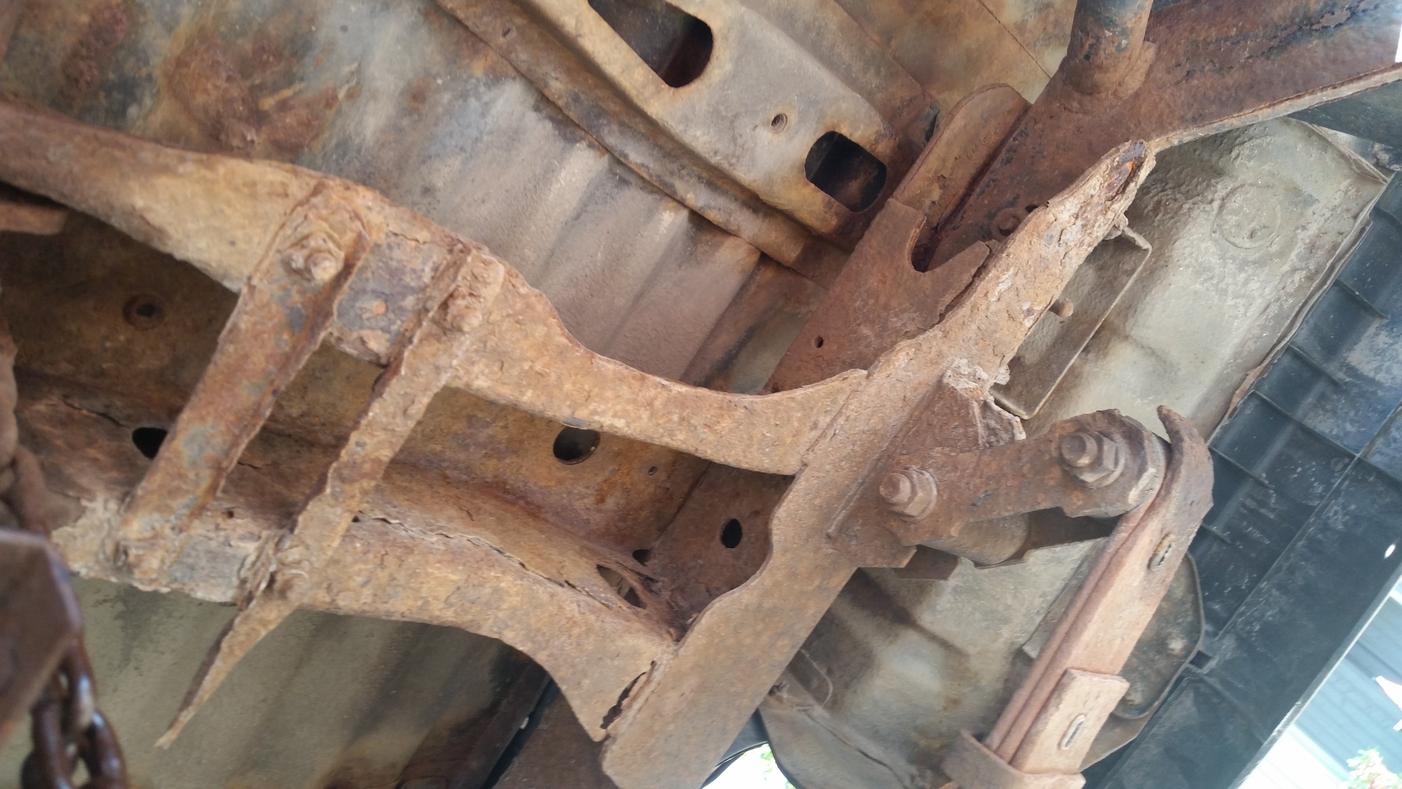

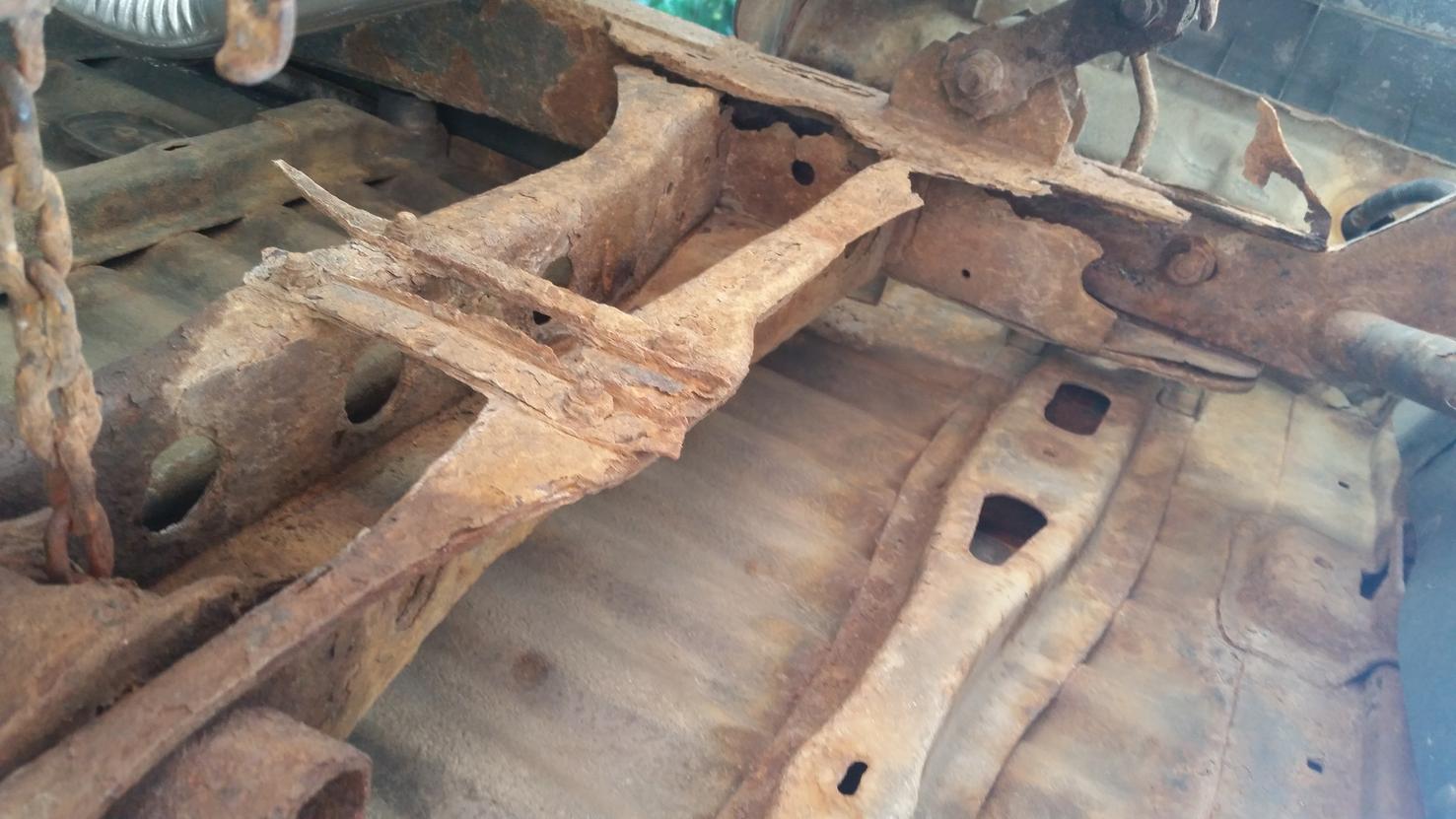

I just bought a 1985 22re 4runner for very cheap, mostly because the body is crappy and the frame is rusty. The engine seems to work great and has only 285,000 km on it, so she's just a baby. I bought this because I want to have a 22re 4runner to keep for a while and fix up a bit, I just want to know if the quote I got to fix the frame is worth the money. The frame welder I found seems legit and he's willing to rebuild and strengthen the back end shown in the pictures for 1800$, I've seen pictures of his work and it looks really nice, he's done a lot of this before. Since I only paid 1000$ for the truck it seems like 2800$ total for an '85 22re 4runner with 285,000km, with the back end of the frame rebuilt, is a pretty reasonable deal. What do you guys think? Cheers.

The rusty photos are drivers side back of leaf springs above (and upside down) and passenger side back of leaf springs below.
I think that's a horrible idea. If it's that rusty there, it'll be that rusty elsewhere.
If you want to save it, get yourself a donor with a better chassis and do a swap. You could do a frame up resto in the process. More work, MUCH better truck when you're done.
^^ I second that !!
Wow, that frame looks pretty spent.
I would salvage all usable parts, sell what you don't need, and scrap the rest. Put all those funds and usable parts into a cleaner example.
It might seem heartless, but it's better than getting over your head in a project (financially or technically) and ending up with nothing except for lost time and money.

1800 doesnt sound too bad either, depends on how through he is and how much he is replacing, my guess would be that most of that cost is labor.
Whats the frame look like up by the front of the rear spring? And the rest of the frame for that matter. Got pics of this guys work?
That's what I thought, especially since I only spent 1000 on the truck. The frame actually looks much better everywhere else and the welder I found will fabricate the new pieces to weld on and he is a certified (by ICBC) structural truck frame welder/fabricator.
