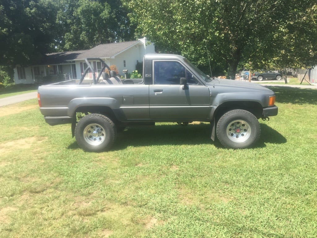

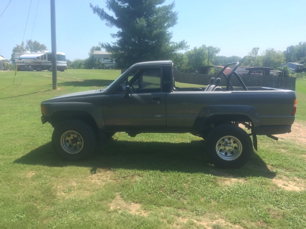

So I've been on this forum for a little while now. Just got rid of my 4th gen build and decided it was time to go back to my roots. Went and picked up a pretty good platform for a nice resto-mod (in my opinion). 1988 4Runner:

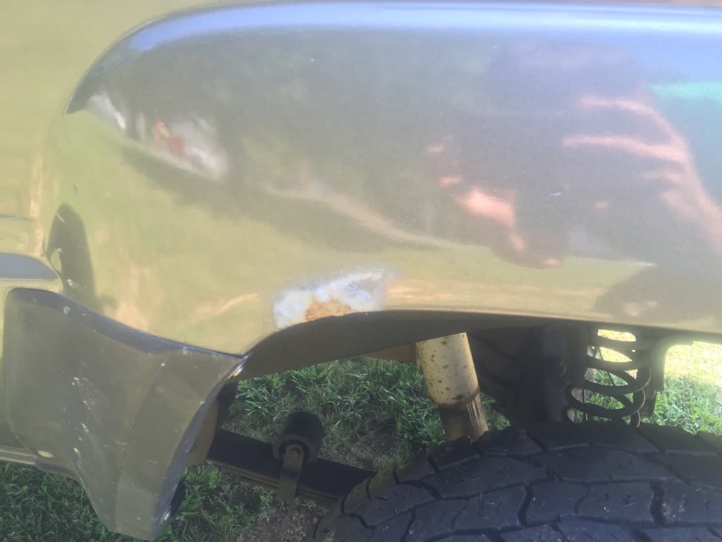

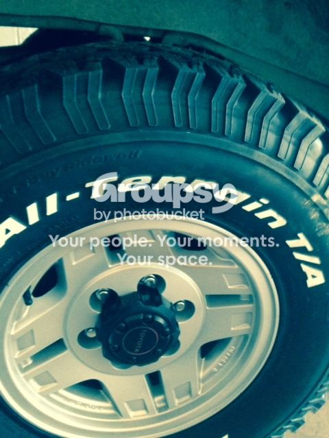

Only spot of rust on the entire truck is this quarter sized area on the wheel lip:
For some reason, unmolested first gens that are solid are very hard to come by in my area (eastern Tennessee) so it took some searching to find this one.

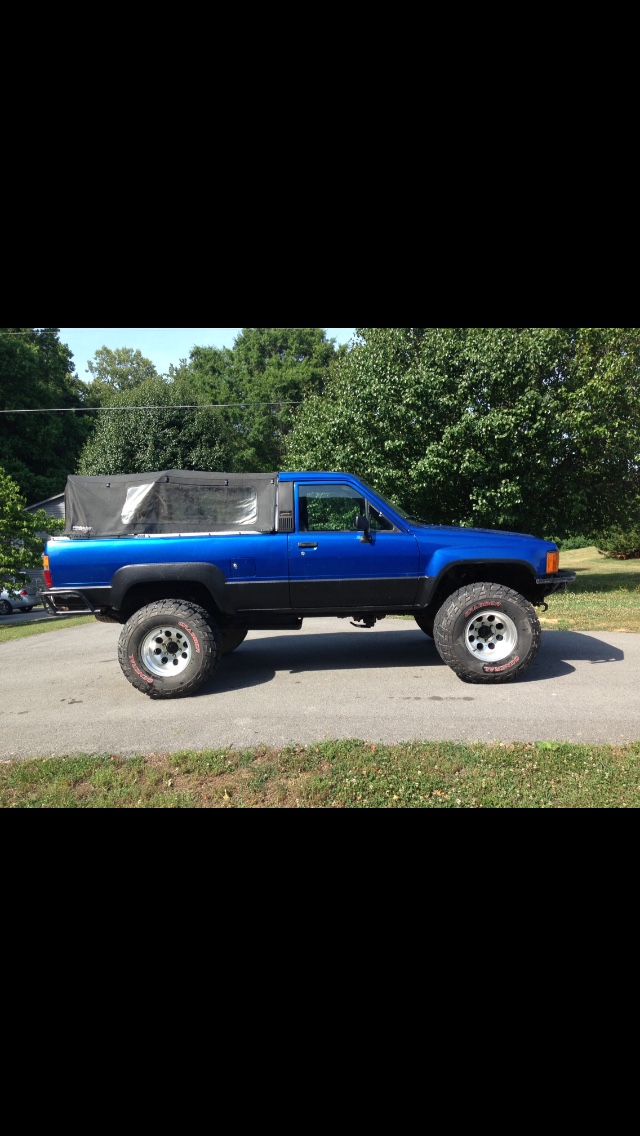

I had a 1986 first gen a few years back:
that blue turd is what hooked me on 4runners. But even after finishing my 4th gen build:

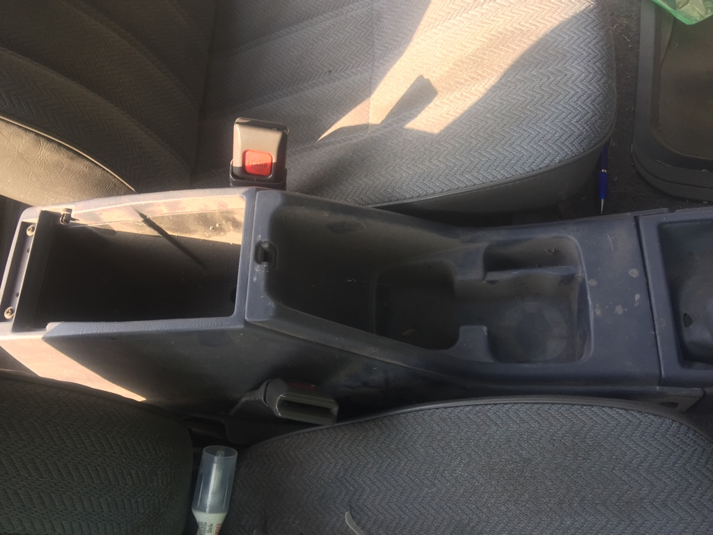

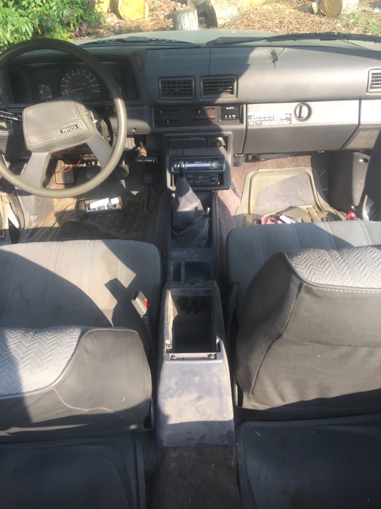

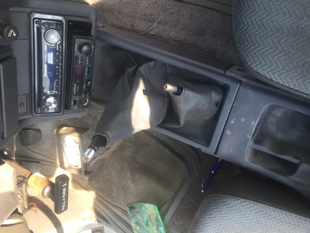

Started working on the interior a little bit today. Here's the only shot I thought to take before disassembly. I've been driving it back and forth to work for the past couple weeks to try and figure out any bugs or anything else that needs to be done to it before I start tearing into everything. But there was 28 years of dirt and sweat caked into the seats and I was just about tired of smelling the BO from the seats so I figured it was time to gut it and order a new complete carpet kit as well! Anyone have any advice as to a solution for the cracked dash? Thought about filling it with bumper filler (flexes with plastic better than bondo) and then adding some fiber glass on top of the filler and just repainting it. But I figured it would just crack again. Plus it will probably start falling apart when I try to take it out anyways. I don't think I'll find a good replacement anywhere because of how prone they are to cracking. Would a dash pad be the only solution? Just don't quite like the way they look even after you spend hours of gluing to try and make it look factory. May be my only option though. Going to pressure wash and scrub the seats and interior this weekend and hopefully get the shaking fixed. Stay tuned!
Btw: does anyone have a factory shifter bezel? The plastic rectangular trim that goes around the trans and 4x4 shifters. I have he console, just not the piece that extends from it. If any one has one out there they would like to part with I will buy it! And I will also have these Mickey tompson 15" wheels and 31x10.50-15 tires up for sale as well! Great tread on tires.
Started mocking up my tacoma console swap before I hit the interior. Anyone interested in doing this swap, there is not one bolt hole that lines up to the factory brackets.

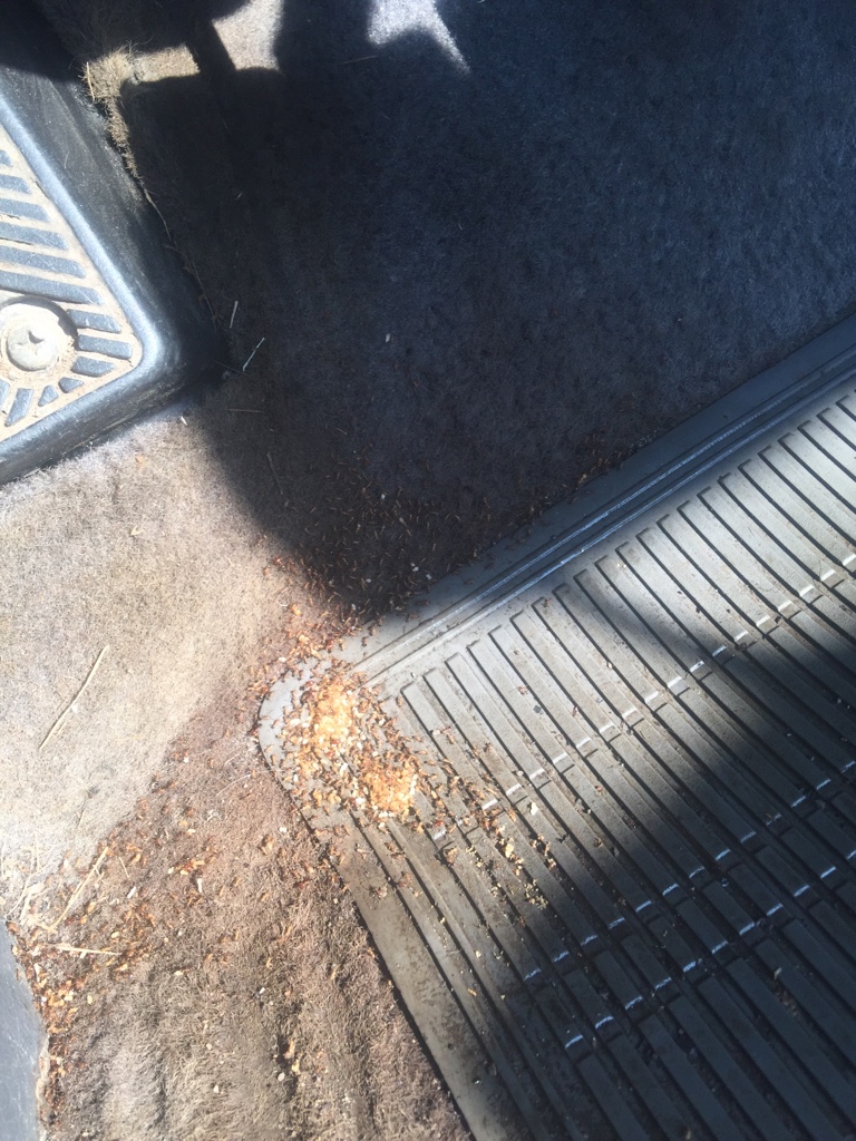

Also... Look what I found when I moved the floor mats!
