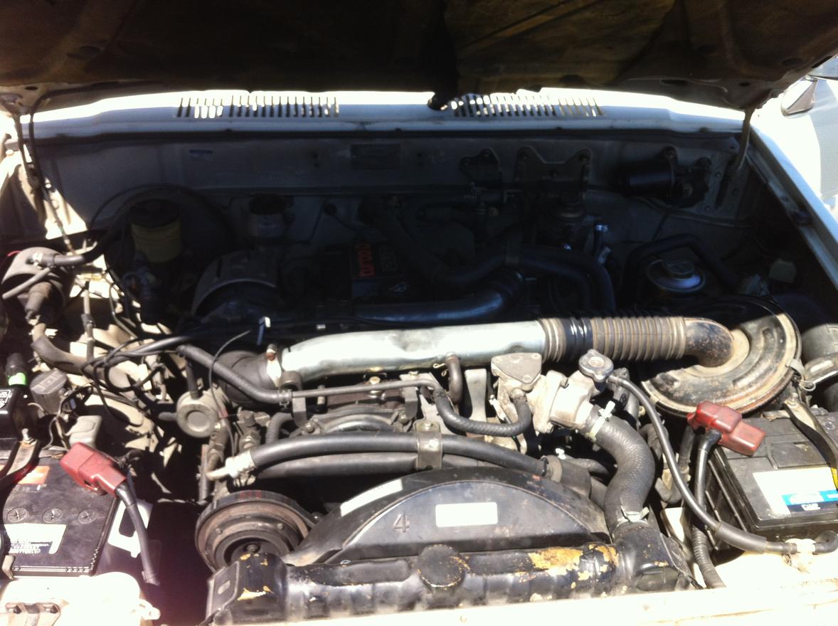

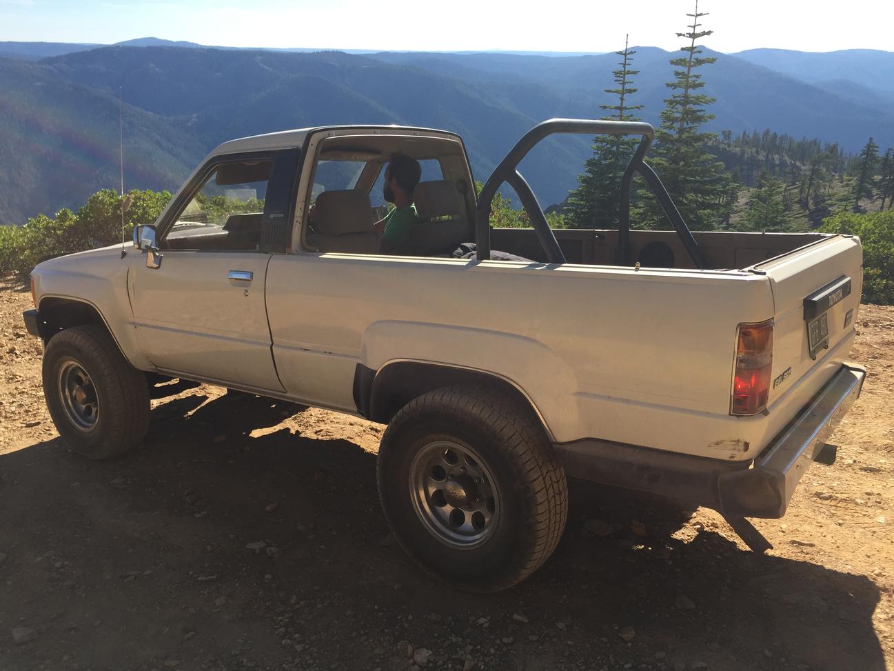

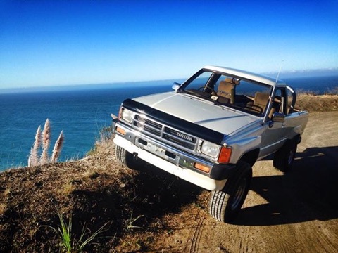

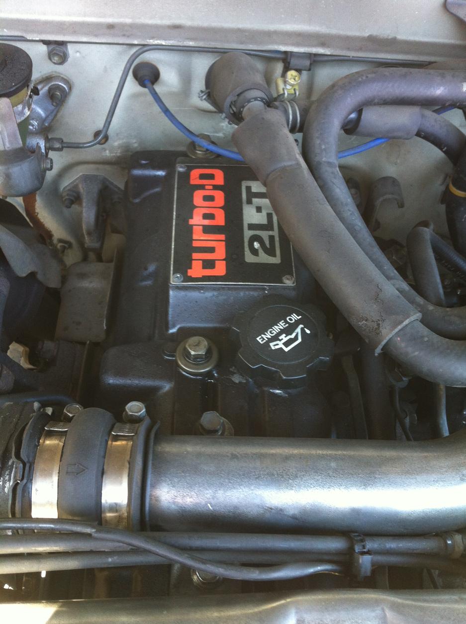

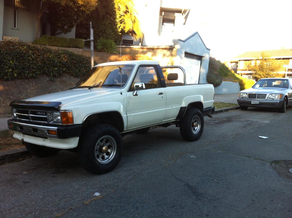

1988 LN61 4Runner RHD 2L-T 2.4L Turbo Diesel
npl420
SR5, A/C, Power Locks and Windows
The title of this post gives the skinny.
I purchased this diesel from a Japanese importer in L.A. in May 2014.
It had 182,000km on the odometer.
It's close to 188,000km now.
So far so good. I've been scouring the junk yards and replacing the cosmetics here and there as I find nice parts. It's been a fun project so far.
Engine seems to be running very strong. No leaks, tiny surface rust on the body. 30+ MPG.
