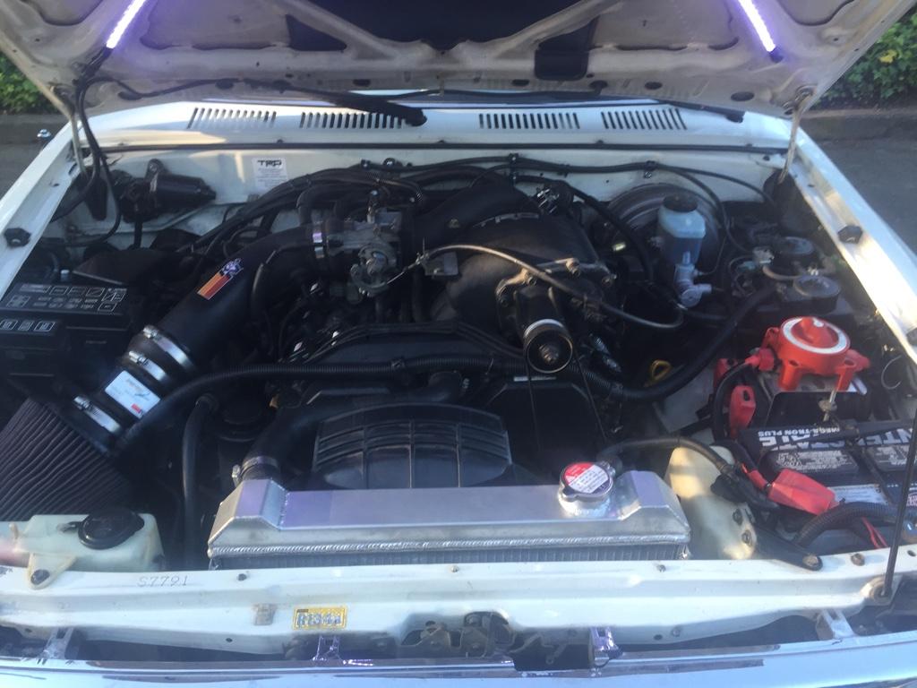

I cannot put into words the craziness of this truck with this engine. A first gen 4runner with a high revving V8, 5-speed manual, headers and a 3" Flowmaster exhaust is definitely a head-turner.
To that end....if any of you are even considering an engine swap, this is the ticket. And you're using one of Toyota's best engines in the process. This is the no-brainer swap choice in my opinion. If any of you have any questions, fire away.
Also, Don at NW Toys is the MAN!!!! His gear works, all of it! And he is always there (and quite patient with my needy self initially) to steer you in the right direction.
NW Toys! Yeah, I'm going to give Don a shout out. He is the 1uz guy. The harness you buy from him is flawless. It all works first time, zero issues. This harness is the missing link between the engine, ecm and truck. Gauges, fuel, ignition, O2 and AFR sensors, and a few other items. It's well worth the investment.
The other parts I sourced from him on this build were:
Headers, crossover/down-pipes/y-pipe, crossmember/skid plates, bellhousing, flywheel, clutch kit, engine mounts, steering coupler and fuel line kit.
I know that his shop offers swap and upgrade parts for pretty much anything Toyota or Lexus. 22re, 5vzfe, 1uz/2uz/3uz, ... but almost positive they aren't your inline 6 guys, although I am probably wrong about that.

There were four issues with fitment of the headers around everything else that had to go in the truck.
Steering shaft will not clear as stock. The 3/4 double D into the 1" sleeve hits the primary. To solve this, I cut the existing shaft 6" from the end of the spline going into the column. I went to Borgeson and purchased a 24" stick of 3/4 double D, a coupler and a 3/4 double D to 36-spline u-joint. While it doesn't collapse anymore, it works like a charm.
Fuel supply and return lines are right next to the collector flange on the passenger side. To remedy that, I bought 10 feet of Earl's high pressure fuel line, a couple of -6AN connectors, a metric banjo to -6AN at the fuel buffer, and a metric to -6 coupler to the fuel filter. I ran this all the way from the rail to the tank, where I mounted the OE screw-on filter right to the supply line on top of the tank. It screws right on as the tank supply is an inverted fitting. The existing fuel lines were removed and the new ones routed well away from the header.
The clutch slave is very close to the collector, and the line also picks up quite a bit of heat. I re-routed it, using braided hose covered in heat sleeve then a high temp insulated reflecting cover.
The last issue had to do with the driver side engine mount not being high enough to clearance the collector pipe from the A-arm pivot. The angularity that Don put into the mount is spot on, my guess is this would be a non-issue if I had a solid axle. I simply spaced the two mounts until it cleared (about 1.25"), then fabricated a spacer with holes to match the mount pads and got some longer grade 8 fasteners.

This swap was done without using a body lift, cutting the radiator support or bashing the trans tunnel. As well as not having to modify the stock shift linkage pass-through, as the trans/t-case are tucked one inch up in the rear and one inch back from stock. Also, I didn't have to modify either of the driveshafts. They both worked fine.
I am running all of the stock gauges, although the tach is still not adjusted perfectly. It still shows 400 rpm too high. The check engine light functions, I corrected initial codes for a cam position sensor and crank sensor. Now it's good. It's pretty much a stock 1uz that I resealed, had injectors cleaned, new upper gaskets, JDM non-trac throttle body and SC400 air box.
The electrical is really not that bad. I picked up a good set of wiring diagrams for both vehicles and literally removed 40% of the old 1uz harness, as well as the same from the old 3vze. Everything is plug and play, wired correctly and works. I even solved the license plate and reverse lights that never worked before.
