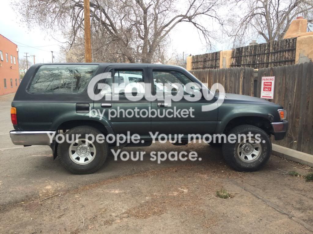

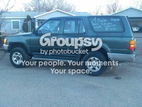

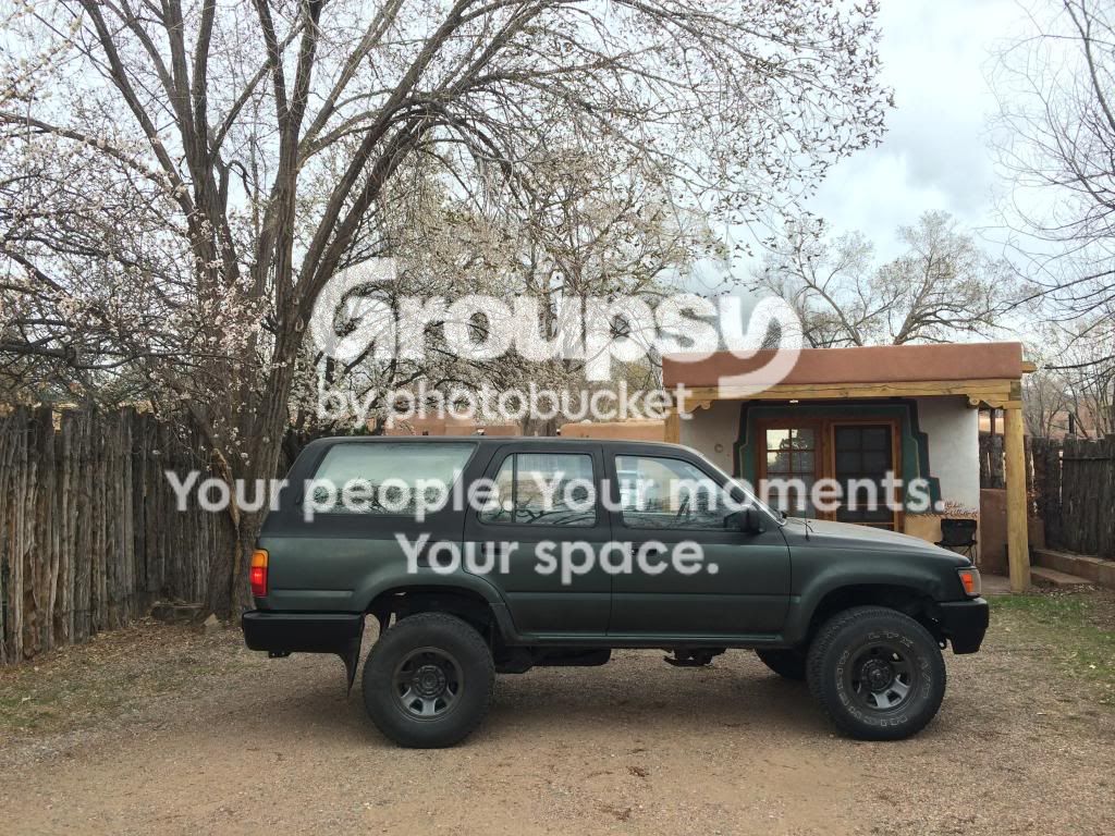

Bought her about 2 months ago, 1991 SR5, 5 speed 22RE. 180k on the clock, excellent condition interior (although not exactly matching colors), but kinda rough exterior.
Upon purchasing:
1_zps9734c84d.jpg~original

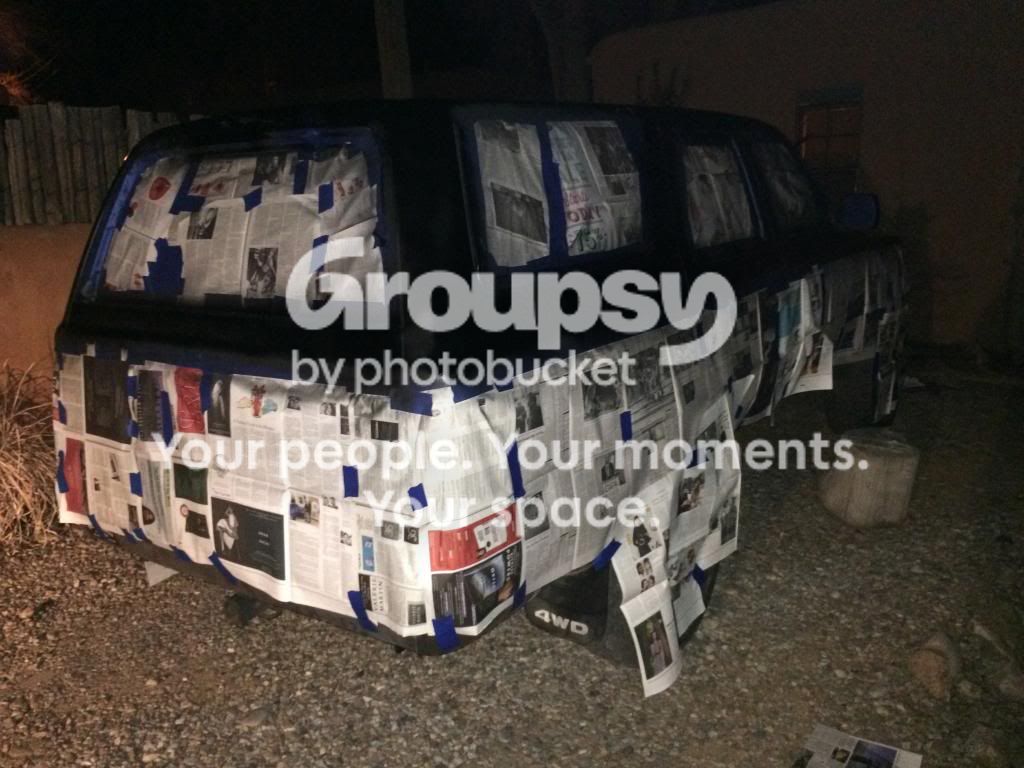

Then a little photoshopping to see how some additional paint would look...
IMG_9420_zps40106986.jpg~original

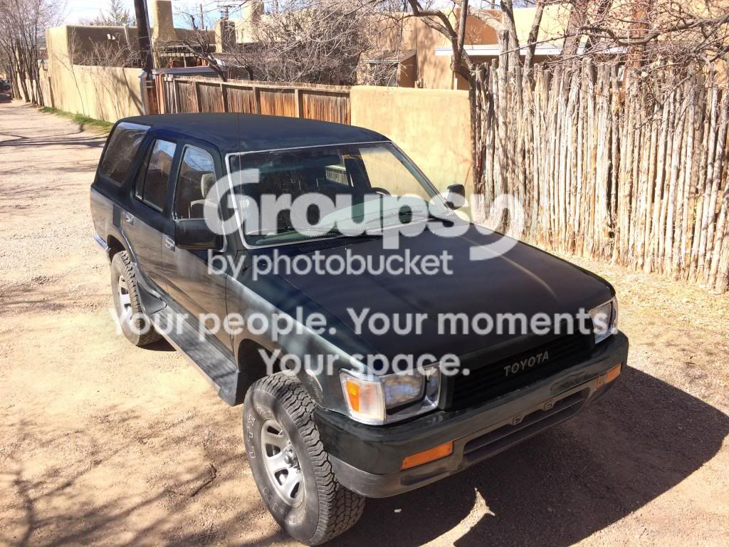

I liked this look, so proceeded with it...
5_zps112262b5.jpg~original

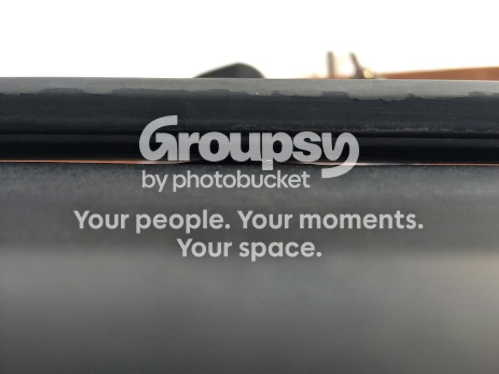

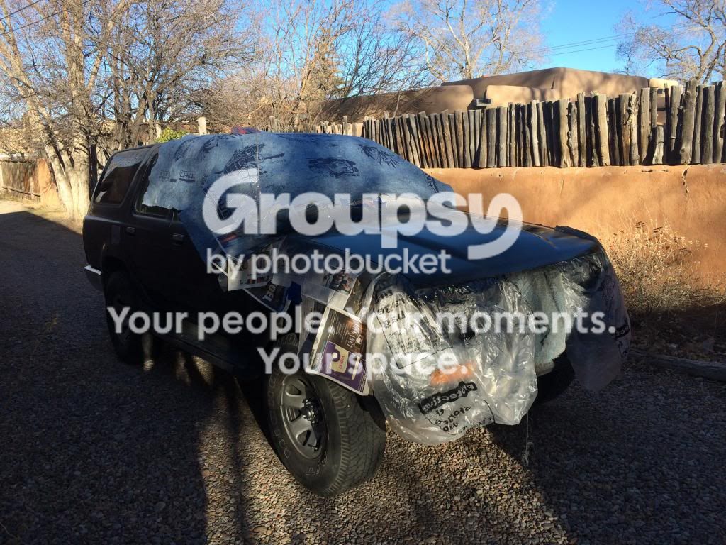

The main reason for this was to cover up a lot of the faded, chipping paint on the truck's roof, and 'haunches'. The paint on the vertical surfaces was more or less in good condition, so a design like this would cover up the problem areas while still retaining much of the original color. Used Rustoleum automotive primer with a Rustoleum satin finish on top. Spraying RainX on the Rustolem once it had dried really made the black appear rich and dark. Next step was to address any areas not covered by the new paint. Bought some Toyota touchup paint to cover any scratches.
As she sat, for a while...

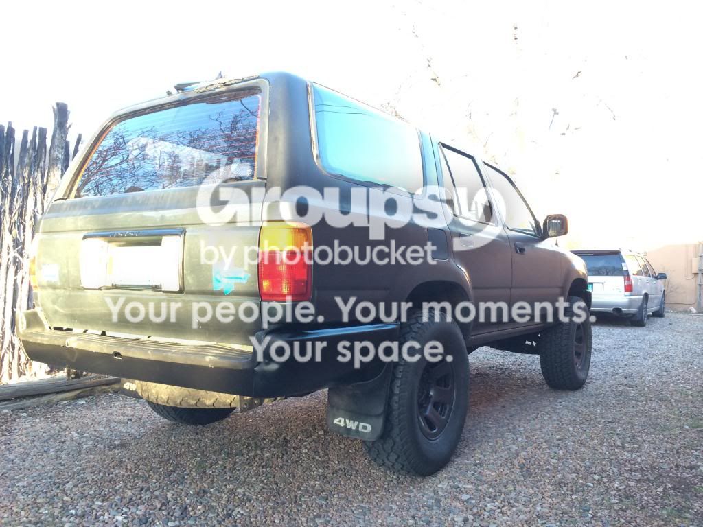

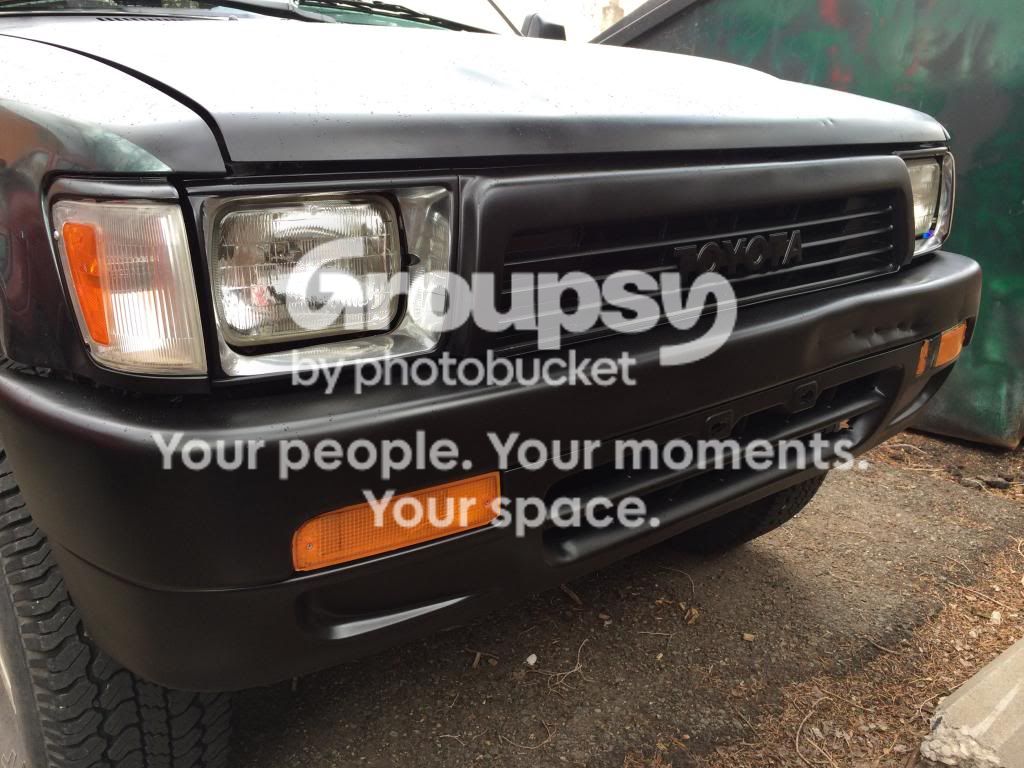

Continuing the theme onto the bumpers, mirrors, trim, wheels (Rustoleum metallic charcoal), etc...
8_zps94db5e5a.jpg~original
10_zps26658fc7.jpg~original

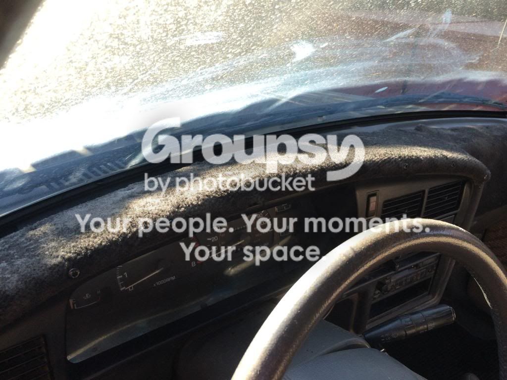

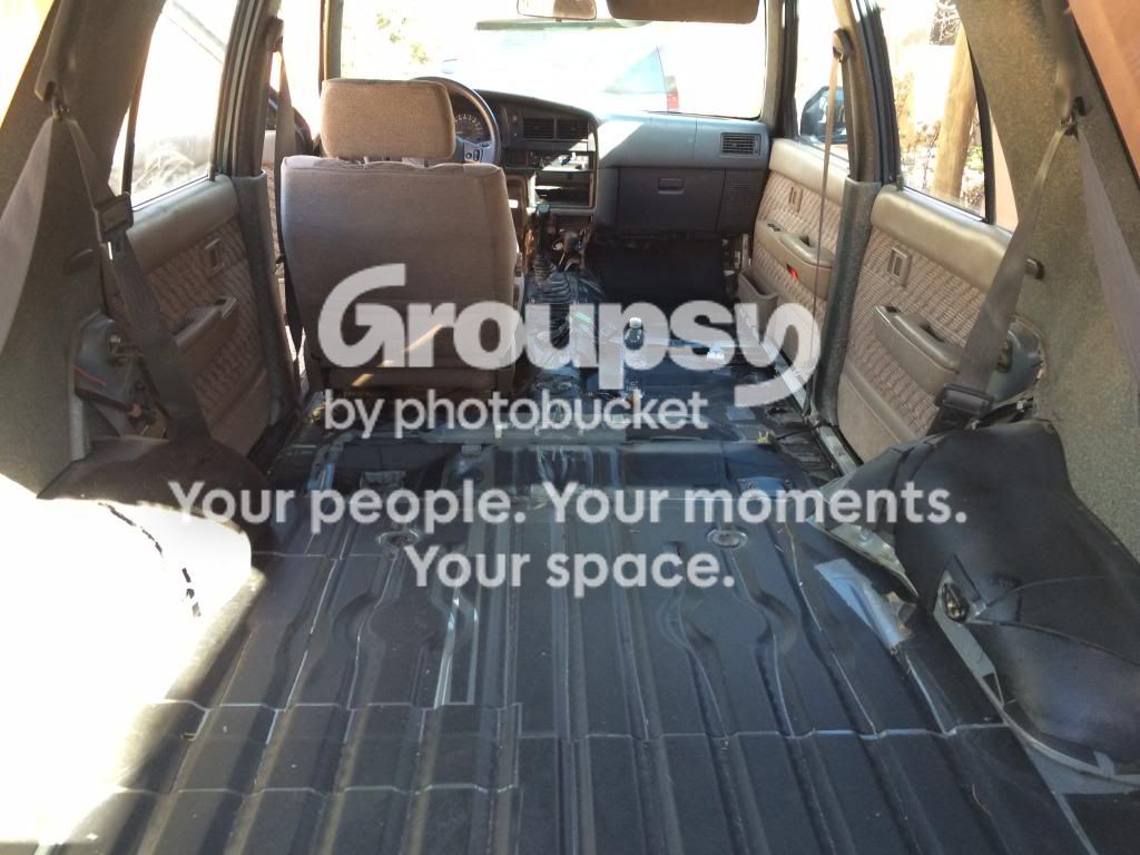

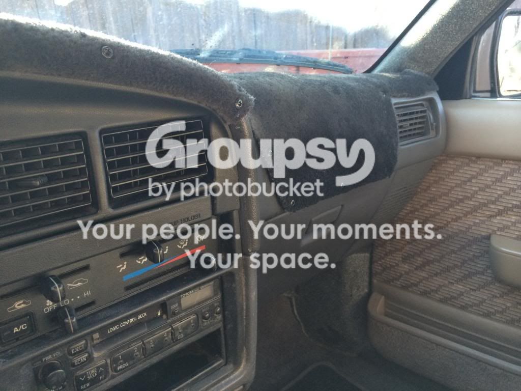

And then onto some interior work. The dash pad was badly cracked, so some carpet dyed black did the job for next to no money. Also added a radio, a double stacked center console, replaced the entire carpeting from a jy 4Runner in better shape, and replaced a bunch of bulbs that were broken. Also replaced the clear plastic in front of the instruments, as mine was very scratched and cloudy.
photo3_zpsa4c922e5.jpg~original
11_zps6276374c.jpg~original
12_zps3693fe5d.jpg~original

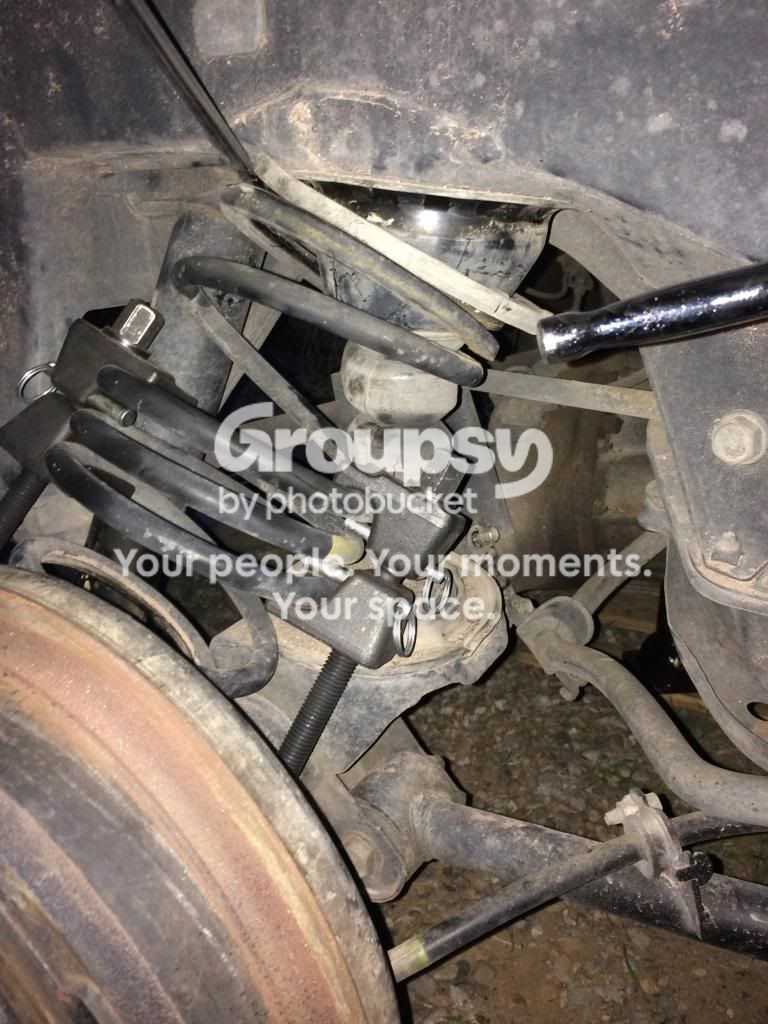

Then some suspension fun. Install pic of 2" coil spacer from Sky Offroading. Coil compressors on loan from ORielly's made relatively light work of this. Took about 5 hours, in the dark, with a headlamp. The most precarious part was making sure the car was supported securely despite me jacking up the differential at all kinds of angles. 3 compressors would probably have made it even easier, as would an impact wrench.

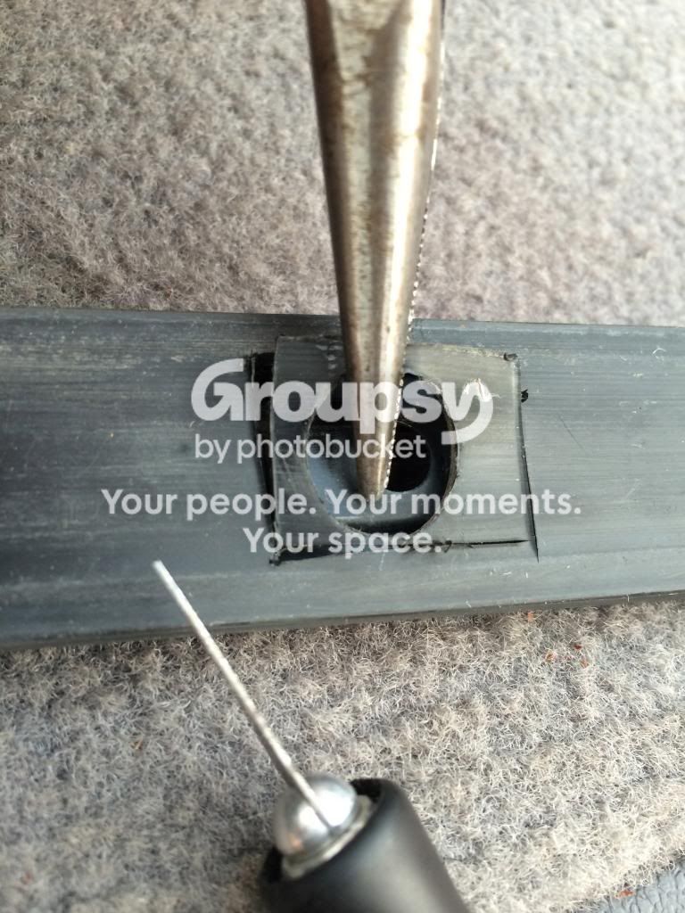

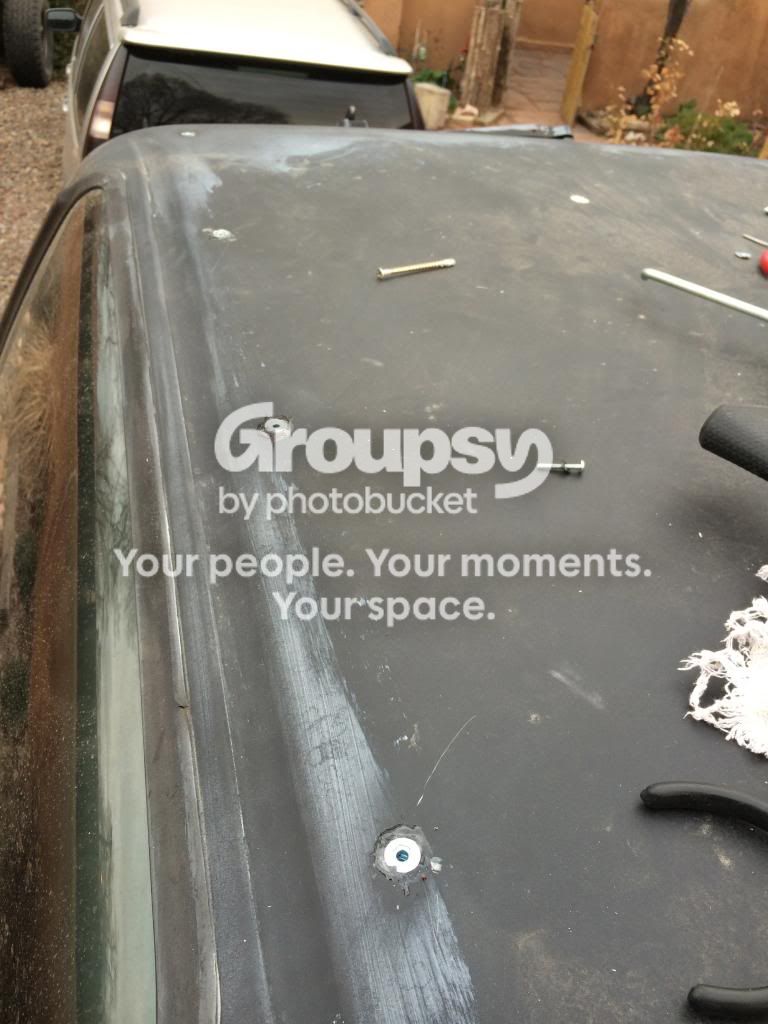

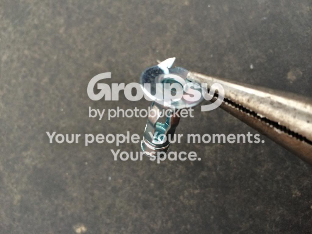

Then today, the roof rack was installed. I can't vouch for the strength or longevity of this yet, but I used toggle bolts from Lowes, designed for drywall.
16_zps3c6bf79c.jpg~original
The two little triangle tabs designed to dig into drywall were removed, to provide some purchase for the next step, epoxying the toggle sheath into the roof. Once dry, the rack was positioned.

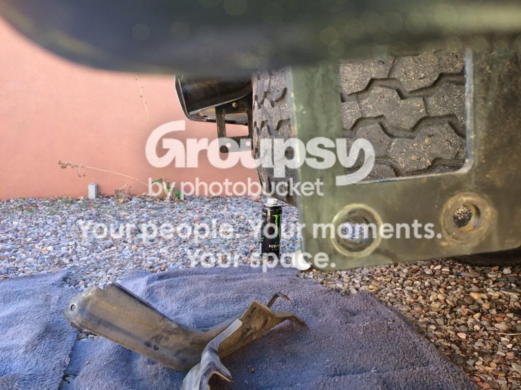

How can I maintain a tow hitch with a 32" spare? The spare is too large- I had to remove the hitch to allow it to fit. Any ideas?
