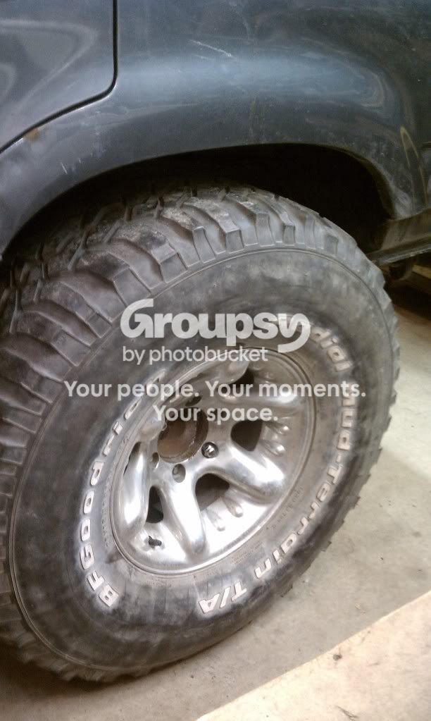

I put a 35" tire on to see how it fits:
35on4runner.jpg~original

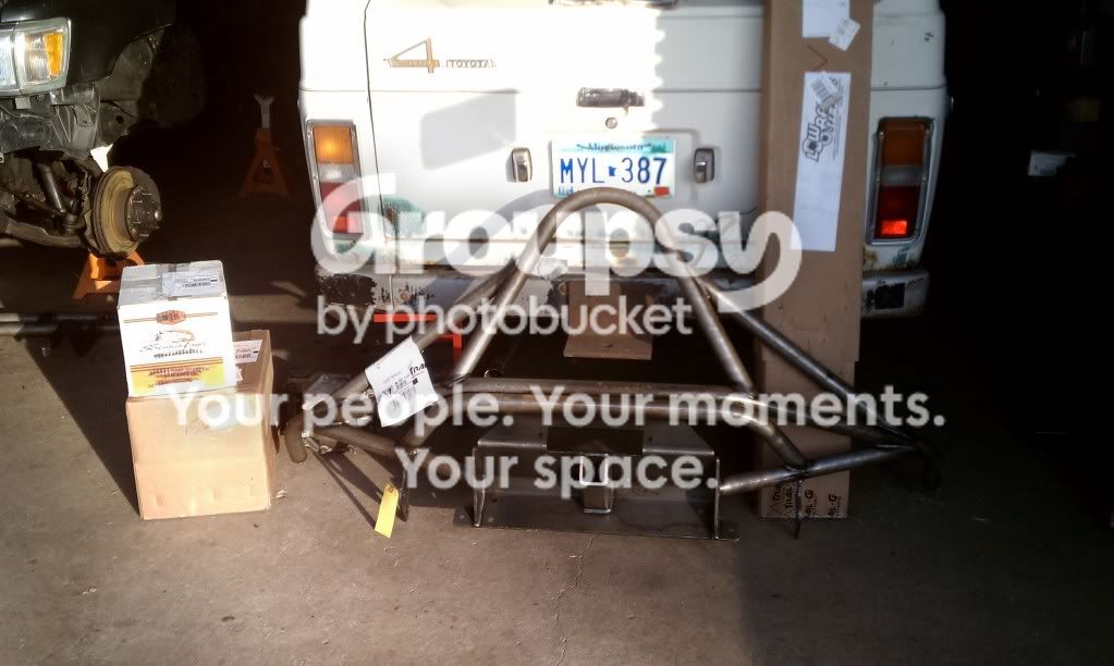

Well this week all the parts showed up and it is going to be a build fest on Sunday!!! I am very exited!!
4runnergoodies.jpg~original
:party:
The Harley box has the carb for the FJ55... the other boxes are the R+P, locker etc. Front bumper, Rocker guards, rear bumper...

So my brother rolled into town on Saturday with 4 35x12.50x15 mud terrain tires for me... Now what do I do? I know I can make the 35's fit but can I wheel them without blowing up CV's all the time? I am open in the front with 5.29:1's so the gearing is alright... Any thoughts or feedback is appreciated...
Got some more work done on the front of the runner. I have the new CV's installed, packed the hub bearings and put 1 of the 35" tires on a rim and put it on the truck to see what I was in for...
It fits well and there would only need to be some slight massaging of the fender and floor board/kick panel. I don't know if the steering is up to the task of turning the bigger tires even though all the parts are brand new. I don't know if the CV's are up to it as well...

It will handle 35's just fine. That used to be the norm quite a few years back. What will really matter is when you turn half way to lock either way and stuff a tire. Will it still clear? I cant see any pictures except for your very first post so it's hard to tell being blind and all.
