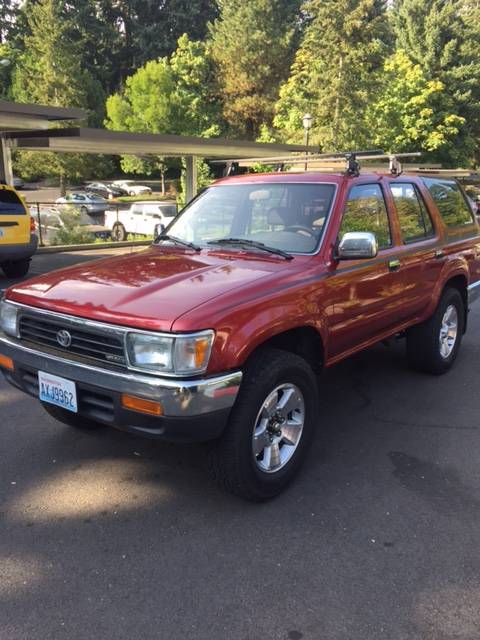

Hey all! I just bought a 1993 4Runner that has a 1KZ-TE Toyota Diesel engine swapped into it. I want to build it into a great daily driver with some off-road/overland capability. Below is my list of work I want to do, but any info is appreciated.

Moog steering parts are good stuff. I just replaced all my steering parts with them and made a world of a difference. As far as seats, I've seen some people use Scion tC seats. Personally I have thick foam under some cheap seat covers and its super comfy. Nicest riding suspension will be Old Man Emu by far. Thats one cool runner you got there, and its a DIESEL! Looking forward on seeing how this comes along.
Thanks man! Should be a fun little truck. I'll be using it to tow my boat a LOT, so I also need to do a little engine work to make it super solid. Definitely need a front mount intercooler to keep things from overheating, and should improve the already good 30-ish MPG!
Nice truck! OME suspension is one of the best out there (unless you go stupid expensive)
A elocker retrofit into the rear would be sweet!
I would stick with all OEM steering and suspension components. I've heard many stories of Moog parts wearing out in a short time (10-30k) whereas the OEM ones last 200k+ miles no problem. Here's an example of some bad ones https://www.youtube.com/watch?v=s8ZVahKc06o
Buy it once and do it right!
I guess diesels are not common in the USA so nice catch! Paint looks really good. The 1KZ is a reliable engine. Just check/change the glow plugs every 100.000km.

The roof rack on it is aftermarket Thule or something clamped on. I'll probably weld up a low-rise rack and bolt it on in the near future.
I'll have to think about the rear tire rack. I might just weld a swing out that attaches to the rear quarter panel, or maybe an entire new rear bumper. We'll see...
